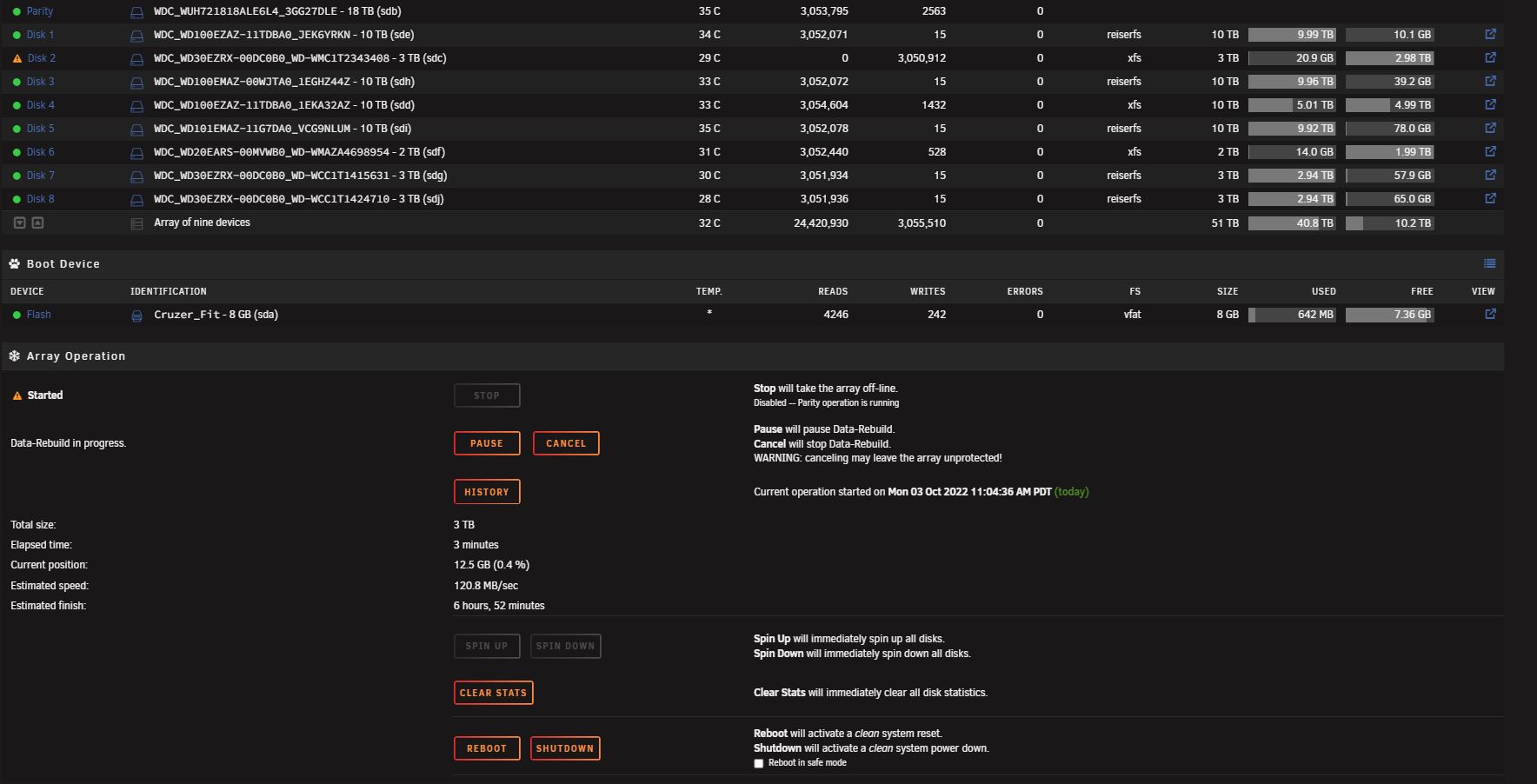

Difficult to follow, at leas for me, what you have done, please post a screenshot of the current array and the diagnostics.
After having shut down, with the 10TB disk still connected (but not detected by Unraid), I connected the 3TB disk again and rebooted. It detected the old 3TB as a new disk and asked to do a data-rebuild. So this is now running. Is this data rebuild necessary knowing that the data from old 3TB disk was formatted to XFS earlier?
