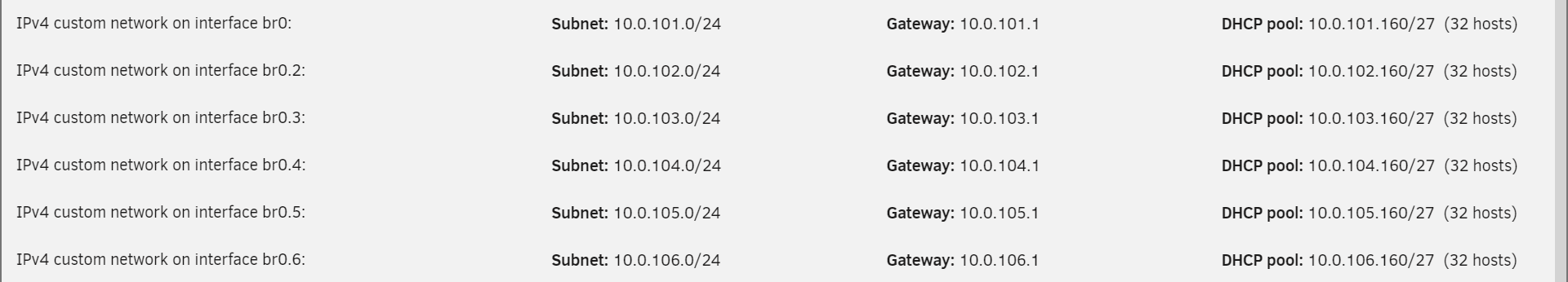

When no explicit gateway address is given for the subnet, then docker will assign the first address as gateway address. This is the conflict you see.
Under docker settings you need to set the specific subnet assignment for each VLAN, see example below
Alright, now it's working. Thank you :)
