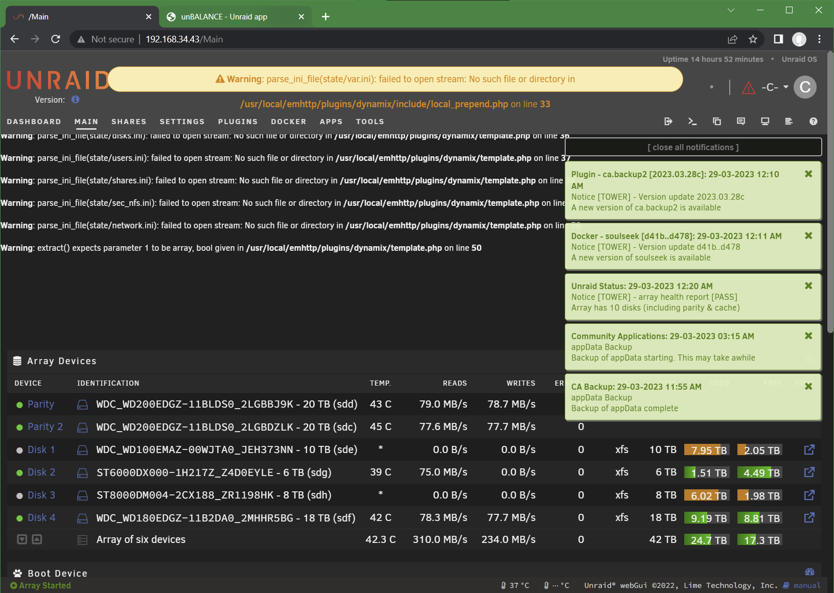

Weird crash, some dynamix error, GUI messed up

I rebooted and errors haven't come back yet.
I wonder if this happens because I moved the USB stick from a motherboard port to a hub.
I moved it back to a direct USB port.
I'll see how it does overnight and report back.

Haven't had this issue since my last report.
I have a failing disk so using Unbalance to move files off it and onto another. All seemed to be going well for the first couple of hours, then this morning when I log into the main GUI I'm seeing this:
Unbalance is still running with over 6 hours to go, so I'm going to leave this until that's finished and will then reboot.
For me this issue has only happened when running rsync from shell or using Unbalance (which uses rsync).
