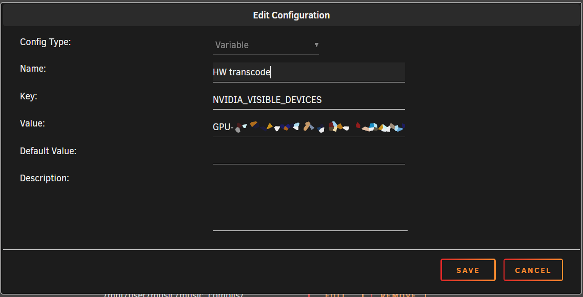

3 hours ago, awediohead said:
there's no longer a section where I can input the UUID of the GPU
Then you should create the variable.
An example from my official Plex, but that should be the same.
Thank you so much - all done and working as it should be.
I don't really understand though why such an important part of the template has to be added. I notice it's not there on the official plex version either.
