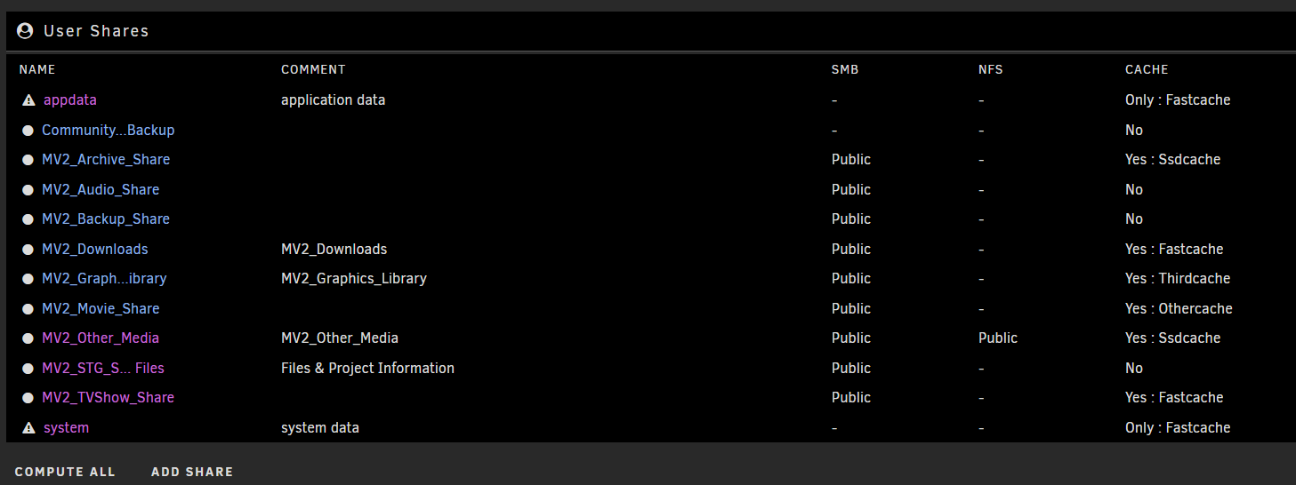

Hard to tell from diagnostics since the share names are anonymized, but there are 2 shares with names that have that same first and last character and are that same length, and they both have contents. I wonder if you don't have 2 shares with the same name but different upper/lower case. Since linux is case-sensitive, these would be different shares to Unraid, but since SMB isn't case-sensitive, only one of these would show up on the network.
Post a screenshot of User Shares page.
I guess MV2_Backup_Share is the other share that looks the same anonymized.
Diagnostics shows MV2_TVShow_Share with files on disks 1,2,3,4
These diagnostics were taken when that share wasn't showing on the User Shares page?
This scrrenshot was taken after  reboot. When the share drops from the network, the TVShow share would not be listed here at all.
