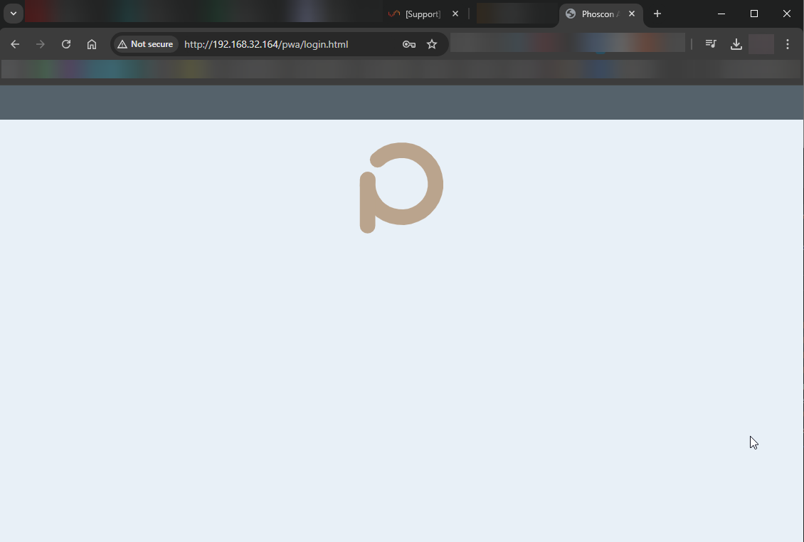

I am having problems after upgrading and wondered if anyone could help.  This is the procedure I followed:
  1. Shut down the old marthoc/deconz container
  2. Started the new deconzcommunity/deconz:stable container
    1. I kept the same appdata path as /mnt/user/appdata/deconz which contained my original database and config from the original container
  3. The page loads, but doesn't show my stick
    1. All the devices react still but I can't see them / add new ones / control the conbee 2 stick.
  4. I have pressed F12 and done a hard reset and cleared cache on Chrome (and tried Edge and Firefox).
  5. I have restarted the container to see if that cures it.

I have the same problem with the "deconzcommunity/deconz:stable" container. I have installed deCONZ on Windows 11 and access to the web interface is possible without any problems. Only via the "deconzcommunity/deconz:stable" container is the access as described by tomwhi. No errors in the log. All devices work without errors.
EDIT: Problem maybe fixed? @tomwhi
If I change the URL from "http://IP/pwa/login.html" to "http://IP/pwa/login2.html#OVERVIEW", access is possible.
Edited by x-dast
Try to clear cache for this IP, I had something similar due to changes in the docker URLs
Yeah agreed - I think the URL had changed and I kept getting redirected to the same (wrong) page over and over.  If I strip back the URL just to http://192.168.32.164/pwa (no login or anything) then it takes me to the right place! 👍
Big thanks for noting and reporting this -  I'm fairly early in my unraid / docker / conbee journey and I couldn't understand why the web-ui was only giving me a blank page.   I had briefly tested the conbee on a raspberry pi before tackling establishing a container on my system for it.   Appending the URL with "/login2.html#OVERVIEW" allowed me to get in and get configuring.
And big thanks to @thecode for creating and supporting this - I thought this would be more of a headache to get working than it has ultimately ended up being!
