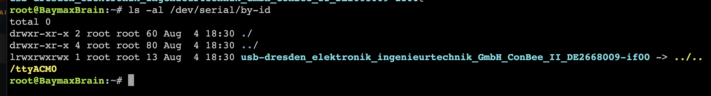

ls /dev/serial/by-id
Copy the id from the result and update the ConBee USB port in the template as follows:
/dev/serial/by-id/usb-dresden_elektronik_ingenieurtechnik_GmbH_ConBee_II_[SN]-if00:/dev/ttyACM0
Replace the "usb-dresden---if00:" with the result from the "ls" command, keep the ":/dev/ttyACM0" even if the device is mapped to a different port. This will map the USB stick to "dev/ttyACM0" even if it is mapped to a different path on the host OS.

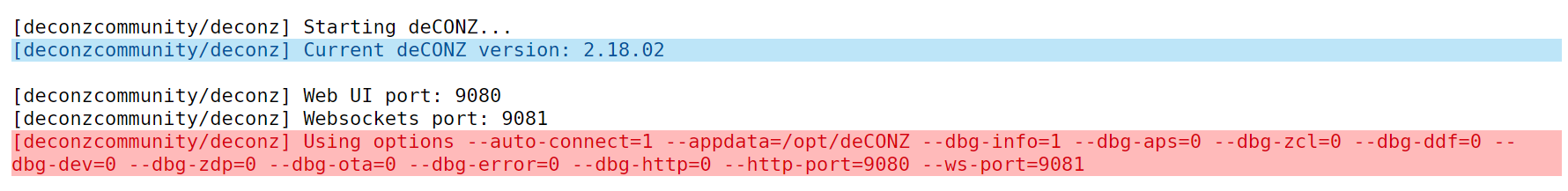

Docker logs shows in RED
[deconzcommunity/deconz] Using options .......... --http-port=808 --ws-port=4434
Same happens if using the custom network to br0. Even if I leave the standard configurations the red line is still showed in the docker logs.
What am I doing wrong?

Unless there is some copy paste error the last line looks strange:
192.168.1.2:80/TCP192.168.1.2:80/opt/deCONZ/mnt/user/appdata/deconz
I have tested again HOST mode for the docker and it does work, the only problem is that if you try to open the WebUI from unRAID it will try to open it on port 80 since it is hardcoded in the template, I will check if it is possible to fix it.
If you open the WebUI using the port you set it should work.
The RED line shows the correct ports that are used, I have moved 80 to 9080 and I can access the WebUI on my server like this:

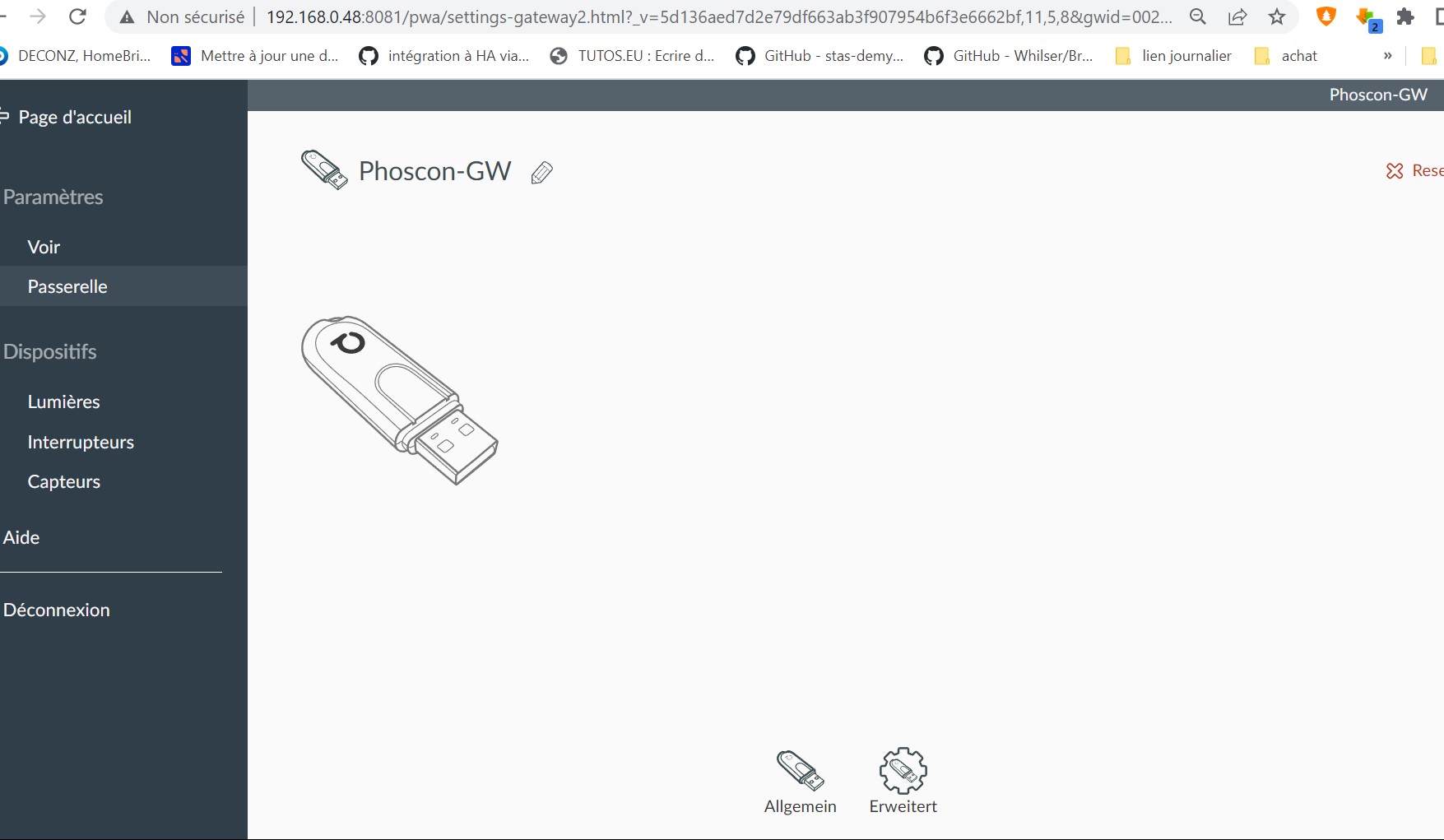

Sorry for the late reply I was busy at work. I tried to setup again using the host mode and changing the port to something else. Maybe he doesn't like 808 XD. Anyway now looks like it's working. I'll do more tests and if anything strange comes up I'll report back.
To solve this just change the view from basic to advanced and modify the value "WebUI: http://[IP]:[PORT:80]/". Change 80 to the port you use..in your example 9080.

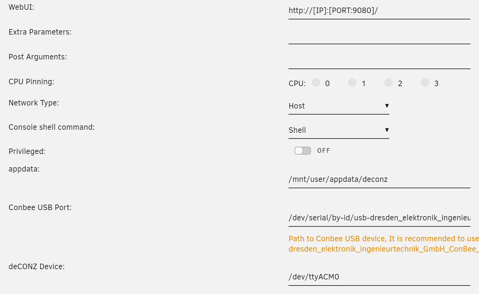

first of all I'd like to thank you for your work!
Unfortunatly I fail to run the network type host. I changed the ports as follows:
After saving it looks like this:
LogFile:
The Web UI doesn't work. Do you have any idea?

This usually happens if there is another app using this port. Can you try to change to a different port and check? what else do you see in the log? I have just tested using host network with port 9080 without issues on my test server.

Where is the mapping for 9080?

Think something doesn't fit from the mount point here
My mount point on Conbee USB Port: /dev/serial/by-id/usb-dresden_elektronik_ingenieurtechnik_GmbH_ConBee_II_DExxxxx22-if00:/dev/ttyACM0
and on deCONZ Device: same
The USB port is correct, however you need to keep the deCONZ device with /dev/ttyACM0

[deconzcommunity/deconz] Using options --auto-connect=1 --appdata=/opt/deCONZ --dbg-info=1 --dbg-aps=0 --dbg-zcl=0 --dbg-ddf=0 --dbg-dev=0 --dbg-zdp=0 --dbg-ota=0 --dbg-error=0 --dbg-http=0 --http-port=80 --ws-port=443
That is not an error, it is just printed in red 🤷‍♂️

hello I'm trying to switch from marthoc/deconz docker. (amd64 2.10.04) with a conbee2 dongle with firmware 26720700, but in fact recognizes it as an unknown hub, and when I connect to the dongle, I don't see its firmware, can you help me? FYI I tested several versions of the new docker nothing to do, I had to reactivate the old one.
for info when I connect to the key it asks me for the password again, like when it is blank, I tried your version 2.12.06, I can see the firmware and my devices, but I can't control anything because in the logs appear errors
I attach the logs and a screenshot,
thanks you
and happy new year

1 hour ago, c4coer said:
i have a solution, i had need driver (section 7 and 8 for me):
https://mariushosting.com/synology-how-to-add-usb-support-on-dsm-7/
it run, key conbee2 has  firmware connect.
lixee (zlinky tic) is connect to deconz, but i no see inside domoticz
Thanks for updating back, I use Home Assistant but if you can reach the Phoscon UI the docker is working. I would try getting help in Domoticz forums

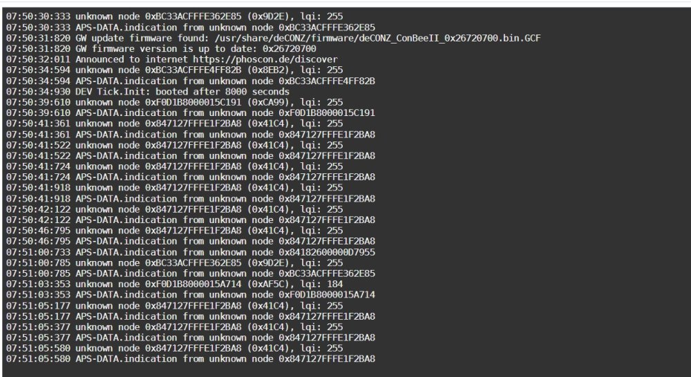

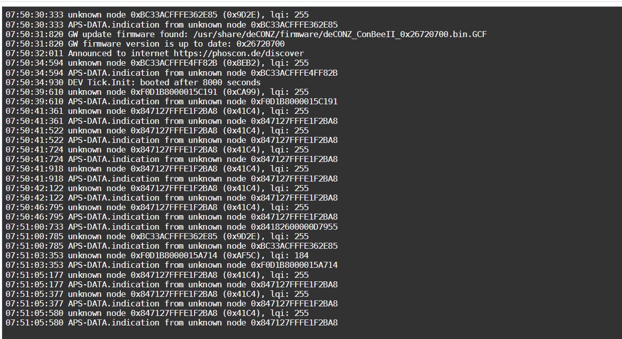

Hi all,
After swapping my cache-drive for a larger one, I did reinstall of the Deconz container from "old apps" and restored appdata-folder from my backup. After this I've lost control over all my zigbee devices.
Checking the logs there's lots of "error ASSPDE-DATA.confirm: 0xE1 on task".
I've also noted that in the container, "DECONZ_DEVICE" is set to "0", but in the config screen it says "set same as device", which for me is /dev/ttyACM0. Is this expected?
It seems to find the USB-device, because it confirms that the firmware is up to date.
On 2/25/2023 at 9:56 AM, SimonF said:
Have you installed
Indeed I have not. Sir you are great, as is this community as usual. Installed the patch and now I can update my container again. Cheers!

Unfortunately, i can't get Conbee II working with  Deconz Community. I've tried all tweeks and tips i've found, but Deconz still is not ale to find any devices.  Stick ist connected and recognized successfully, but when searching for new devices nothing is found. Is there anything  I miss or can try to do?
when trying the Conbee II in HA as VM it's found, but can't be initialized.
Start by posting the output from:
Conbee USB Port is set to :/dev/serial/by-id/usb-dresden_elektronik_ingenieurtechnik_GmbH_ConBee_II_DE2668009-if00:/dev/ttyACM0
201556499_Bildschirmfoto2023-08-06um21_04_21.thumb.png.f6dbee23255e7c3b995bd6bc0c42b473.png
2132526979_Bildschirmfoto2023-08-06um21_07_33.thumb.png.ed9efe537436c18b39e87bb08c1d68d7.png
