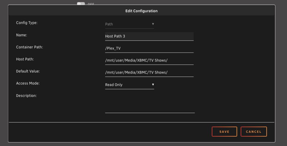

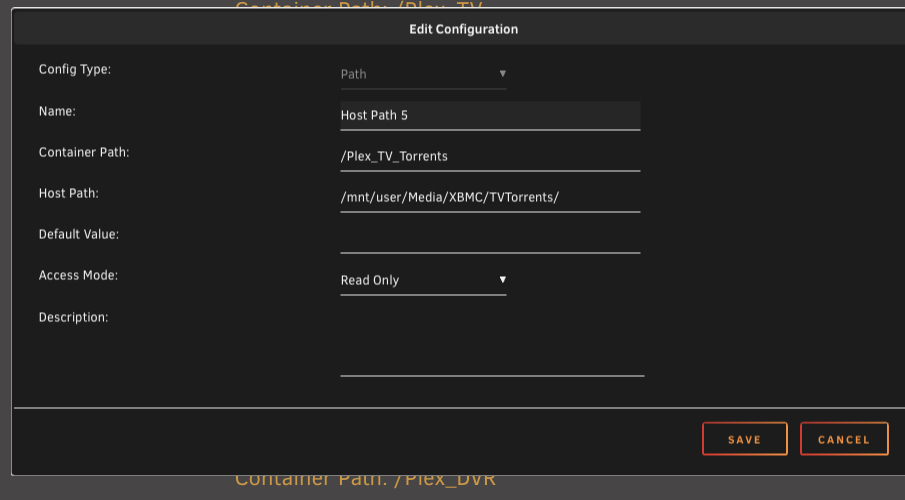

September 22, 20224 yr Here are a couple of examples. For each of these I added a library folder in the Plex settings (Plex_TV_Torrents for example) and identified it as TV Shows. Added the paths you see in the examples into the docker container.

September 22, 20224 yr Community Expert 17 minutes ago, deltaexray said: I want my larger media (Movies, TV Shows etc.) on the HDD array and my smaller ones (music and photos) on a secondary, non cache, ssd pool. Separate user shares. Larger media in shares that don't use cache, smaller media in shares that are cache-only. Plex doesn't know where these are, just what their container paths are. And plex docker doesn't need to know which disk these are on, just the host path to each user share. For example Movies share set to cache:no, host path is /mnt/user/Movies, files won't be on cache. * music share set to cache:only, host path is /mnt/user/music, files will all be on cache. * The container doesn't need to know what disks they are using, and the application itself can't know anything about disks anyway. *Note that simply setting the user shares this way won't have any effect on where already existing files are stored. If any shares you want cache:only have files on the array, you will have to move them, etc. Let us know if you need help with that.
