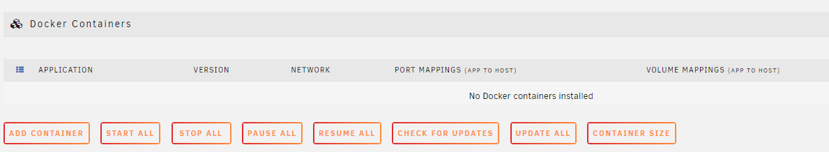

Good Morning,

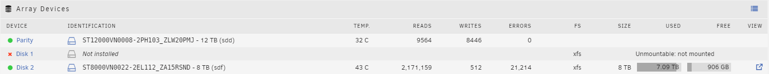

I recently discovered that I had a disk that is listed as Not Installed.  I have experienced a couple power outages in the last couple of months, not sure if they are related or not.  I am also seeing a ton of smart errors and what appear to be critical read errors on another disk.  I rebooted and placed the array into maintenance mode and performed S.M.A.R.T. test on the disk with all the errors and started a Read Check of all the drives but ended up stopping it after a few hours as it was only at around 34% and not progressing beyond the disk with all the S.M.A.R.T. and read errors.  I'm no longer seeing the docker apps I was running either and before the reboot I was seeing an error that the Docker service was not running.  After the reboot I don't see the error and the apps are missing.
I'm only configured with a single parity drive so I'm obviously concerned about data loss.  I've got 2 new drives arriving tomorrow, but wanted to see if I could get some advice on the plan of attack to hopefully get restored to where I was before.  Should I replace the 2 drives before upgrading the OS or should I get the array stabilized beforehand?  Do I need to upgrade to a specific version from the RC or can I jump straight to 6.10.2?  Also, is there any possibility of recovering the docker apps or, at a minimum, the configuration of said apps?
Thank you for your time and advice,
Mike

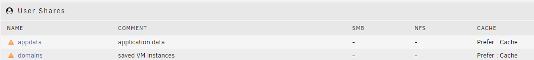

You don't seem to have a pool named cache, but some of your user shares are configured to use that pool. In particular, appdata, domains, system are configured to prefer a pool named cache, and since it doesn't exist, all those shares have been created on the array. Possibly this is what has led up to your docker problems.
Anything you can tell us about that?

No SMART report for any disk that might have been assigned as disk1, might have been 8GB serial ending FYZV device sde but isn't in SMART reports now.
You didn't say which disk that was. Which disk was it? Do any of your other disks have SMART warnings on the Dashboard page?
Which disks? Maybe it could be figured out from diagnostics but why make us work so hard?
Looks like only disk1 is disabled, but it is also unmountable, so we will have to repair its filesystem before rebuilding it.
My apologies, I am referring to the disk ending in 5RSND.  Yes, both the Disk 2 ending in 5RSND and Disk 3 ending in 4MPD6
Disk 2 ending in 5RSND.  It's SMART Overall Health is listed as failed

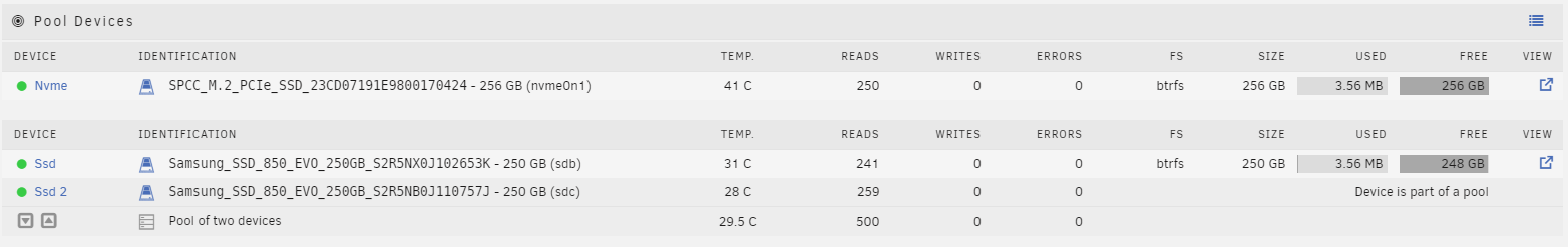

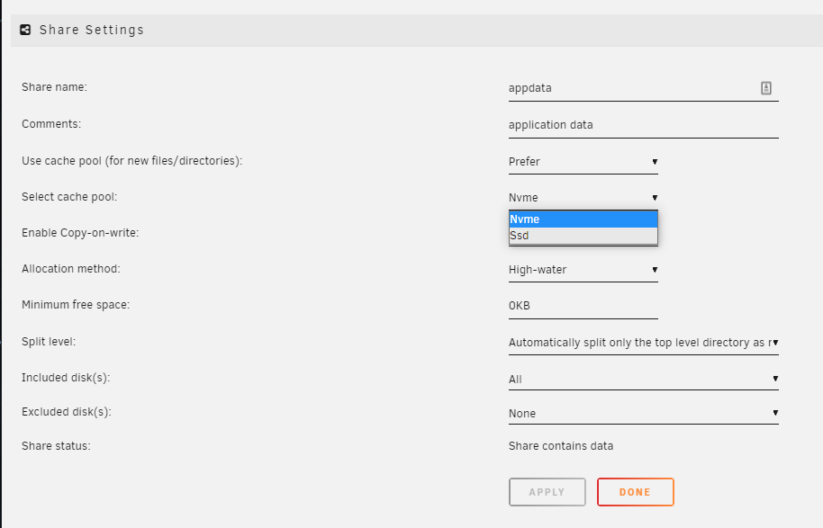

See the attached screenshots of the pool devices I have installed.  I guess I did not have them configured properly for use by any of the shares

Disk2 is failing as you mention. Disk3 looks OK for now, just 1 Reported Incorrect, and we are going to need it for getting other disks going again.
Still doesn't solve the mystery of missing disk1. Do you still have the disk? Is it still attached?
On 9/24/2022 at 1:46 PM, evans.family.mike said:
would that be done from the Check Filesystem Status button while in Maintenance Mode?
Correct. But...
SInce disk2 is really failing, that might be a reason disk1 emulation isn't working well. And disk2 failure would also make it difficult or impossible to rebuild disk1. I think we are going to have to accept disk1 back into the array if you still have it and it still works, so we can try to rebuild disk2 instead. That is a little more complicated and not really documented in the wiki though there are quite a few threads where we have guided users through the process.

Nothing can move open files. To get those shares moved, you will have to disable Docker and VM Manager in Settings. But let's wait on trying to move anything until your array is stable again. In fact, go ahead and disable Docker and VM Manager in Settings until your array is stable.

Docker service has been disabled.  VM Manager wasn't running.

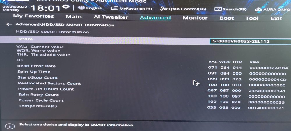

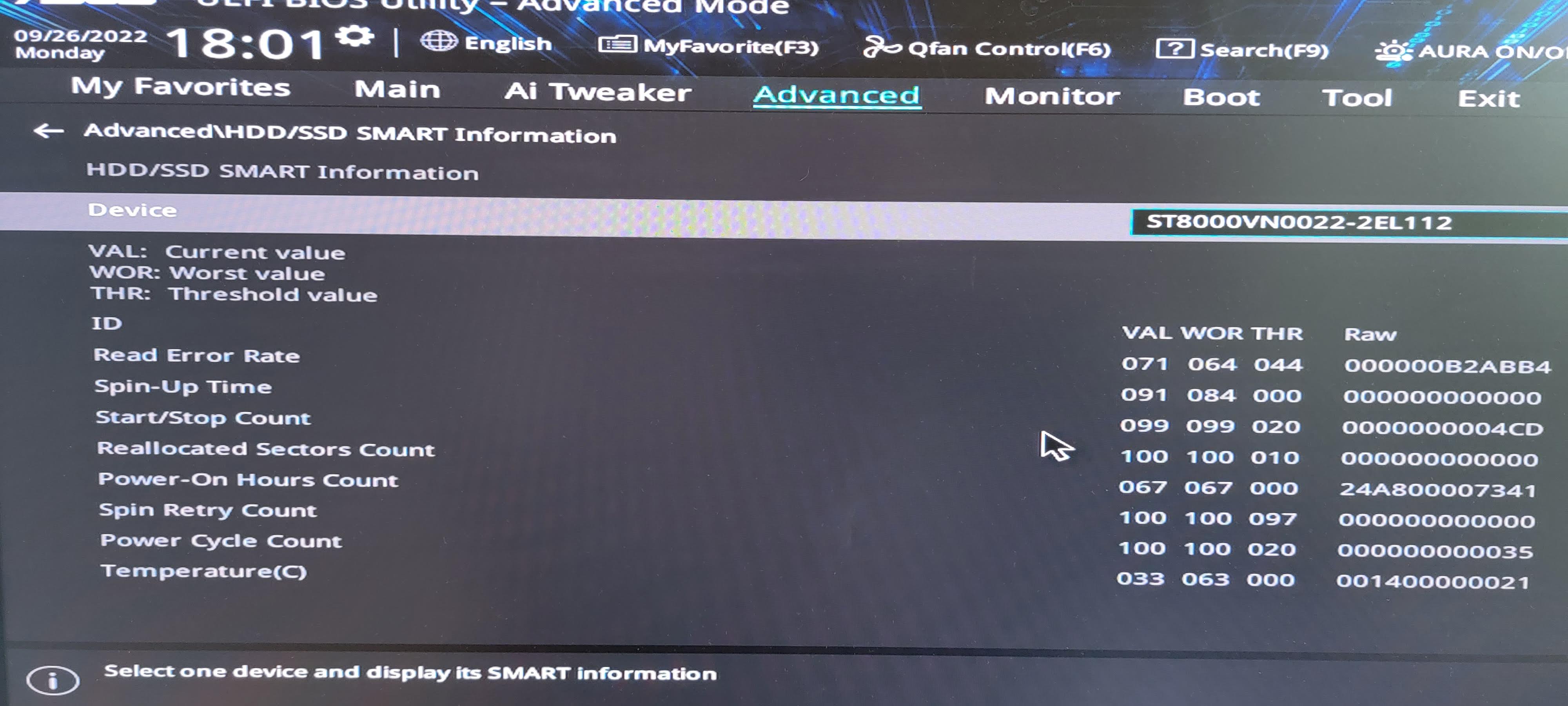

In order to rebuild failed disk2 we need disk1 to be working. Don't reassign it to the array we just need to see its SMART report.
Was this disk1?
Can you see the disk in BIOS?
Have they arrived? At least 8TB (size of disk1 or disk2) but no larger than 12TB (size of parity).
If disk2 weren't already failing, and all you had was disabled / emulated-but-unmountable disk1, then we would repair filesystem on emulated disk1, rebuild disk1 to a spare, keep original disk1 as is in case of problems.
But I'm concerned that disk2 might fail so badly that we would be in danger of losing disk2 data while we tried to recover disk1 data.
If disk1 SMART is OK probably its data is mostly OK, so it might be OK to not try to rebuild it but accept it back into the array and instead rebuild disk2 to a new disk.
I'm going to see if we can get storage expert @JorgeB to give us a 2nd opinion.
My apologies for the delayed response.
I couldn't see the disk in the BIOS initially after a reboot.  I powered off the server and performed a visible inspection to make sure cabling looked ok and then powered it back on.  This time I was able to see it in the BIOS.  It now shows up in UNRAID and is unassigned
The 2 new 12TB disks have arrived
Agree, lets see a SMART report for disk1.
Other than have been run too hot in the past it looks OK, lots of UDMA CRC errors so the SATA cable should be replaced, unless they are old.
