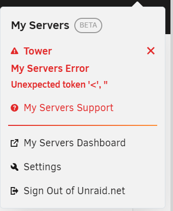

My server Error Unexpected token '<'
Please ensure you have the latest version of the plugin installed.
Via your server webGUI go to the Plugins page. For "My Servers" you should see version 2022.09.28.1258
If you've confirmed you're on the latest version, please provide the following details

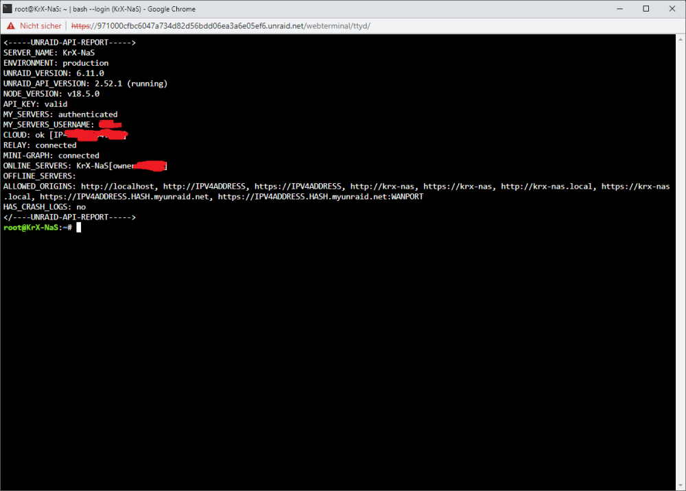

Hi, i got the same Problem. For some reason the WAN Port was switched back to 443 after upgrading. i changed it back, now the CHECK does not fail anymore.
but still the same problem as above.
Here is my diagnostic and output of that command:
krx-nas-diagnostics-20221003-2239.zip

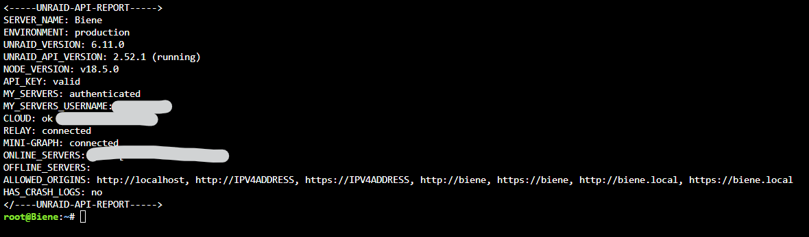

Hi everybody,
I have the same issue...
.. and my diagnostic output:
And as above, I have the same error message displayed.

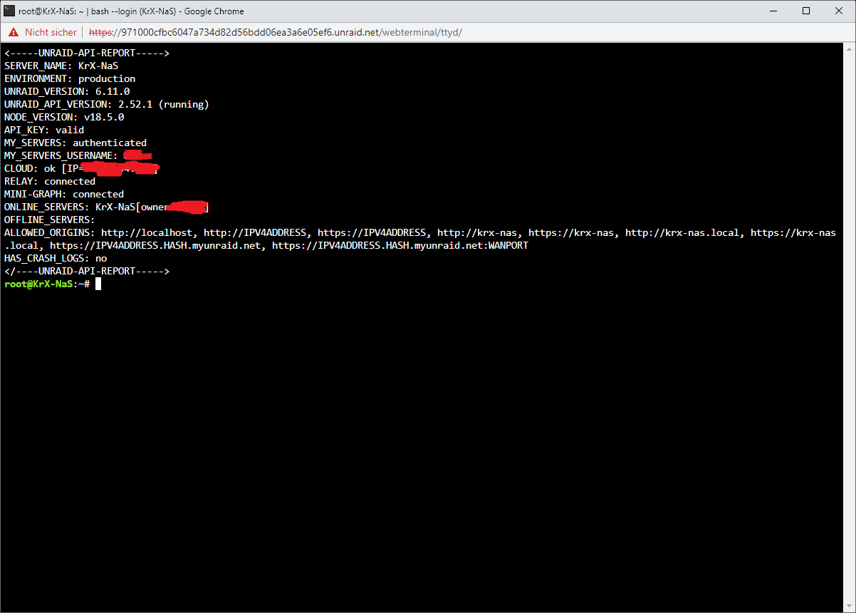

Hi @KrX @OlejoHome @Bebbo,
This sounds like a CORS error, are you using a reverse proxy? Those are not currently supported.
If you look at the ALLOWED_ORIGINS area of the `unraid-api report -v` command that you ran it will show you the list of URLs that the system will accept. Only URLs listed there will work with My Servers.
