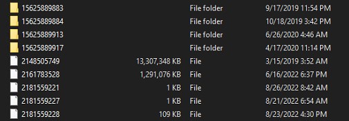

The Lost+Found folder contains folders and files with random numbers.
The folders contain my files with the original naming with the correct file extension ✔️. The files are just renamed to numbers with no extension ❌.
I don't have 1:1 backup for all the files, as most of them are available online. I've backups for some personal folders.
