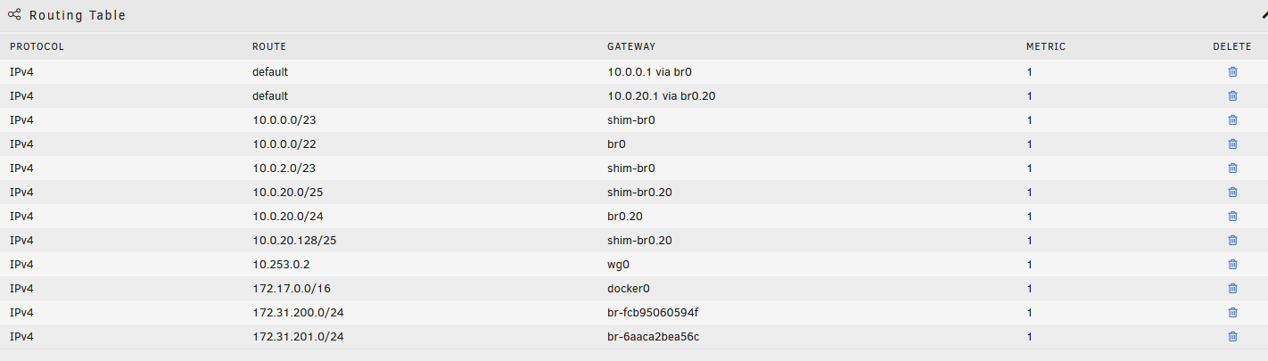

October 14, 20224 yr When I enable docker, the various lans get split up with shims to cover the addressable space. So in the attached picture you can see that my 10.0.0.0/22 main network has two shim-br0 to cover the addressable space: 10.0.0.0/23 10.0.2.0/23 Same for the IOT VLAN 10.0.20.0/24 which has two shim-br0.20 10.0.20.0/25 10.0.20.128/125 And then there are two entries at the bottom which I have no idea what they are for, but look like they are splitting apart the docker network: 172.17.0.0/16 docker0 172.31.200.0/24 br-fcb95060594f 172.31.201.0/24 br-6aaca2bea56c
January 19, 20233 yr I had a similar entry, looks like this is an orphan Docker adapter that is no longer used. route -n Kernel IP routing table Destination Gateway Genmask Flags Metric Ref Use Iface 0.0.0.0 192.168.178.1 0.0.0.0 UG 1004 0 0 br0 10.253.0.2 0.0.0.0 255.255.255.255 UH 0 0 0 wg0 172.31.200.0 0.0.0.0 255.255.255.0 U 0 0 0 br-af3bd9cc0c24 192.168.122.0 0.0.0.0 255.255.255.0 U 0 0 0 virbr0 192.168.178.0 0.0.0.0 255.255.255.0 U 1004 0 0 br0 I found this with the following command docker network ls NETWORK ID NAME DRIVER SCOPE 9c73f7ae825c br0 macvlan local 42c79c489b86 bridge bridge local e86908c40902 host host local ce3ed75d3fe3 none null local af3bd9cc0c24 wg0 bridge local Then I deleted it with the command: docker network prune WARNING! This will remove all custom networks not used by at least one container. Are you sure you want to continue? [y/N] y Deleted Networks: wg0 br0 Even after a restart, this is no longer displayed and Docker is running. route -n Kernel IP routing table Destination Gateway Genmask Flags Metric Ref Use Iface 0.0.0.0 192.168.178.1 0.0.0.0 UG 1004 0 0 br0 10.253.0.2 0.0.0.0 255.255.255.255 UH 0 0 0 wg0 172.17.0.0 0.0.0.0 255.255.0.0 U 0 0 0 docker0 192.168.122.0 0.0.0.0 255.255.255.0 U 0 0 0 virbr0 192.168.178.0 0.0.0.0 255.255.255.0 U 1004 0 0 br0
