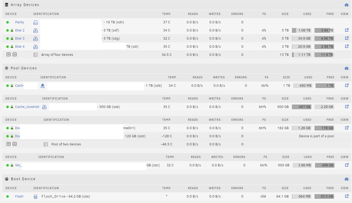

I started my trial of Unraid and I just cannot get this thing working. Set up a few shares, using SSD and a HDD cache depending on what I want to happen.
Havent tested the SSD's yet, but the mover just refuses to move from the HDD cache. Share settings are Yes, not prefer. Tried Mover Tuning plugin, still didnt work. Deleted that, still doesnt work. Cache is completely full right now and getting errors and this in the log file when I manually click move.
Ive had to delete everyhting a few times trying to set it up again in case I made a wrong error. Tired of running day and a half long parity checks every time I wipe the server...

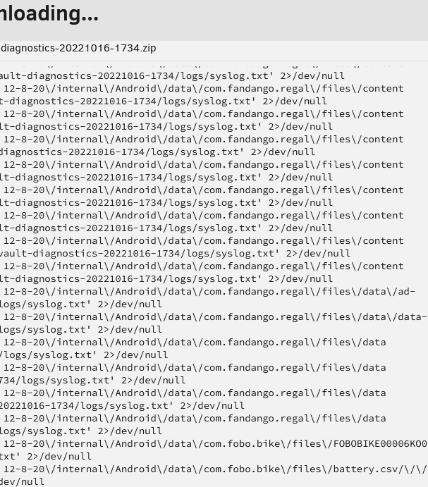

I tried creating a diagnostic log file under tools, but it was taking forever and looked like it was logging every file I had, not something I want to share. Unless it just looks like its logging every single music folder, looking for .cfg's? Can I turn that part off?

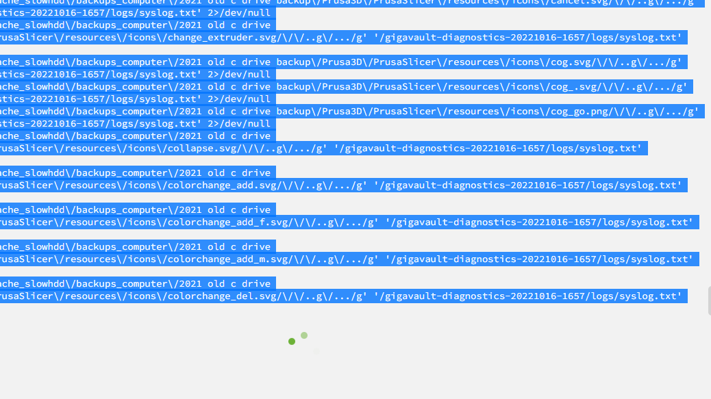

Here are the files it posts, every single one in my shares lol. Dont know why it needs to look at my PrusaSlicer folders :)

This is what happenes every time I try to take a diagnostic. 32GB ram.... On Unraid and main comp both.. ;/
Tried using firefox instead of chrome, came back and took this partway through.... (The only tab open is the diagnostics running)
And its still looking at every file and folder I have saved... Now its scanning my android phone backup saves. Needs to know I use Fandango and Fobo Bike tire pressure monitoring apps :)

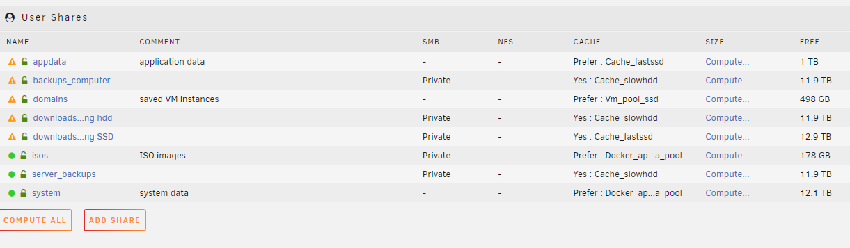

Post a screenshot of User Shares

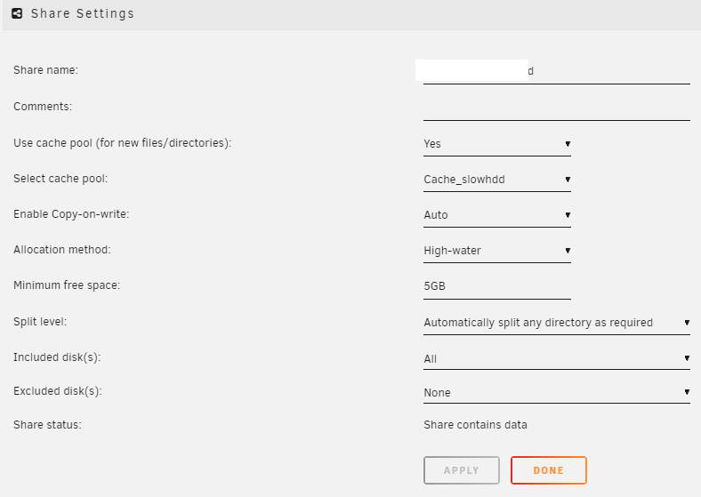

Any shares created in this way will have default settings until you change them. One of those defaults is cache:no, and cache:no shares are ignored by mover.

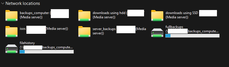

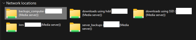

Heres all my network drives. I was following youtube tutorials that said I have to map em ;/
Needed the drives themselves so I could use Windows backups. Everything else I use the folders for, one for each share.
Do you think using Windows writing to network drives is the reason its all messed up?

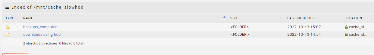

Heres the folder structure inside the cache drive thats not working:

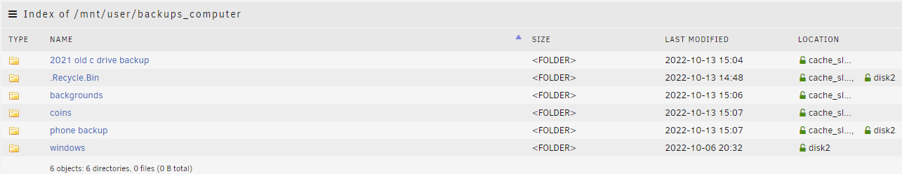

Heres the index for the backups share:

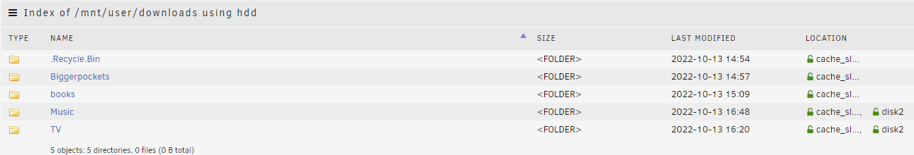

And the index for the downloads share using the HDD:
Is the fact that the top one doesnt have /user/ the issue?
Don't know why Windows would require actual drive on a remote computer. Any network share can be mapped to a drive on the Windows PC. I personally never bother with mapping drives since most software can browse the network without needing to specify a mapped drive.
19 hours ago, trurl said:
I recommend not sharing disks on the network and only working with user shares
It is even possible to lose data by working with disks and user shares at the same time when moving or copying.
Mover won't move files at the top level of a drive, it only works on user shares, which are top level folders.
What do you get from the command line with this?
ls /mnt/cache_slowhdd

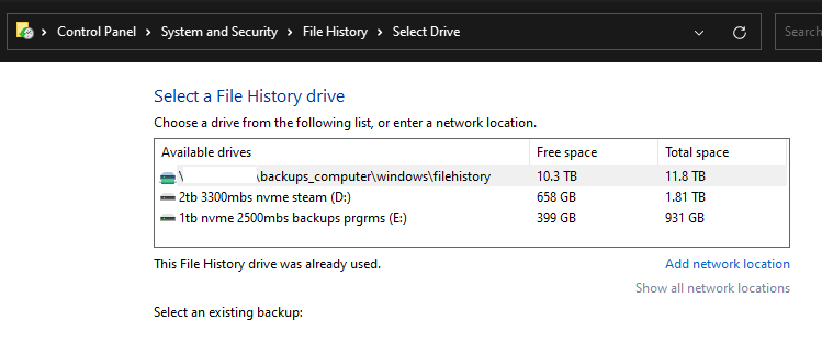

Its been a week now so I don't remember which video. But I am using File History, which I guess is from windows 7 but is still in current windows. I've set every share to only be accessible via a user, so isn't it already using user shares? Tried adding a regular network location after deleting my shared drives. Still appears to work, and also still appears to show drive icon within File History.
You can see all of your user shares on the User Shares page in the Unraid webUI.
