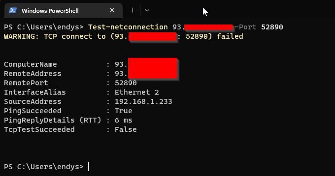

  • I've also tried to do Test-NetConnection on the port from PowerShell, ping works but TCP Test fails anyway

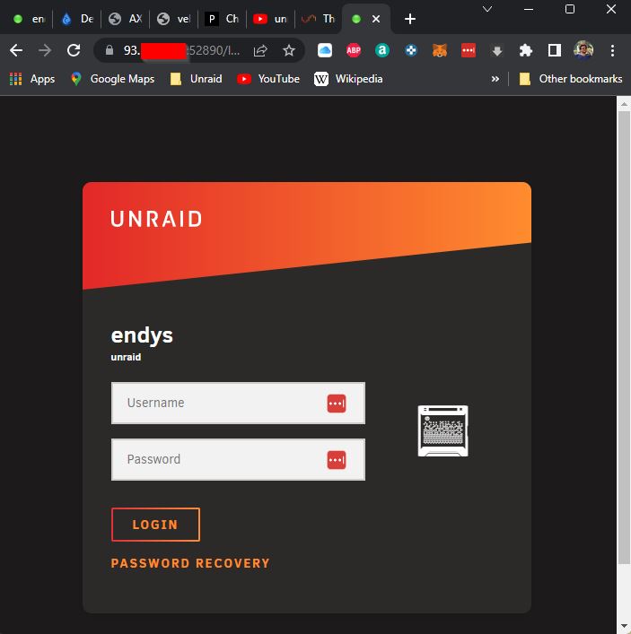

my ISP activated me the public IP, if I try both from my smartphone (after disabling wifi) and from my PC to enter via web browser into my Unraid, it works...

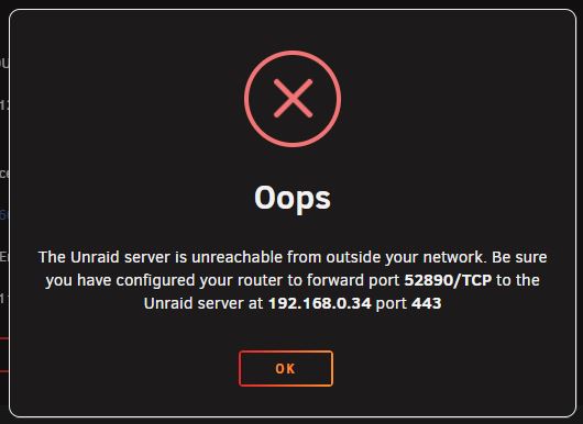

But I don't know why, when I do the test from Unraid it says that the server is not reachable from the internet.

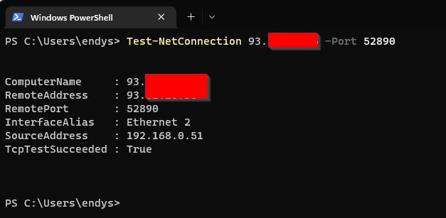

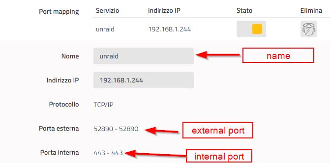

I tried to also test the connection and everything seems to be fine: the NAT forwarding works as expected forwarding the traffic from external port 52890 to internal port 443 on Unraid's IP.
If I try from the web browser, everything seems to be fine too.

2) Why unraid under settings is telling me that my server cannot be reached from the internet when I can enter into it from https://mypublicip:52890?
