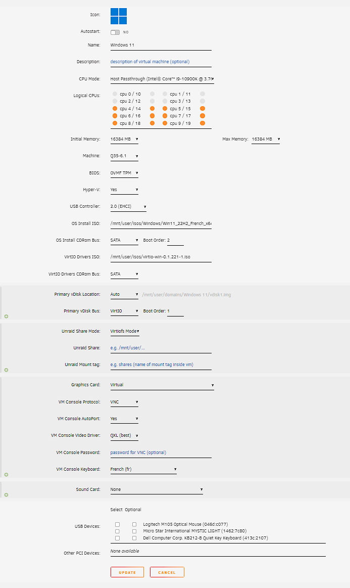

I'm a  new user of Unraid. I've have installed new server and created a VM with Windows 11. I have followed SpaceinvadersOne tutorial to do this.

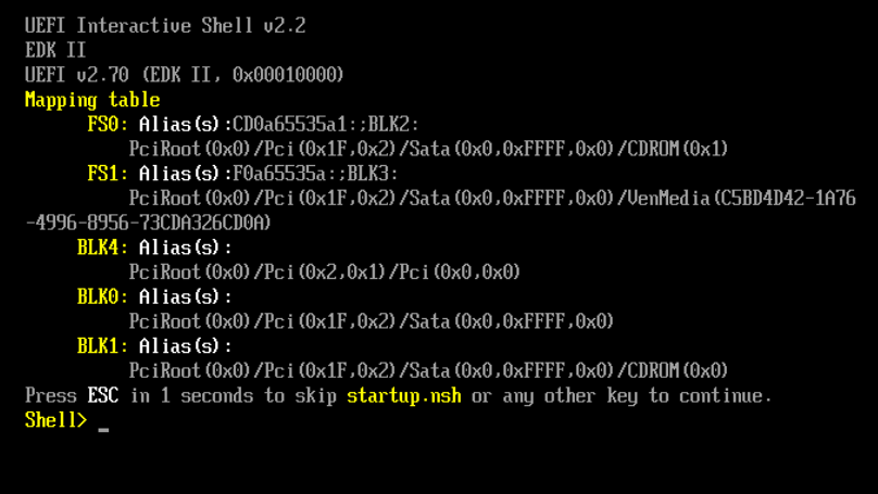

I have a problem. My VM starts but it does not boot at all. Under VNC i can't see the boot screen (VNC screen attached) and on Unraid it seems no IP is affected to my VM.

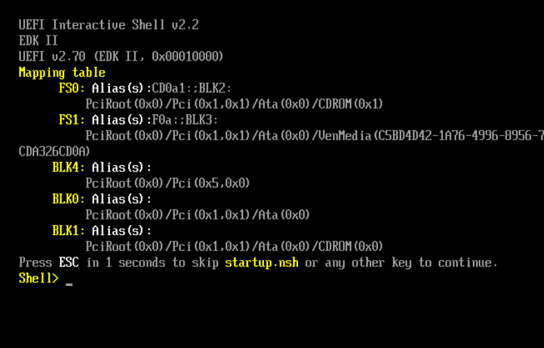

I created a new VM with Windows 11 with TPM avec i440fx. It displays on VNC  "press any key to boot" then no time to press that it jumps to this screen attached.
Enter:
reset
in this shell and it should reboot the VM.

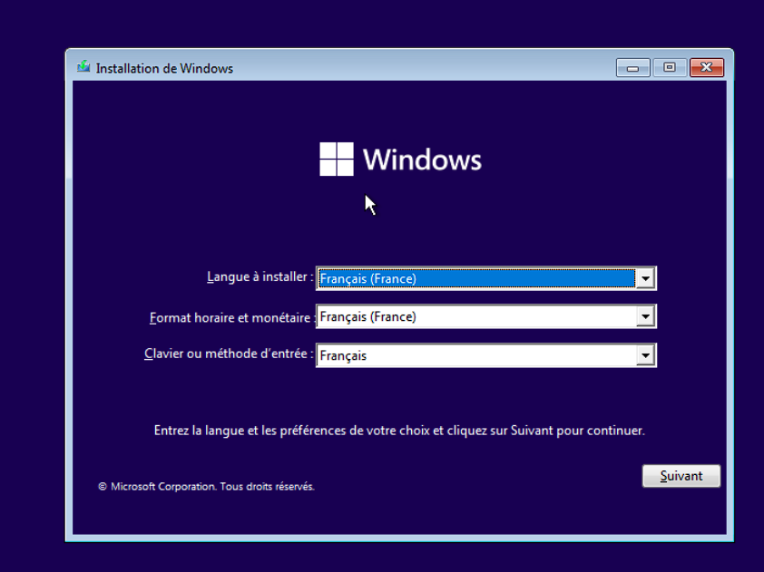

it works !!
Last question : how do i enable the network so that it is accessible on the VM. I'm stucked on the installation process as Windows is expecting a network connection ....
Continue reading, Bypass 1 option works for current release.
Thanks JorgeB, it worked !

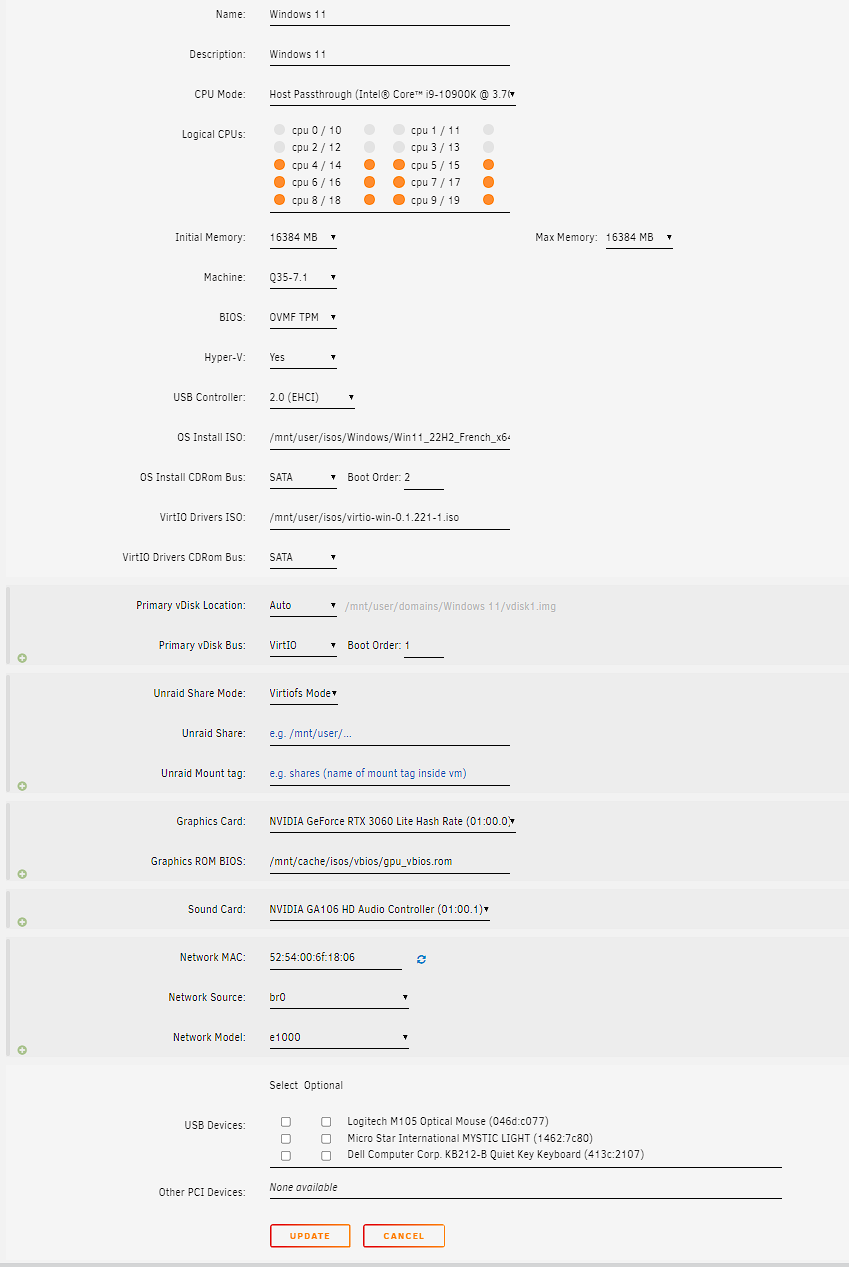

Shouldn't it be also possible to select the "e1000" driver in the VM settings to have active Internet connection?
Most likely, but never tested.

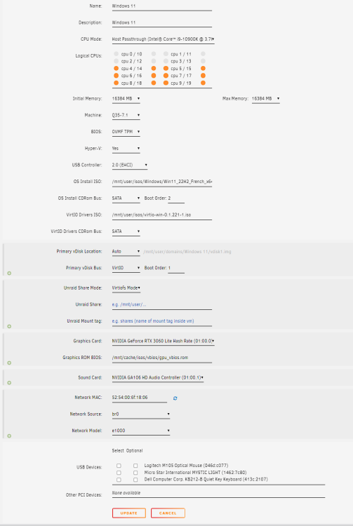

I tried selecting "e1000" driver and i confirm it works, i have internet on the installation process.

Just progressing i'm almost done. Installed Windows 11, access with VNC on virtual GC perfect.
Then i tried to passthgrough my graphic card making changes to the setting. I boot with no problem but VM stucked at half of drivers Nvidia installation with a beautiful message :
qemu-system-x86_64: vfio_region_write(0000:01:00.0:region1+0x34190, 0x0,1) failed: Device or resource busy
It seems the graphic card is already used by the host OS i think but how could i solve this problem ?
The graphic card and sound are correctly bind to VFIO.
However when on my Windows VM i install the Nvidia drivers, he says he does not find any compatible graphic card so he refuses to install the drivers. I have checked the peripheral list and the graphics card NVIDIA RTX 3060 is not in the list.
