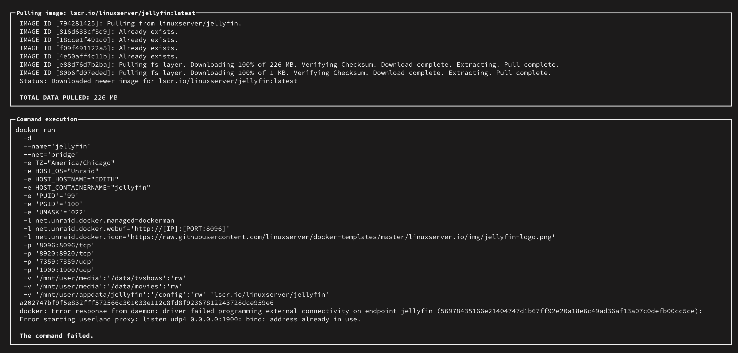

I am trying to install Jellyfin, but it wants to use port 1900. There seems to be a conflict with python3. I do not have python3 on my system as I ran `which python3` and there isn't a service installed.
Here is the error message

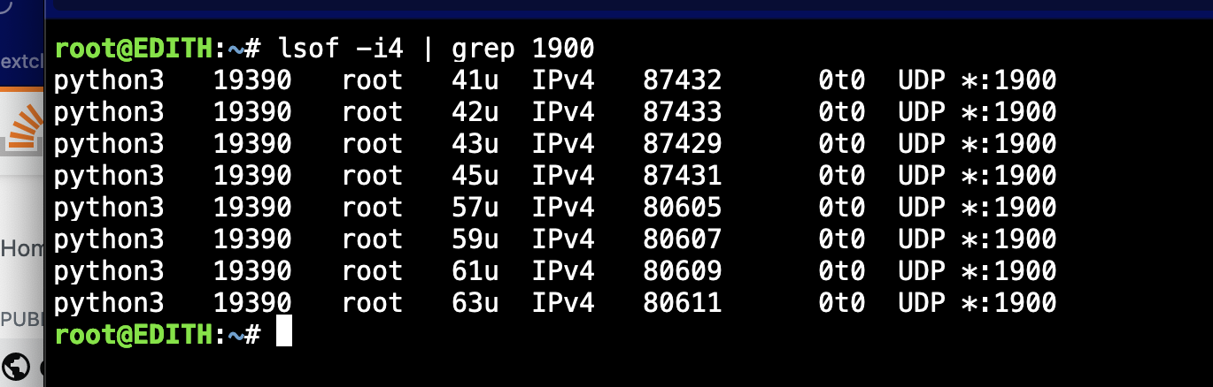

Here is the service that is using port 1900

So i had nerd tools running, but I deleted the plugin and restarted the server. Now I still have python3 running. However, when I enter `python3` into the terminal I can't get it to run so maybe some other service is using python3? I ran `top | grep PROCESS_ID` where PROCESS_ID is the ID that i got when i ran `lsof -i4 | grep 1900` and i get that it is running which is weird. I am unsure where else to look

@Bcy and @Kilrah just figured it out. I killed the process so that I could work backwards and figured out home assistant is what runs on that port... I got an immediate notification that it was shutting down lol
