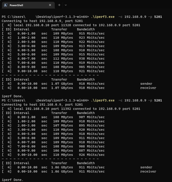

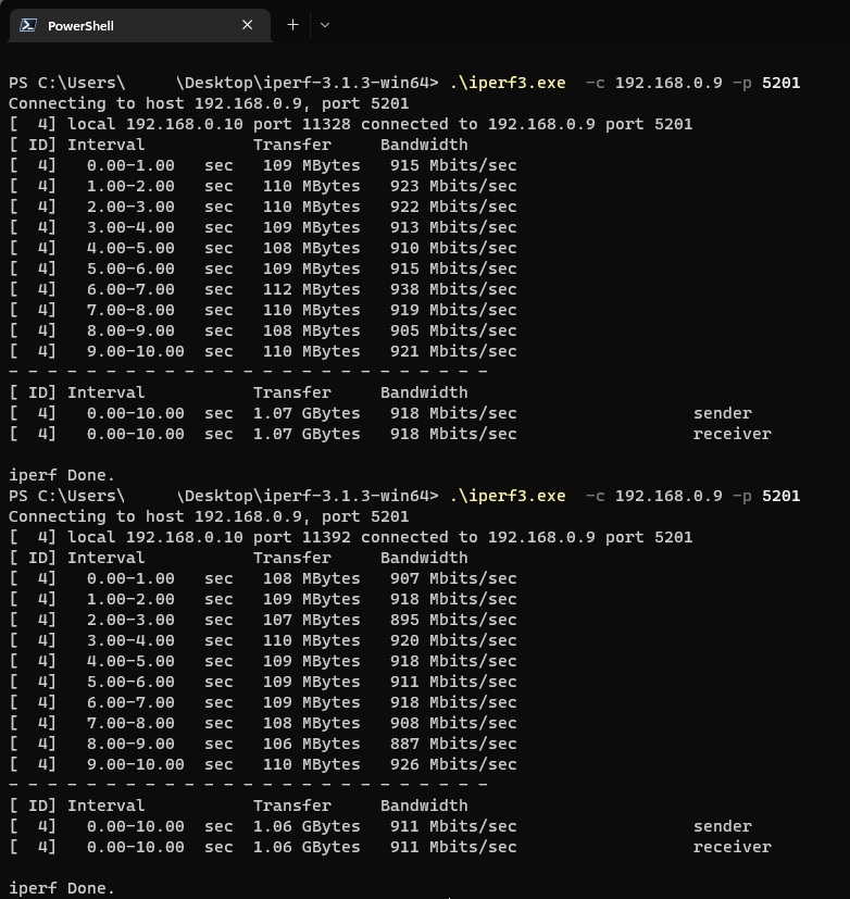

November 10, 20224 yr [Template only, I am not the container author/maintainer] Template: https://github.com/kilrah/unraid-docker-templates/raw/main/templates/iperf3.xml Source container: https://github.com/nerdalert/iperf3 Registry: https://hub.docker.com/r/networkstatic/iperf3 The popular network performance testing tool, running as a service. Spawns an iperf3 instance with the settings you put in the "Post Arguments" field (switch to Advanced View to see it). By default that will be a server on port 5201, which can be remapped in the template. Clearing Post Arguments will show the help text in the log and stop. Performance is comparable to running native, at least on gigabit (top is container, bottom is native). Edited November 11, 20224 yr by Kilrah
