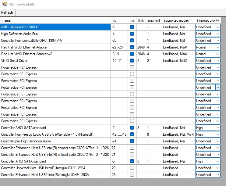

As an example, this is my device list:
Let's say your network controller is my Red Hat Virtio ethernet adapter.
What you need to check:
1. Check if there is a checkmark for the network controller, under msi; if there is, stop here the issue is elsewhere
2. If there isn't a checkmark check in the irq column that the number is not shared with anything else, if it's not shared stop here the issue is elsewhere
3. If the irq is shared and there isn't a checkmark in the msi column, under msi, put it, click apply, restart the vm, and see if things are better.
In general check for other irq shares and apply msi on devices that support it (msi is supported if it is in the "support modes" column) to avoid irq sharing.
As you can see I applied msi to several devices to avoid irq sharing. All usb controllers, emulated and passed through do not support msi, but luckily they have independent irqs: 22, 21, 20, 23.
Please note that enabling msi on non supported devices or on devices with bugged drivers may cause the vm to not boot...I would think twice before applying msi to a passed through sata controller to which the boot disk is attached...

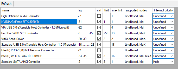

Hay, Thanks for your answer, but with looking into the tool the issue seems to be somewhere else.
Im sending a Screenshot:
As u can See 3070Ti is -31 and completly alone in its group, so the issue seems to be somewhere else
But Thank you so far for your efforts
You have the audio part of the gpu on irq 22 (same as network controller), put a checkmark on high definition audio controller, apply and restart.
Not sure it will solve the issue, worth a try, and anyway it's the proper setting to avoid any conflict and audio lags.
Edited by ghost82
Box was Ticked, PC Restarted, Irq is now on 32, so seperate from the network card.
