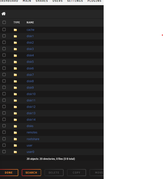

I moved the system files from the array and fixed the plex container mapping. Now when I run the "Where can I see what folders are taking up my RAM?" found here
it returns the attached and looking much better. I still 2 files that show up as /mnt, 0 /mnt/rootshare and /mnt. I beleive that /mnt/rootshare was created following Spaceinvader One's video about root shares for Windows users. I am guessing it's supposed to be there and looks as if it is using zero memory. I don't know about /mnt Also, when browsing the files using the file browser, there are 2 folders in /root I do not know what they are. "disks" and "remotes". I tried to delete disks but it returns on it's own. I am assuming these are supposed to be there or were created by mistake?
Memory Output.txt blackhole-diagnostics-20221122-0849.zip
/mnt is in rootfs, but it is supposed to be there as a place for things to get "mounted". All array disks, pools, and user shares are mounted in /mnt
/mnt/disks, /mnt/remotes, /mnt/rootshare are created by Unassigned Devices as places for it to mount unassigned disks, remote shares, and the rootshare that includes all user shares.
Anything else that specifies a path in /mnt, such as /mnt/plex, will create that path, but with nothing getting mounted there, anything stored there is taking up rootfs space.

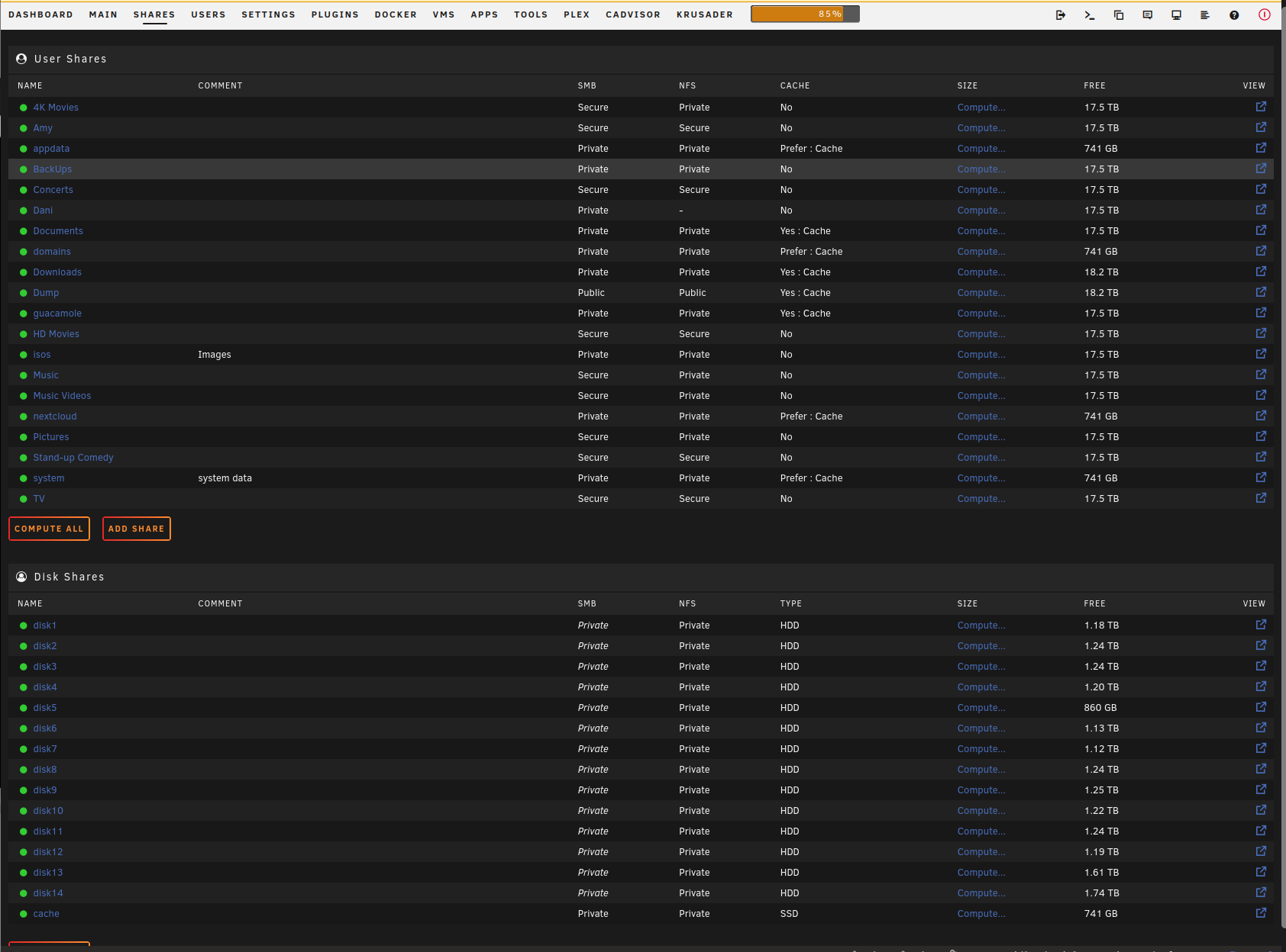

What is the purpose of your cache:prefer share n-------d ?
That is a god question. I don't know.
Where would I look for this? I am not seeing it under the shares tab.
The diagnostics are anonymized so I don't know the exact name of the share. Diagnostics shows you have a share beginning with n, ending with d, 9 characters, set as cache:prefer, and with files on cache.
Post a screenshot of User Shares page
1 hour ago, elco1965 said:
It should be gone.
If you mean the cache:prefer user share I was asking about, these latest diagnostics have
n-------d                         shareUseCache="prefer"  Exists on cache
and your screenshot clearly shows a user share named 'nextcloud', which is
Not necessarily wrong to have nextcloud cache:prefer. Just be sure you don't fill cache.
