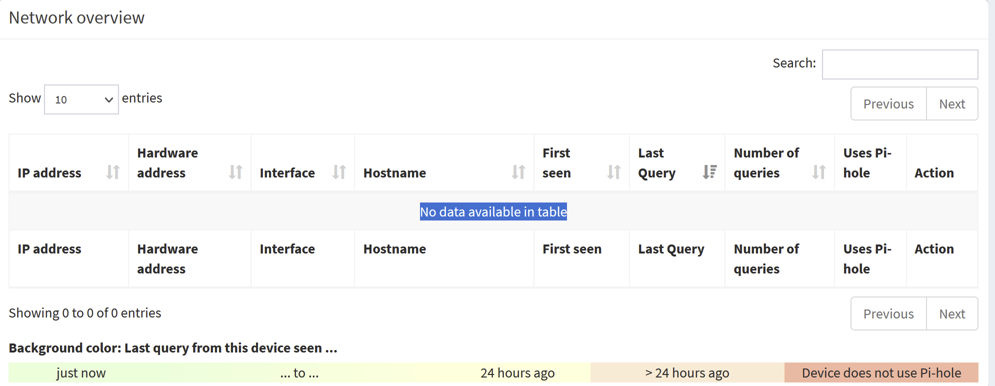

One thing though. My dashboard reports a number of active clients.
Clicking on the link, the Network overview page is empty, I only see the message "No data available in table"
I did a lot of googling but can't seem to find an applicable cause or a solution.
Any ideas what might cause this for me? What additional info would you potentially need from me? Again, pretty noob here....
Thanks!
I will have to dig a bit on this one as i coulr not reproduce
Just wanted to let you know that I went with the official pihole docker now and have my Fritzbox do the dot lookups. Works very well and here all clients are showing fine.
So, as far as I'm concerned, no need to look into this any further.
I will look at it and update

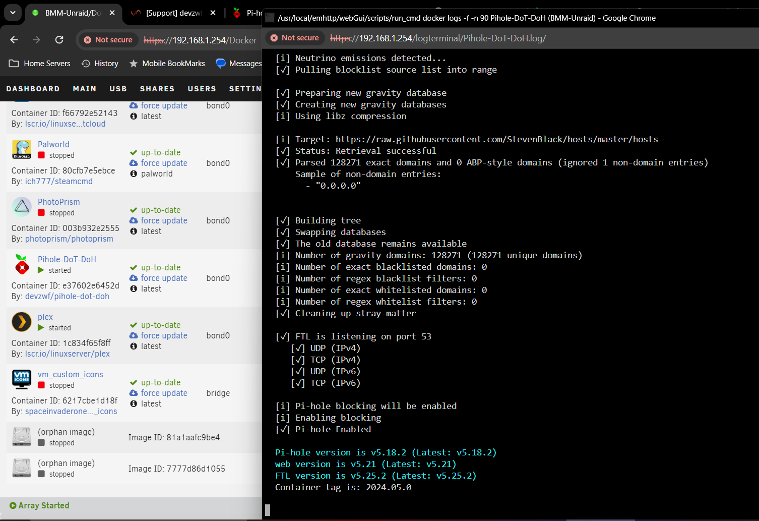

Container updated ....
21.03.2024 01:16:19 cloudflared version 2024.3.0 (built 2024-03-20-1010 UTC) installed for amd64
21.03.2024 01:16:19 Unbound Version 1.19.3 installed for amd64
21.03.2024 01:16:20 Built from pihole/pihole with tag latest

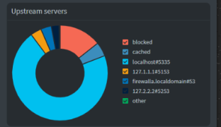

In my setup, I have dot/doh via docker template handling the queries, but unbound will overtake as a recursive dns. It will still use my dot/doh settings but all dns queries now run through unbound.
10 hours ago, ArstenA said:
@ZappyZap I will be honest, I just installed PiHole on unRAID. I have for years been using a raspberry Pi with PiHole and Unbound, but my Pi died. So I decided to move it to unRAID.
I have a Ubiquiti network setup so I am routing all DNS (port 53) traffic to Pi Hole.  I also block all requests from NOT using the PiHole.
I saw your template had DOT and DOH, which I have not used before. But I noticed it did not have Unbound and I just found this forum thread.
Question about DOT and DOH, since my network routes all DNS traffic to Pi Hole, does PiHole convert it to DOH/DOT? Or do I need to do similar Ubiquiti configs to route all that traffic to PiHole too?
I have been trying to do reading on how it works but I don't understand it.
To implement my setup, add 99-upstreamdns.conf and 99-edns.conf to the (dnsmasq.d folder) under appdata in unraid path via your template. The other configs exist in the /config path location
99 Upstreams contains other pihole dns server that it can use for DNS queries. The docker template should use dot/doh, and you can see that it is implementing the dot/doh under pihole > setting > dns. If you place a checkbox to other dns severe to use here, it would write to a config that is replaced on docker reboot the option I want to use can be added to another config which is the 99-upstreamdns.conf
the severer option in this config is the same as selecting the other checkbox and not to use custom. the template regenerates this based on an option set in the template.
Unfortunate, its up to pihole / dns query that comes in to then determine the dns system that it uses.
This mean that Upstreams dns config may become the primary DNS server. as you can see in my piehole site which server is used more, in my case unbound is used more. And the server to doh/dot are listed and available when needed.
Per the template data, unbound config is using pihole_dns and is using (stuby/cloudfare) dot/doh server setting for queries when needed. To help ease this, I add a dns record for piohole_dns to 127.0.0.1(Localhost) to help point it to local host for these queries.

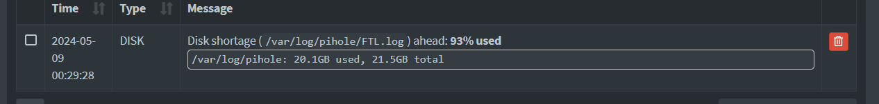

32 minutes ago, bmartino1 said:
sad panda...
i don't know what you changed or did. fresh docker install:
i ahve atempted to
tuncate -s 0 /var/log/pihole.FTL.log
do a 1 to 1 to remove that log out
https://discourse.pi-hole.net/t/disk-getting-full-cant-free-space/52800/2
run
pihole flush
sqlite3 /etc/pihole/pihole-FTL.db "VACUUM;"
So I delete the template, docker image and files and Also did a fresh installation with the same... also says DB is full
New file paths ... so something broke in the update!
turned out to be unraid btrfs log file form all the dockers it didn't reset per other scripts and configs...
had to delete my docker vdisk. I decide to increase the size and leave btrfx, used docker xfs. No issues now.

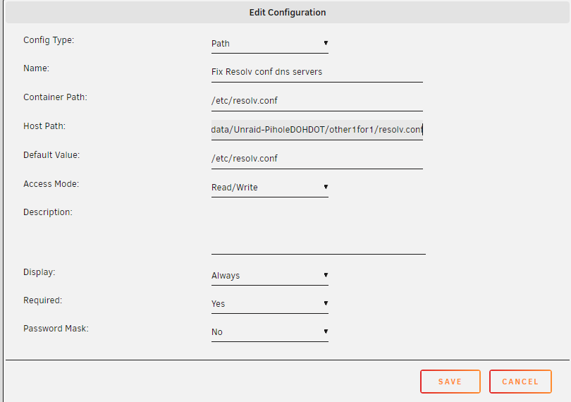

I was able to fix this by creating a 1 to 1 file for the docker
My resolve conf contains:
root@PIHOLEDOHDOT:/# cat /etc/resolv.conf
#Docker Default:
nameserver 127.0.0.11
options ndots:0
#Local Machine
nameserver 192.168.2.10
#Unriad:
# Generated by rc.inet1
nameserver 208.67.222.222
nameserver 9.9.9.9
#My other Upstream DNS:
#domain localdomain
#search localdomain
nameserver 130.126.2.131
#nameserver 8.8.8.8
#nameserver 1.1.1.1
#Docker local DNS:
#stubby(DOT) and cloudflare(DOH)
nameserver 127.1.1.1#5153
nameserver 127.2.2.2#5253
#unbound:
nameserver 127.0.0.1#5335
Edited by bmartino1
Corect update dns in resolve conf
this appears to be happening as my local LAN is now 192.168.2.1 and not the default home router domains of 192.168.1.1 found in the dnsmasq conf that is forcibly overwritten at docker start:
as i edited that conf earlier and set them both to 192.168.2.X to fix this...
with out being able to edit the file 01-pihole.conf under the dnsmasq folder.
https://docs.pi-hole.net/ftldns/configfile/
I'm presented with a failed resolv.conf with no dns resolver.
To fix this i have to make another 99-fix-pihole-01.conf
^I also edit my etc ftl conf and this requires me to have the config edit to add option domain.
with the correct information
The docker would need a code update for first run to download and a check if to not download...
Edited by bmartino1
