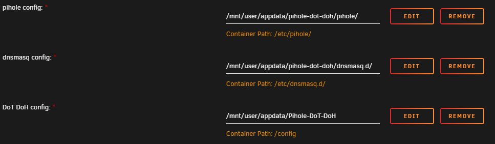

So I have to say, this container is set up in an extremely ....... bad way...
When I installed this, I noticed later I have 2 folders in my /appdata...
Pihole-Dot-Doh
and
pihole-dot-doh
I removed the latter, second one. As I expected it was a left-over folder from another docker container that didn't work/was from an older docker image or repository. It's name didn't match case-sensitive the name of this docker container either.
Welp. I just lost all of my settings.
Now obviously I should have double checked, but ugh... due to the default spelling this container is making TWO directories with the SAME names in my /appdata directory... those above 2 I just listed. Now I bet 99% of people will not notice when creating or editing the container and checking the mapped directories...
Gonna be great fun to completely remake my entire config... and add all those whitelisted domains again.. FFS!
I highly recommend you change this. I have 41 containers on my system and none of them have ever made 2 directories in /appdata ever.
Edited by plantsandbinary

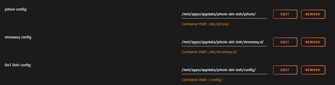

what i can say it is not the template who make this :
 <Config Name="pihole config" Target="/etc/pihole/" Default="/mnt/user/appdata/pihole-dot-doh/pihole/" Mode="rw,slave" Description="" Type="Path" Display="always" Required="true" Mask="false">/mnt/user/appdata/pihole-dot-doh/pihole/</Config>
  <Config Name="dnsmasq config" Target="/etc/dnsmasq.d/" Default="/mnt/user/appdata/pihole-dot-doh/dnsmasq.d/" Mode="rw,slave" Description="" Type="Path" Display="always" Required="true" Mask="false">/mnt/user/appdata/pihole-dot-doh/dnsmasq.d/</Config>
  <Config Name="DoT DoH config" Target="/config/" Default="/mnt/user/appdata/pihole-dot-doh/config/" Mode="rw,slave" Description="" Type="Path" Display="always" Required="true" Mask="false">/mnt/user/appdata/pihole-dot-doh/config/</Config>
BTW i am sorry that you delete a dir in use with your setup, but it is not this template to blame.
It seems there might be some interaction with CA, or maybe it's if you had the old flippinturt one before?
https://raw.githubusercontent.com/devzwf/unraid-docker-templates/master/pihole-dot-doh.xml
The template indeed doesn't have an issue, but if I select Install (it'll think it's a new install since the existing one still comes from the old template) then it does put caps.
Might be that CA interprets a "/config" path as being supposed to default to the container name and overwrites what's in the template? Might want to ask @Squid.
Edited by Kilrah
Oh and i found the culprit : it is the template from "Mavrag's Repository"
Same app name , but really not same template
Mine is maintain and widely use
thanks

are you sure you are using my template ?

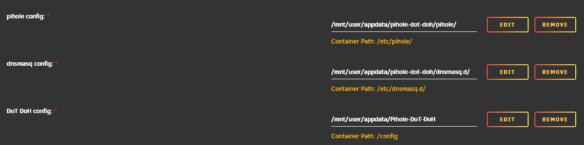

Yup. There are 3 "Pihole-DoT-DoH" templates with the default container name being that, all 3 have correct paths in the template but for me all of them have it replaced by the container name on install.
Seems to be a CA issue.
Edited by Kilrah

Seems unrelated to flippinturt, just tried installing it on my test setup that never had any installed and it's the same, so most likely CA
did the same and saw the same behavior
thanks @Kilrah
