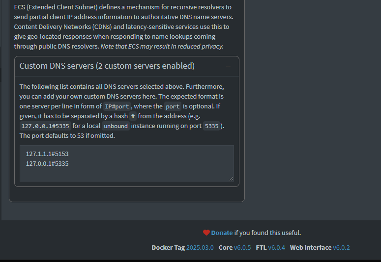

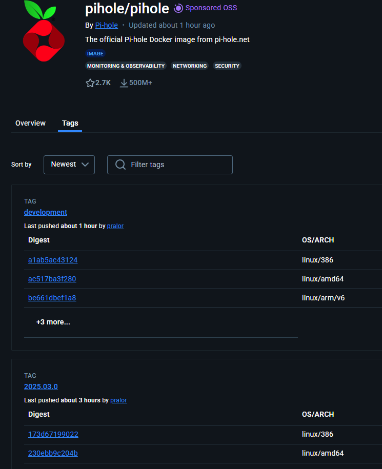

45 minutes ago, bmartino1 said:
? 2025.03.0-v6dev
i'm on and running 2025.02.6-v6dev01 atm with out issues.
the dev image :
devzwf/pihole-dot-doh:2025.03.0-0.v6dev
pihole update to :
Pi-hole FTL v6.0.4, Web v6.0.2 and Core v6.0.5  few hours ago https://pi-hole.net/blog/2025/03/04/pi-hole-ftl-v6-0-4-web-v6-0-2-and-core-v6-0-5-released/#page-content
and the docker image as well :

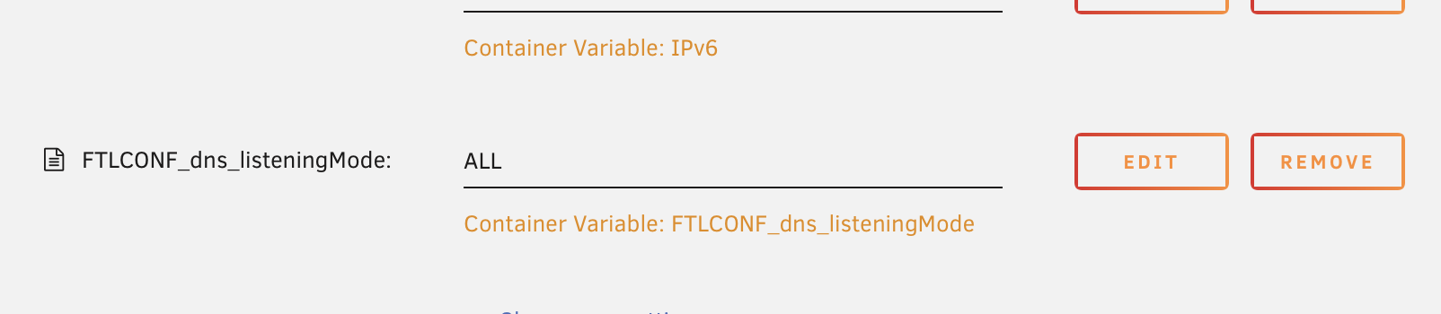

For some reason, v6 does not seem accept some of the settings from Unraid UI. My instance complains that parameters are empty, even though I have set them in user interface.
SafariTechnologyPreview_2025-04-04_12_56.05@2x.thumb.png.85dfbd1869a33cc260d60d7a9be5d8c6.png
SafariTechnologyPreview_2025-04-04_12_57.49@2x.thumb.png.007b26d8aca8390d777e08a959339381.png
Parameters also do appear to be set correctly when starting the container:
Command execution
docker run
  -d
  --name='Pihole-DoT-DoH'
  --net='br0'
  --ip='192.168.50.8'
  --pids-limit 2048
  -e TZ="Europe/Kiev"
  -e HOST_OS="Unraid"
  -e HOST_HOSTNAME="cs381"
  -e HOST_CONTAINERNAME="Pihole-DoT-DoH"
  -e 'TCP_PORT_53'='53'
  -e 'UDP_PORT_53'='53'
  -e 'UDP_PORT_67'='67'
  -e 'TCP_PORT_80'='80'
  -e 'TCP_PORT_443'='443'
  -e 'FTLCONF_dns_upstreams'='127.1.1.1#5153;127.0.0.1#5335'
  -e 'TZ'='Europe/Helsinki'
  -e 'FTLCONF_webserver_api_password'='xxxxxxx'
  -e 'INTERFACE'='eth0'
  -e 'ServerIP'='192.168.50.8'
  -e 'ServerIPv6'=''
  -e 'IPv6'='False'
  -e 'FTLCONF_dns_listeningMode'='ALL'
  -l net.unraid.docker.webui='http://[IP]:[PORT:80]/admin'
  -l net.unraid.docker.icon='https://raw.githubusercontent.com/devzwf/unraid-docker-templates/main/images/pihole-logo-bw.png'
  -v '/mnt/user/appdata/pihole-dot-doh/pihole/':'/etc/pihole/':'rw,slave'
  -v '/mnt/user/appdata/pihole-dot-doh/dnsmasq.d/':'/etc/dnsmasq.d/':'rw,slave'
  -v '/mnt/user/appdata/pihole-dot-doh':'/config':'rw,slave'
  --cap-add=NET_ADMIN
  --restart=unless-stopped
  --hostname ns 'devzwf/pihole-dot-doh:latest-v6'
756158ef570af095cb3a34e7d07485135066fefbe495ec6b45815710c974efe2
The command finished successfully!
But in log I get warnings and error:
2025-04-04 12:49:57.326 EEST [104M] INFO: ########## FTL started on ns! ##########
2025-04-04 12:49:57.326 EEST [104M] INFO: FTL branch: master
2025-04-04 12:49:57.326 EEST [104M] INFO: FTL version: v6.1
2025-04-04 12:49:57.326 EEST [104M] INFO: FTL commit: a3313229
2025-04-04 12:49:57.327 EEST [104M] INFO: FTL date: 2025-03-30 17:53:24 +0100
2025-04-04 12:49:57.327 EEST [104M] INFO: FTL user: pihole
2025-04-04 12:49:57.327 EEST [104M] INFO: Compiled for linux/amd64 (compiled on CI) using cc (Alpine 14.2.0) 14.2.0
2025-04-04 12:49:57.327 EEST [104M] WARNING: Environment variable FTLCONF_webserver_api_password has no value, substituting with empty string
2025-04-04 12:49:57.327 EEST [104M] WARNING: Environment variable FTLCONF_dns_listeningMode has no value, substituting with empty string
2025-04-04 12:49:57.337 EEST [104M] INFO: 3 FTLCONF environment variables found (2 used, 1 invalid, 0 ignored)
2025-04-04 12:49:57.337 EEST [104M] ERROR:   [✗] FTLCONF_dns_listeningMode = "" is invalid, allowed options are: ["LOCAL","SINGLE","BIND","ALL","NONE"], using default instead
2025-04-04 12:49:57.337 EEST [104M] INFO:    [✓] FTLCONF_webserver_api_password is used
2025-04-04 12:49:57.337 EEST [104M] INFO:    [✓] FTLCONF_dns_upstreams is used
Anybody got any idea what could be the issue?

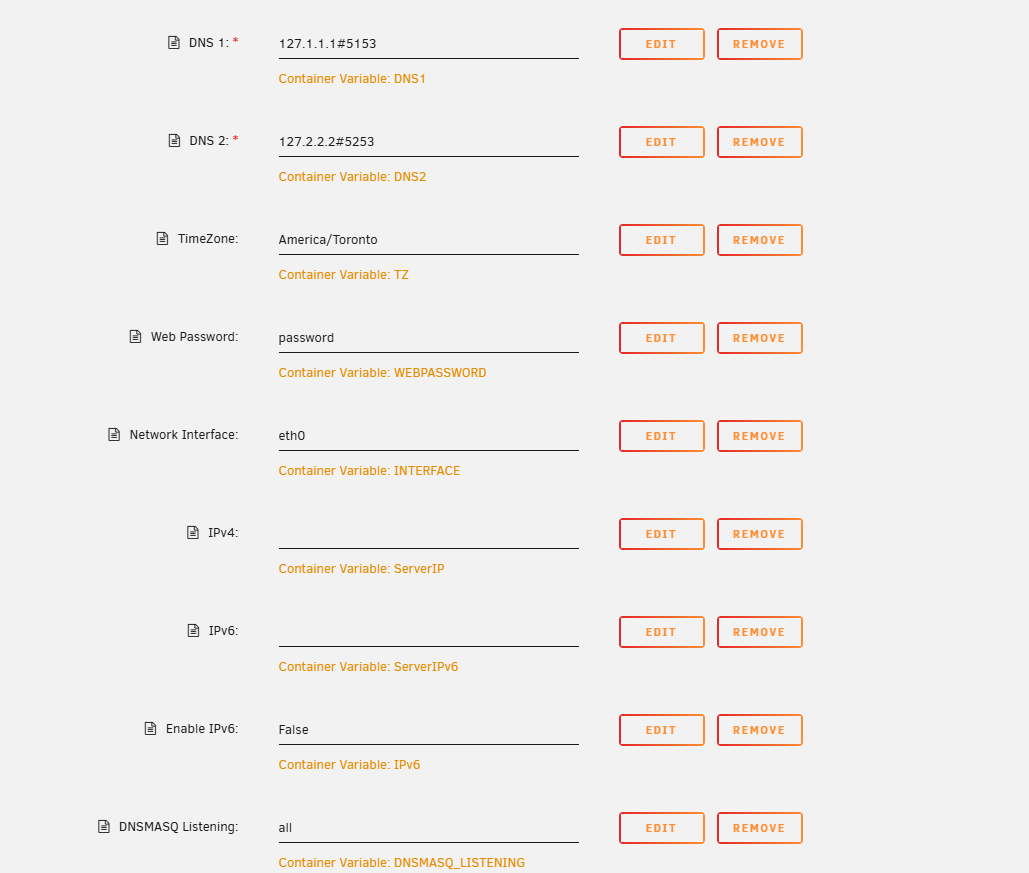

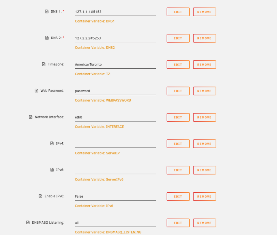

13 minutes ago, Alyred said:
Thanks @ZappyZap.  I do understand it's a one-way migration (though I do have my appdata/config files separated into datasets so fairly easy to snapshot), but I'm not sure of the exact specifics between the two that I need to look out for or may need to manually adjust.  Any easy-to-pass-on gotchas or prep I should be checking for?
https://docs.pi-hole.net/docker/upgrading/v5-v6/
all need updated to the new correct env...
as shown in the compose file...
environment:
      # Set the appropriate timezone for your location (https://en.wikipedia.org/wiki/List_of_tz_database_time_zones)
      TZ: "America/Chicago"
      # Set a password to access the web interface. Not setting one will result in a random password being assigned
      FTLCONF_webserver_api_password: "test"
      # DoT: unbound (127.0.0.1#5335), DoH: cloudflared (127.1.1.1#5153)
      FTLCONF_dns_upstreams: "127.1.1.1#5153;127.0.0.1#5335"
      FTLCONF_dns_listeningMode: "all"

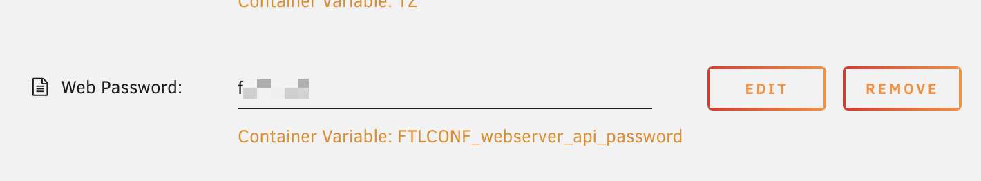

A few issues i see:
DoT DoH config path defaults to /mnt/cache, should be /mnt/user
TZ shouldn't be there, unraid adds it on its own
Web API Password isn't set as password type
4 minutes ago, Kilrah said:
A few issues i see:
Thanks @Kilrah
i will update it
