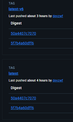

4 hours ago, jankasten said:
Totally my fault
I am so sorry, I disable the automation for some heavy lifting and forgot to re-enable it.....
Hope you will forgive me .... update has been push
