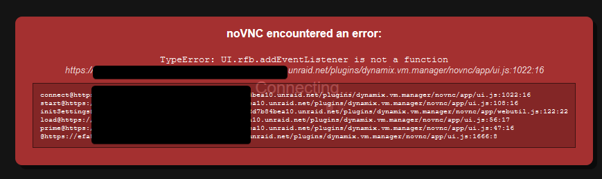

  10. Firefox update is what was broken, not unRAID or this plugin. No idea why starting w/o plugins worked, but there you go. Seems that the recent update is breaking noVNC functionality on my installation. Upgraded to rc9, and then upgraded UD to most recent build, rebooting server after after each upgrade. I'm getting the following error whenever I try to connect to a VM using noVNC. I can SSH into those VMs just fine, and when booting into the server with no plugins enabled and VNC works just fine. I then uninstalled just UD and got the same result. noVNC encountered an error: TypeError: UI.rfb.addEventListener is not a function https://****************************************.unraid.net/plugins/dynamix.vm.manager/novnc/app/ui.js:1022:16 connect@https://****************************************.unraid.net/plugins/dynamix.vm.manager/novnc/app/ui.js:1022:16 start@https://****************************************.unraid.net/plugins/dynamix.vm.manager/novnc/app/ui.js:108:16 initSettings@https://****************************************.unraid.net/plugins/dynamix.vm.manager/novnc/app/webutil.js:122:22 load@https://****************************************.unraid.net/plugins/dynamix.vm.manager/novnc/app/ui.js:56:17 prime@https://****************************************.unraid.net/plugins/dynamix.vm.manager/novnc/app/ui.js:47:16 @https://****************************************.unraid.net/plugins/dynamix.vm.manager/novnc/app/ui.js:1666:8 Here's a code snippet of UI.rfb in /usr/local/emhttp UI.updateVisualState('connecting'); let url; url = UI.getSetting('encrypt') ? 'wss' : 'ws'; url += '://' + host; if (port) { url += ':' + port; } url += '/' + path; UI.rfb = new RFB(document.getElementById('noVNC_container'), url, { shared: UI.getSetting('shared'), repeaterID: UI.getSetting('repeaterID'), credentials: { password: password }, //the line under this comment is line 1022 (referenced by the noVNC error) wsProtocols: ['binary'] }); UI.rfb.addEventListener("connect", UI.connectFinished); UI.rfb.addEventListener("disconnect", UI.disconnectFinished); UI.rfb.addEventListener("credentialsrequired", UI.credentials); UI.rfb.addEventListener("securityfailure", UI.securityFailed); UI.rfb.addEventListener("capabilities", UI.updatePowerButton); UI.rfb.addEventListener("clipboard", UI.clipboardReceive); UI.rfb.addEventListener("bell", UI.bell); UI.rfb.addEventListener("desktopname", UI.updateDesktopName); UI.rfb.clipViewport = UI.getSetting('view_clip'); UI.rfb.scaleViewport = UI.getSetting('resize') === 'scale'; UI.rfb.resizeSession = UI.getSetting('resize') === 'remote'; UI.rfb.showDotCursor = UI.getSetting('show_dot'); UI.updateViewOnly(); // requires UI.rfb }, disconnect() { UI.closeAllPanels(); UI.rfb.disconnect(); UI.connected = false; // Disable automatic reconnecting UI.inhibit_reconnect = true; UI.updateVisualState('disconnecting'); No idea what's happening or if it's even something intrinsic to UD vs 6.8-rc9 but figured I'd start here. Thanks!
