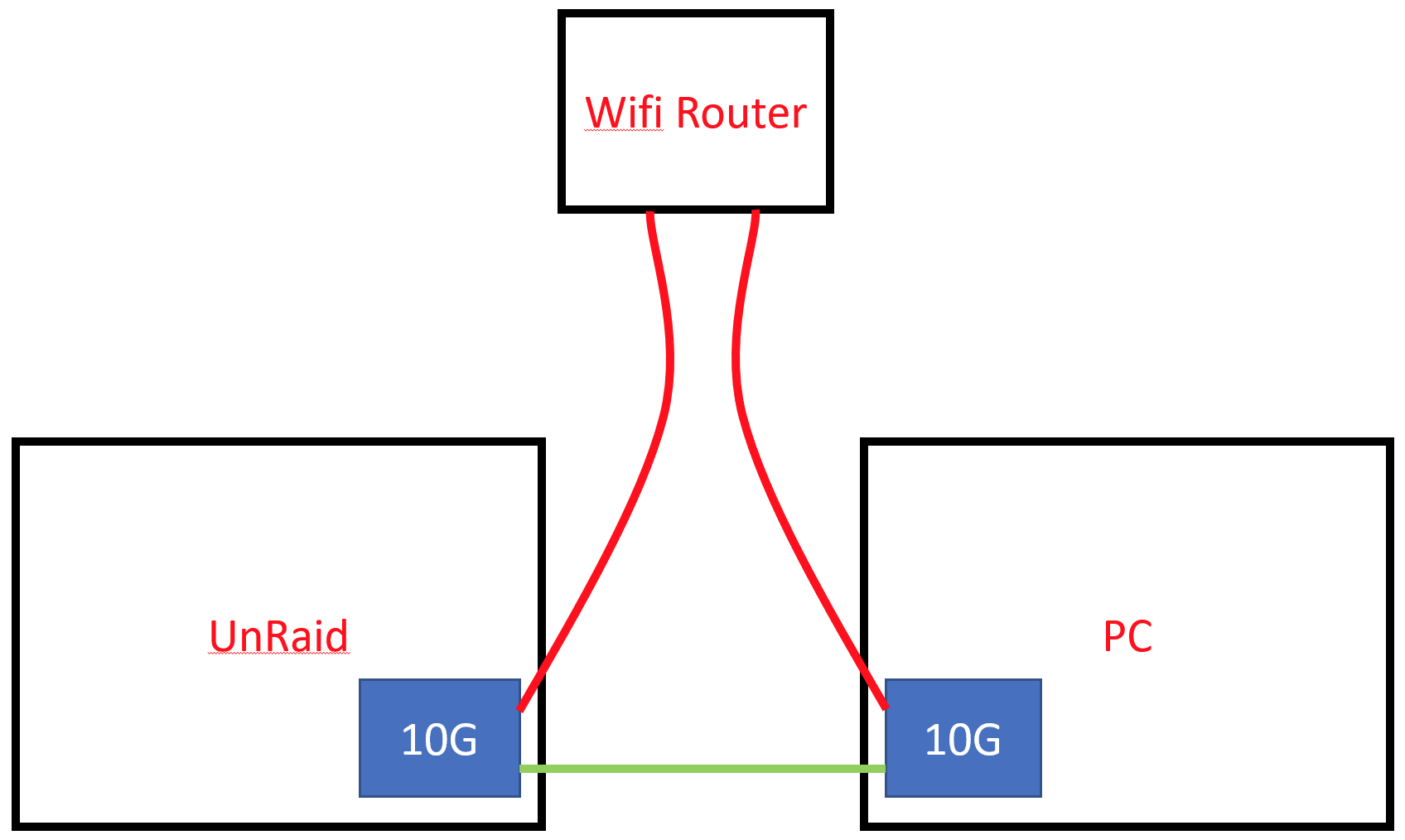

December 15, 20223 yr Hello all, I'm setting up my first unraid server and I also wanted get experience with 10G data transfer for the first time. I've got a used a pc for my unraid server and got two used 10G Ethernet adapters. My current setup is illustrated on the image below. The problem is when I try to transfer data from my PC to the unraid server it goes through the wifi router which slows down the file transfer. Is there a possibility by-passing the router for data transfer between the pc and the unraid server with unraid server still connected to the wifi router. So I can access the files via internet? Is my only option is to get a 10G router to make this possible? Any help on this issue is highly appreciated. Cheers, Rashiga
December 15, 20223 yr your setup is wrong (aka: it does not work, but you have already noticed this 😁) What you have to do to get this working: * kill the connection between PC and Wifi Router (the PC is only connected to UNRAID) * on UNRAID create a Bridge containing both connections (eth0 + eth1 I guess) The PC will then only talk to UNRAID and packets meant for other destinations will be forwarded to the Router by UNRAID So you get the fast file access and internet still works. (Drawback: if UNRAID is not running, the PC hangs in thin air, not able to get to the internet) (in the long run you will need a 10G router, this simplyfies the setup and eliminates the drawback) (make sure you have proper cables for the 10G line. "normal" patch cables will result in strange line dropouts, hangs, slowdowns. You did not tell if your cards have SFP+ cages or are fixed with RJ45, so I assume the last, else get fiber and be happy, anything else can give problems) Edited December 15, 20223 yr by MAM59

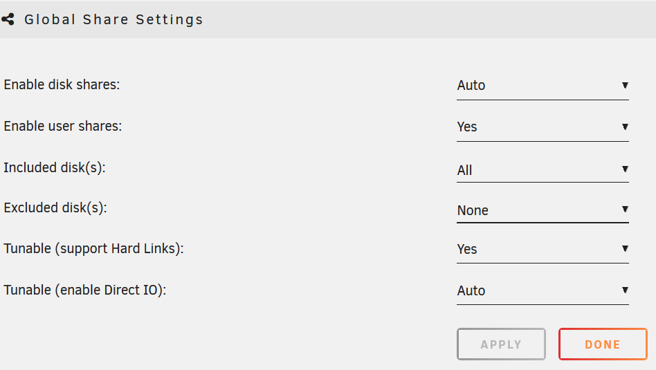

December 20, 20223 yr Author @KingfisherUK thank you for this video! I followed the steps and it worked! @JorgeB thank you, for the suggestion However, when I mapped my drive using the IP address of the 10 gig card, the data get by passed the cache drive. When I searched about it, it was mentioned to change global share settings. But I cannot see any option for cache drive in the global settings.
December 20, 20223 yr 39 minutes ago, Rashiga said: However, when I mapped my drive using the IP address of the 10 gig card, the data get by passed the cache drive. When I searched about it Don't understand what you mean, that is controlled by the share settings, nothing to do with the NIC or IP used.

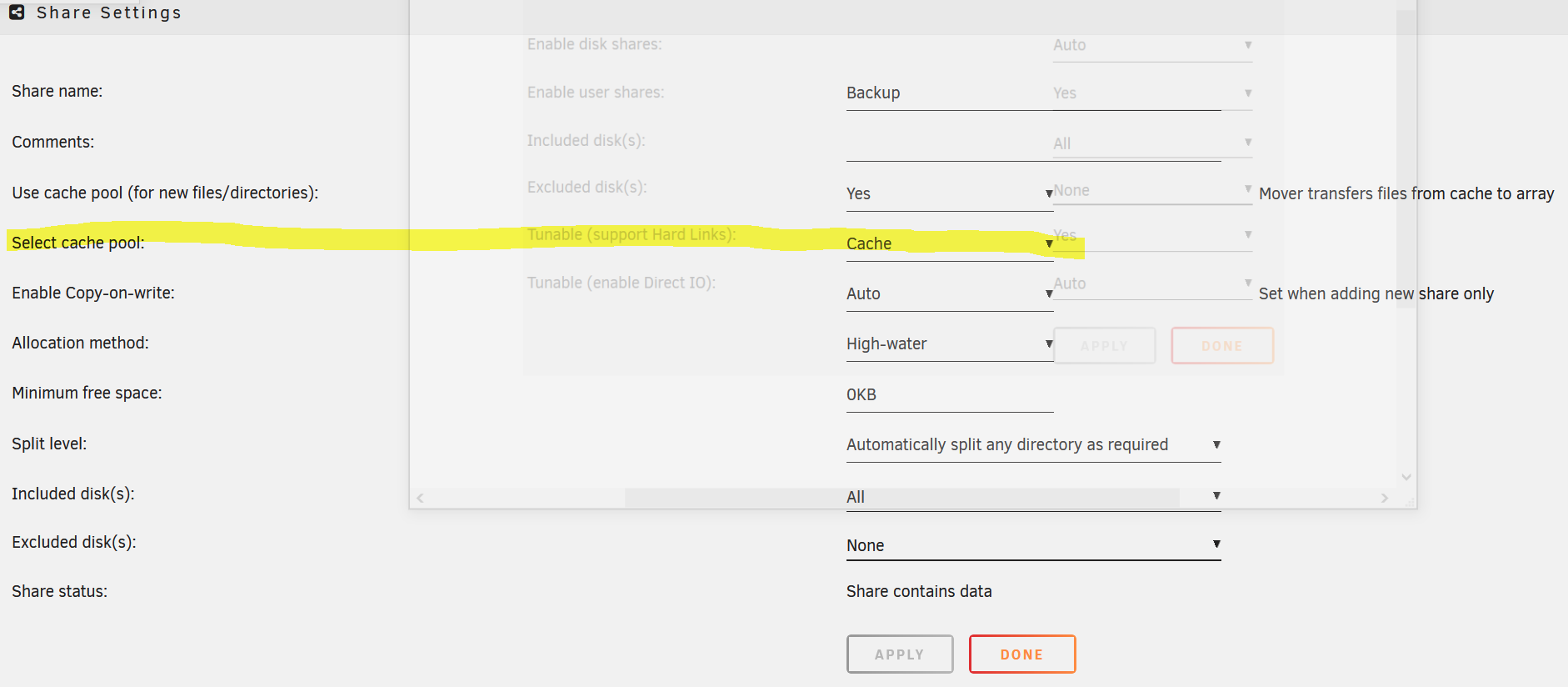

December 20, 20223 yr Author @JorgeB I have set the cache drive for my shared folder in share settings. But when I copy files it straight away get copied to the hdd not the cache (ssd). Previously (before I followed the steps to configure 10 gig card according to the above video) it worked properly.
December 20, 20223 yr only NEW files go to cache. If you want to repeat the same one, delete the copy on the array before (usually this is done automatically, but if you are one of the fast & nervous guys, it may have not happened already, so do it manually to be sure).

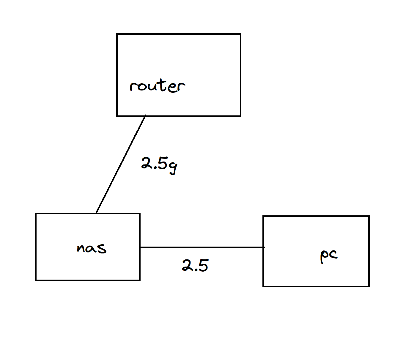

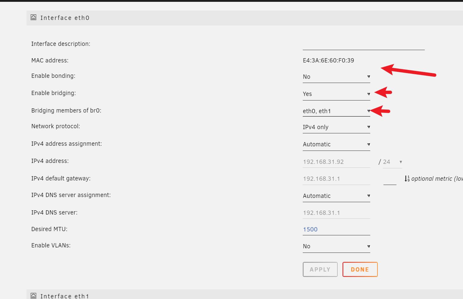

July 9, 20233 yr For anyone searching for this article My router has two 2.5G ports My computer has a 2.5 network port I avoided buying a switch by doing this and managed to get my computer to connect to a nas at 2.5g and access the internet. Interface ethO Interface description: MAC address: Enable bonding: E4:3A:0:39 No Enable bridging: Yes Bridging members of brO: ethO, eth1 Network protocol: IPv4 only IPv4 address assignment: Automatic IPv4 address: 192.168.31.92 IPv4 default gateway: 192.168.31.1 IPv4 DNS server assignment: Automatic IPv4 DNS server: 192.168.31.1 Desired MTU: 1500 Enable VLANs: No
