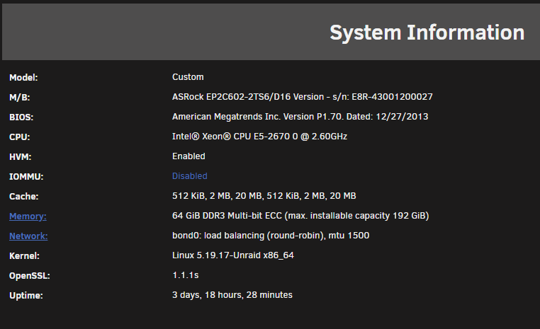

Additional SysInfo:
- UnRAID Version: 6.11.5
- Dual E5-2670 CPUs
- 10G network, both servers bonded via Netgear XS708E switch

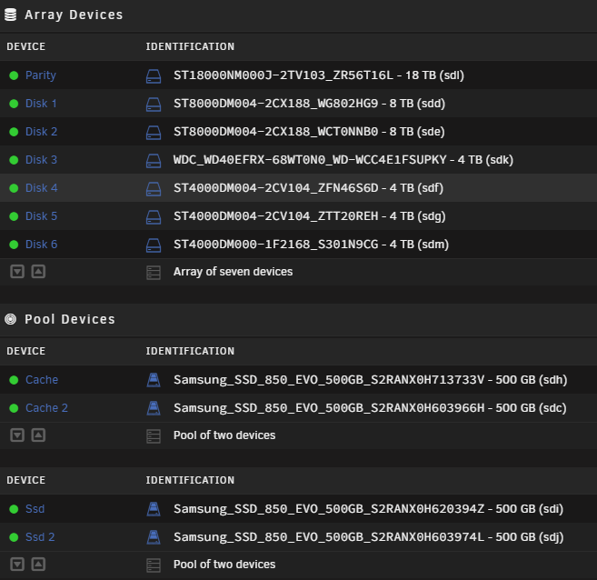

- Hard drives: (note the parity drive is CMR)

I am starting to think the issue lies with the SMR drives being used (as highwater is set, data is going to ST8000DM004 Seagate Barricudas at this point). I just wouldn't think it would be THIS significant of an issue as I expected a blip in transfers here and there but not a complete stall. I even ran DiskSpeed and tested all drive and controller speeds and everything is benchmarking fine with no bottlenecking.
Most likely. That's how SMR drives behave, if you fill their cache and continue writing they slow down to a crawl as they start thrashing trying to both flush cache AND accept new data at the same time. Pretty easy to see, if you pause the transfer and give them a couple of hours to flush internal cache, restart and it's normal for a while again that's your problem.
