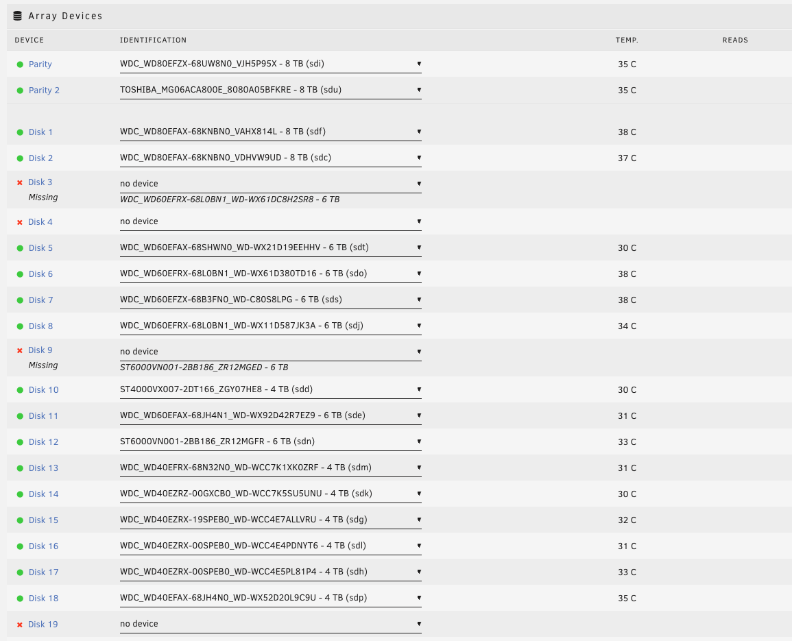

I am almost done with the Preclear process.... And I am preparing to install the new drives (3 x 8Tb WD Red) to replace the burned ones...
I went through the on-line guide but still things are not too clear for me:
Since I lost 4 disks due to a faulty cable that apparently burned them (the are totally dead and unusable in any way) now I would like to rebuilt at least the 2 disks that are still considered missing by the system (the other two are not even mentioned anymore in the Array Device list). I case the disk was I would have followed the standard procedure but but multiple disk failure I am really not sure on how to proceed
1633425161_ScreenShot2022-12-25at12_15_46.thumb.png.62917dbee8d9abad42c4f22acb9de870.png
According to your instruction in order to recover some of the data I shall use New Config Tool and I went through the guide itimpi suggested me but reading the first lines I am scared I will make a mess... the guide says in the very first lines the following:
 This tool is not part of the standard process for recovering from a disk failure... it will have the opposite effect and stop you being able to recover the contents of a failed disk intact;
Now my main question... should I go ahead anyway with this?
Sorry again if I am a pain but I guess that 20 Tb of data lost in a month are enough... ;-)
You can't rebuild from parity without all the disks. Parity by itself can recover nothing. Single parity will let you recover a single data disk but only if all the other disks are present. Dual parity will let you recover 2 data disks but only if all other disks are present.
Parity is not a substitute for backup and parity contains none of your data.
See this wiki for a better understanding of how parity works with all other disks:
https://wiki.unraid.net/Manual/Overview#Parity-Protected_Array
The point of New Config in your case isn't to recover anything, it is simply to get the rest of the disks into a new array and rebuild parity.
Ok that is clear... so if I just install 2 new disks on slot nr 3 and 9 I will be not able to recover anithing correct?
Correct, not from the missing disks, you need to do a new config.

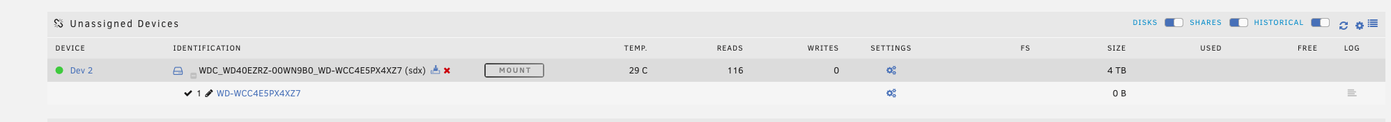

Just got home... now one of the disks is recognized by UD but I cannot mount it (the MOUNT option is grayed out and not selectable)
Any idea?
I tried to add it to the array but obviously is thelling me that it will be formatted and all data overwritten
1979550402_ScreenShot2022-12-27at17_27_32.thumb.png.70d0e17a24e1d4036f063c79f3f93f38.png
If you add it to an array that already has valid parity, it will be cleared, which is even worse than being formatted if you hope to recover any data from it.
Attach diagnostics to your NEXT post in this thread
Post the output of
fdisk -l /dev/sdx

Now the output of
xfs_repair -n /dev/sdx1
Note the 1 in the end.
