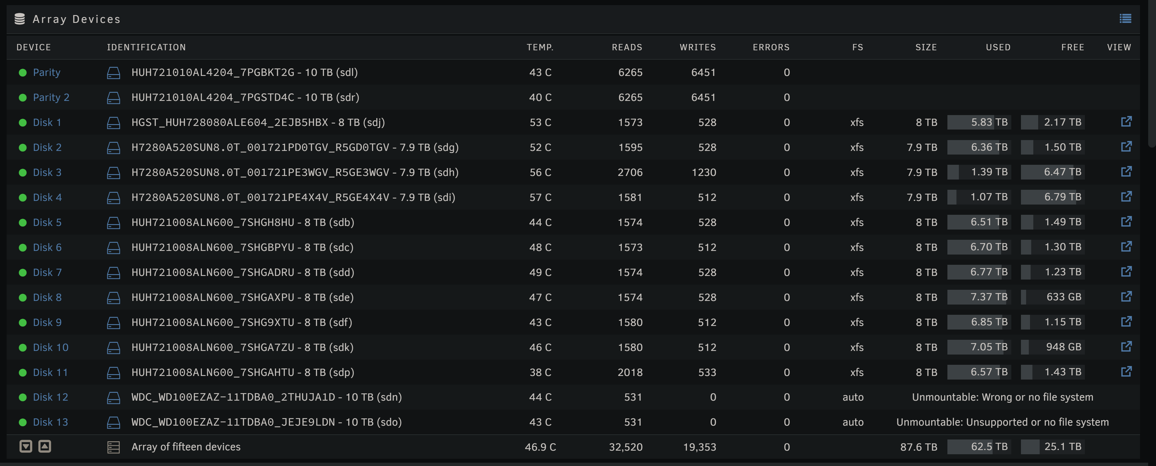

Now, after a few months i have finally setup my server rack and after installing the hdd's into my 24 supermicro bay, unraid has come back online but two of the drives show "Unmountable: Wrong or no Filesystem" and "Unmountable: Unsupported or Wrong filesystem"
These drives were working before. They were a part of the unraid system, but now i get these. Diagnostic attached with this post.

Assuming disk13 was also xfs, stop the array, click on disk13 and set the filesystem to xfs, start array and post new diags.
Thanks for looking into this.
I've performed the operation you recommended on both the disks, made them xfs from auto and started the array again, and still it shows the same result Unmountable: Wrong or no Filesystem" and "Unmountable: Unsupported or Wrong filesystem"
New logs from diags attached.
tower-diagnostics-20221219-1101.zip

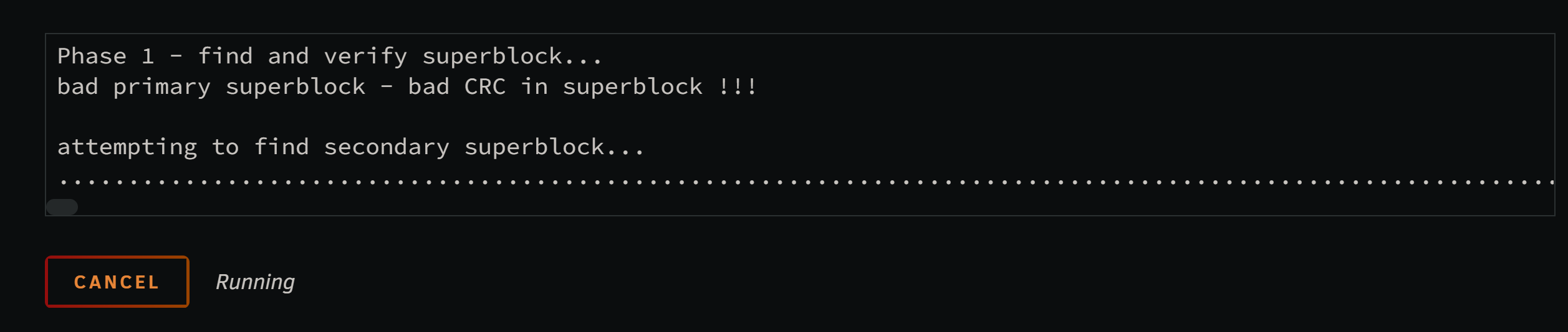

Check filesystem on disk12, are you sure disk13 had a filesystem before? No valid filesystem is being detected, and even forcing xfs doesn't work meaning it's not xfs, or it's not there any more.
I have initiated the check on Disk 12, its been running for a few hours, will report back tomorrow or when it completes.
That's not a good sign...
Its still running and nothing has changed. what does it mean? Do u think its better for me to format these drives using xfs and then rebuild it with the 2 parity drives i have?
