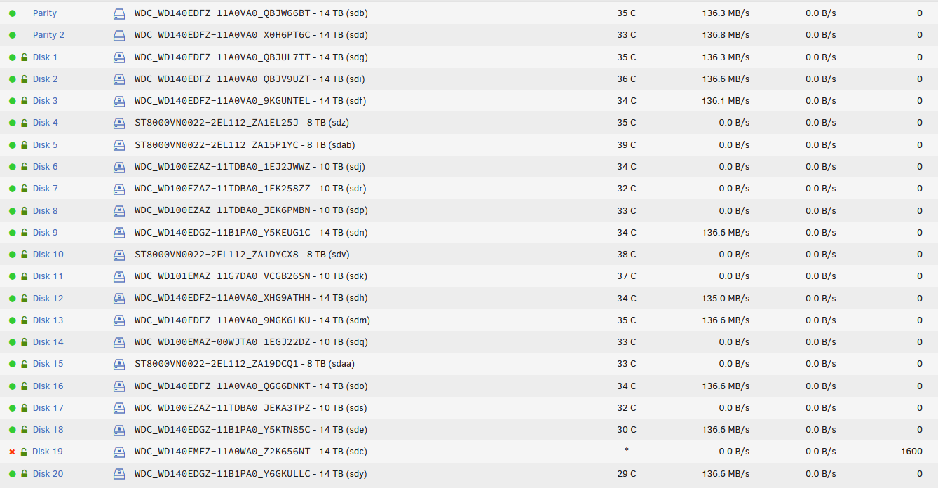

HDD failed during parity check
yes, disk20 was formated and data is written to it.
If I decide to re use disk19, it will be as a new hdd anyways. I'd guess rebuild is as usal, stop server, plug hdd, with array stop replace hdd and restart array.... it should do it's thing ;-)
Just reviewed your diagnostics and I now see that it does have contents. Since it was added later it shows up at the bottom of df instead of after disk19.
I noticed today everything is ok (8To HDD are not spinning anymore), parity continues to work normaly. it seems to be a bug with the display in the array operation.
Try refreshing the GUI, it might be past those drives.
