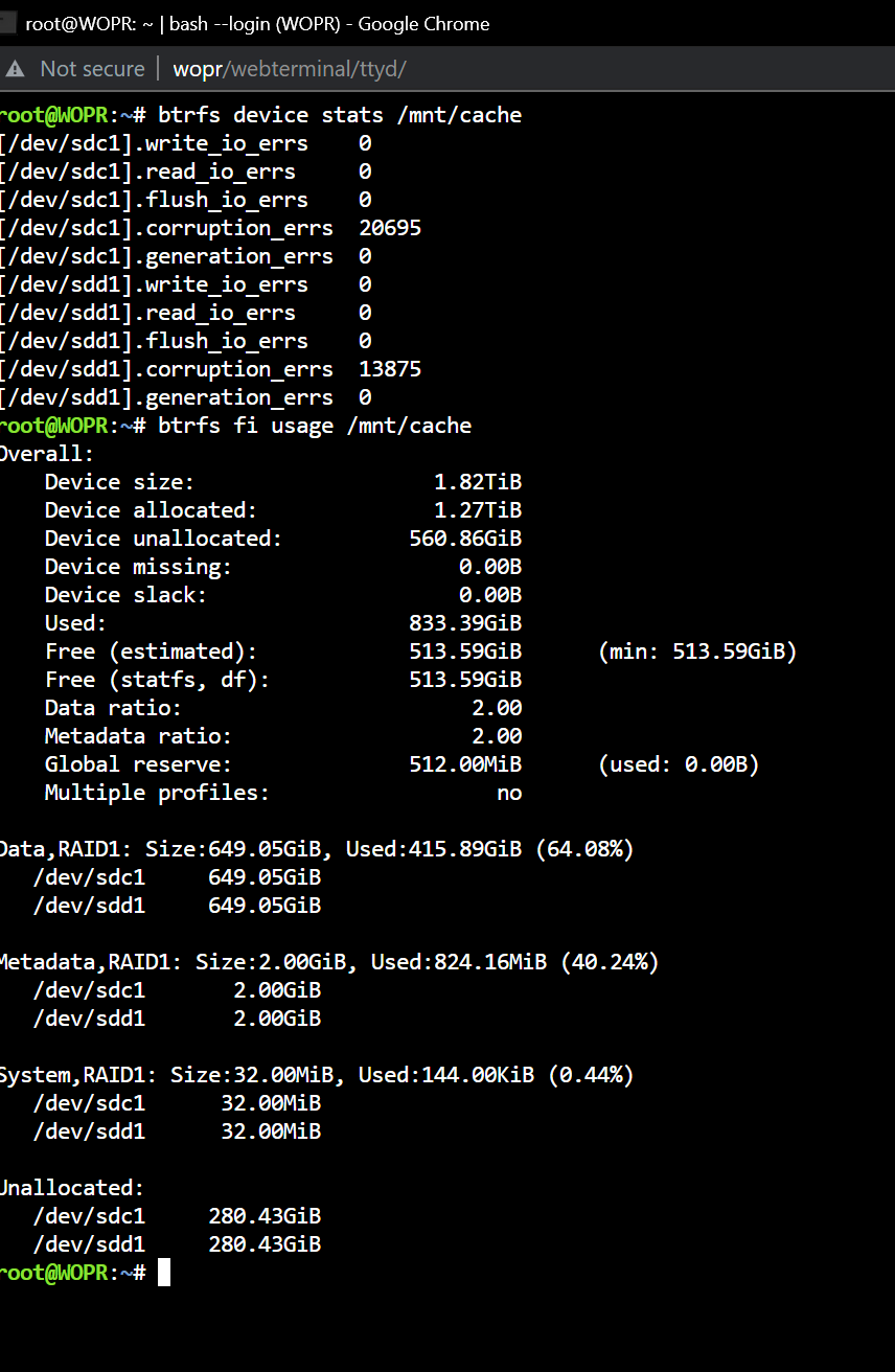

Does this info below help at all?

Additional info
I already saw that in the diags.
