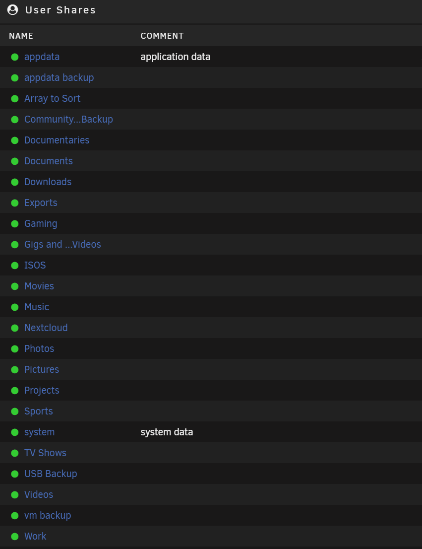

Check if you have a lost+found share now

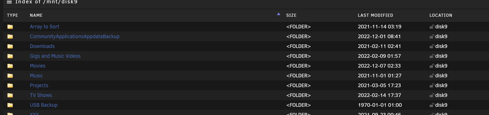

Nothing on the shares list, do I need to use terminal? Krusader also can't see one in the media folder where all other shares are.....
Also not on disk 9 itself
