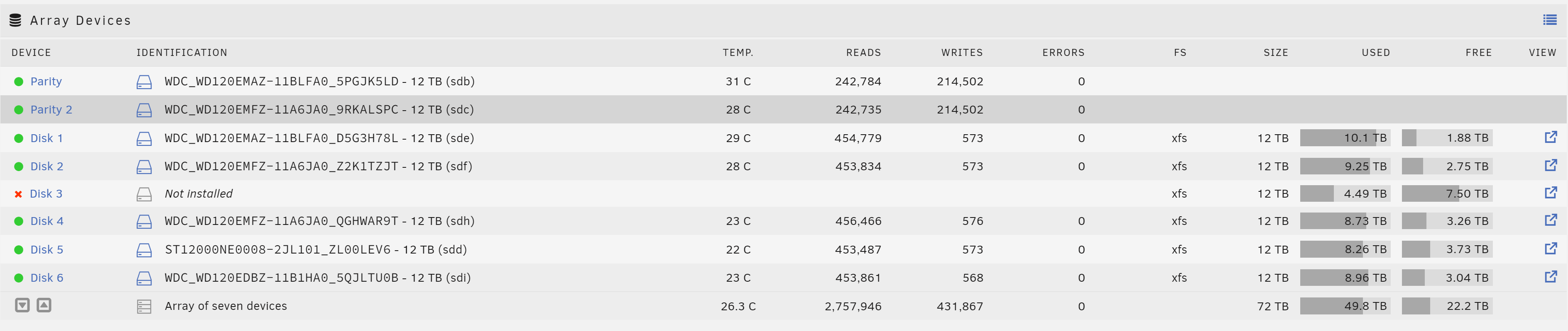

I had a drive (Disk 3) that looked like it was starting to fail (bad sectors), so i replaced it (Disk 6).
I've still got a shadow of Disk 3 in the array devices which i would like to remove but i'm a little apprehensive about doing so, in case i lose data - will it delete data from the parity / what is the best way to remove this stub without losing data?

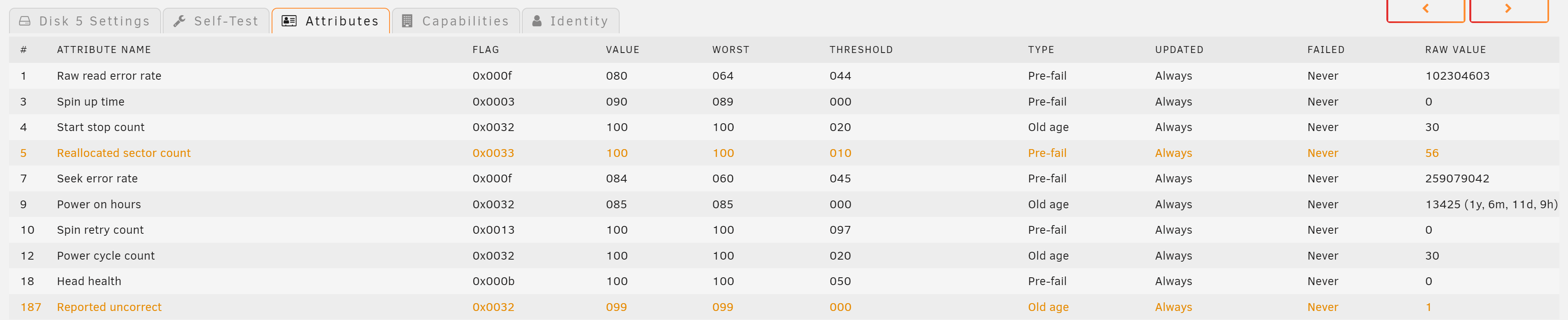

Secondly i have another drive (Disk 5) which is now showing bad sectors, which i have bought another drive to replace.image.thumb.png.10c72f055d5a57230c8cd337a355c930.png

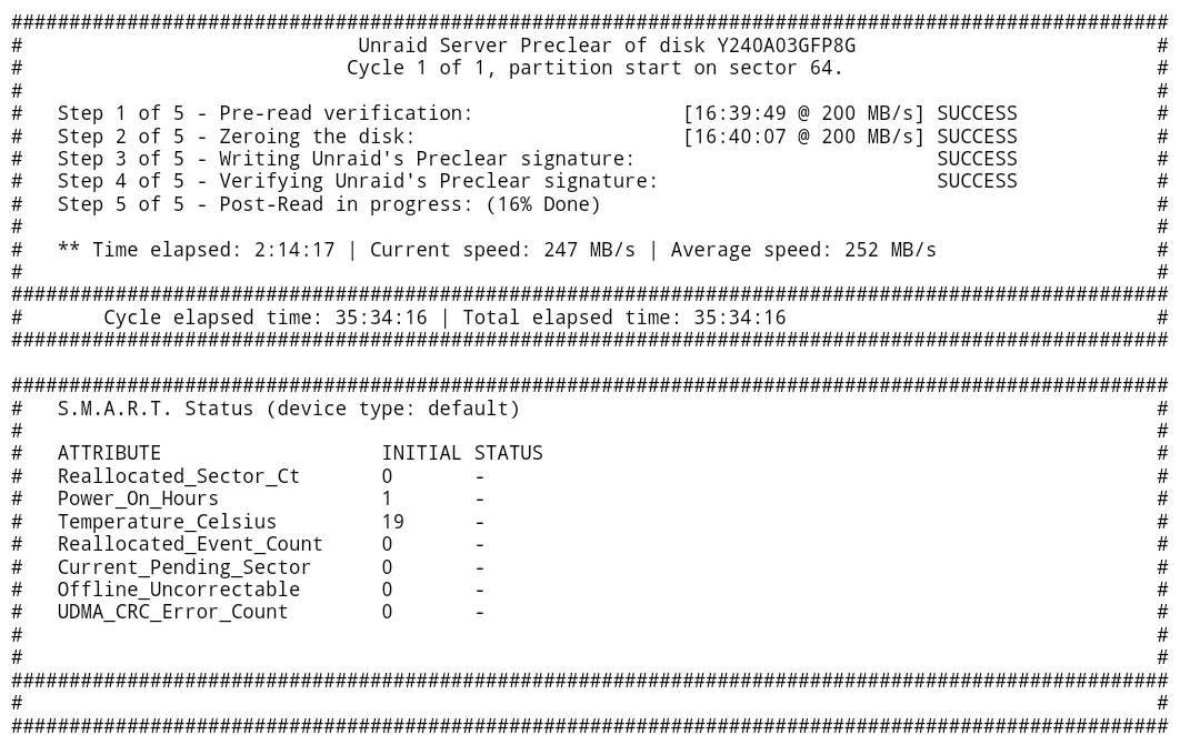

I have just started a preclear on the new drive to replace Disk 5, so this will take a little while.  I was wondering if this was still the most up to date process before adding a drive to the array and what the best process is to replace a failing drive.  I guess i could just pull it, add the new drive into the Disk 5 slot and let the array rebuild, but this would put me at risk should parity drive fail during this process.  I think this is why i didn't chose this way to replace Disk 3 at the time.

That wasn't a replacement. That was adding a new disk6 and not doing anything at all about the disabled disk3. If you didn't have dual parity, it wouldn't have even let you add a disk when another disk was already disabled.
According to that screenshot, disabled/emulated disk3 is mounted and has 4.49TB of data. You have to rebuild disk3 or you will lose that 4.49TB of data on disk3.

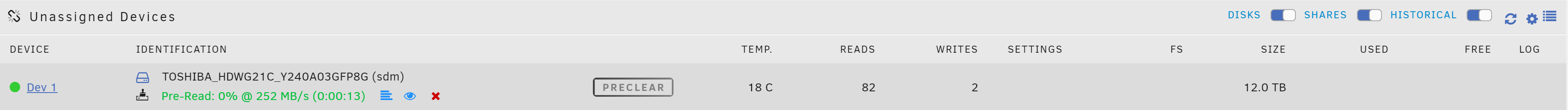

Just to add, the new drive is at 4% Zeroing.

Original disk3 failed extended self-test so it should definitely be replaced.
Serial Number:    9RKB9HLL
# 1  Extended offline    Completed: read failure       90%     17004         1341797320
Disk5 recently passed extended self-test and those SMART attributes aren't terrible unless they begin to increase.
Do any other disks have SMART warnings on the Dashboard page?
If parity check is going OK probably disk5 is fine, since original disk3 is no longer in the array it isn't involved in parity check. Just let parity check continue.
Probably disk5 will be OK at least until you rebuild disk3 to that preclearing disk.

PreClear has completed.
Post new diagnostics just to check if all is still working well before rebuilding disk3.

I thought that might be the case - nothing showing within fix common problems to indicate other issues but defiantly have more errors on Disk5 now.  Once the rebuild has completed (now at 82%) i'll do some tests on Disk5 to see if i should replace it.

Ok so here are the results of running an extended test on Disk5.  I think given the 187 Reported_Uncorrect 1 showing then it's due for replacement...?
