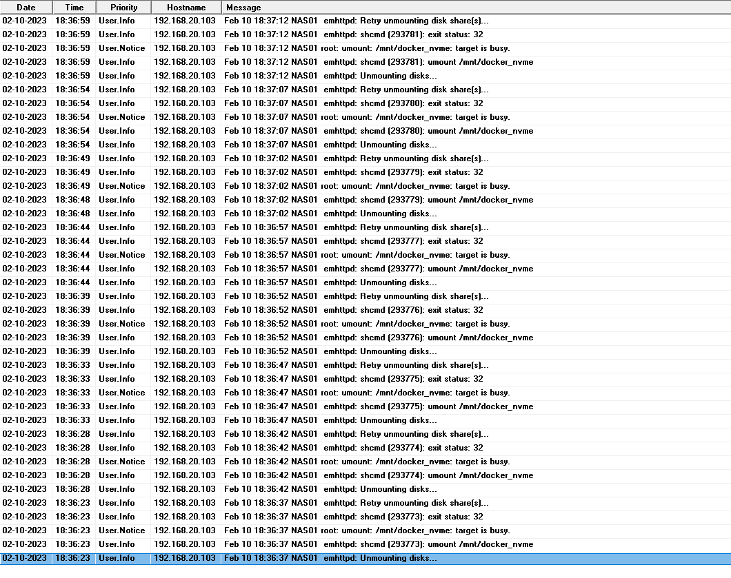

I've setup a syslog server
It could explain why I always have a parity check when I reboot ?
Yes.
