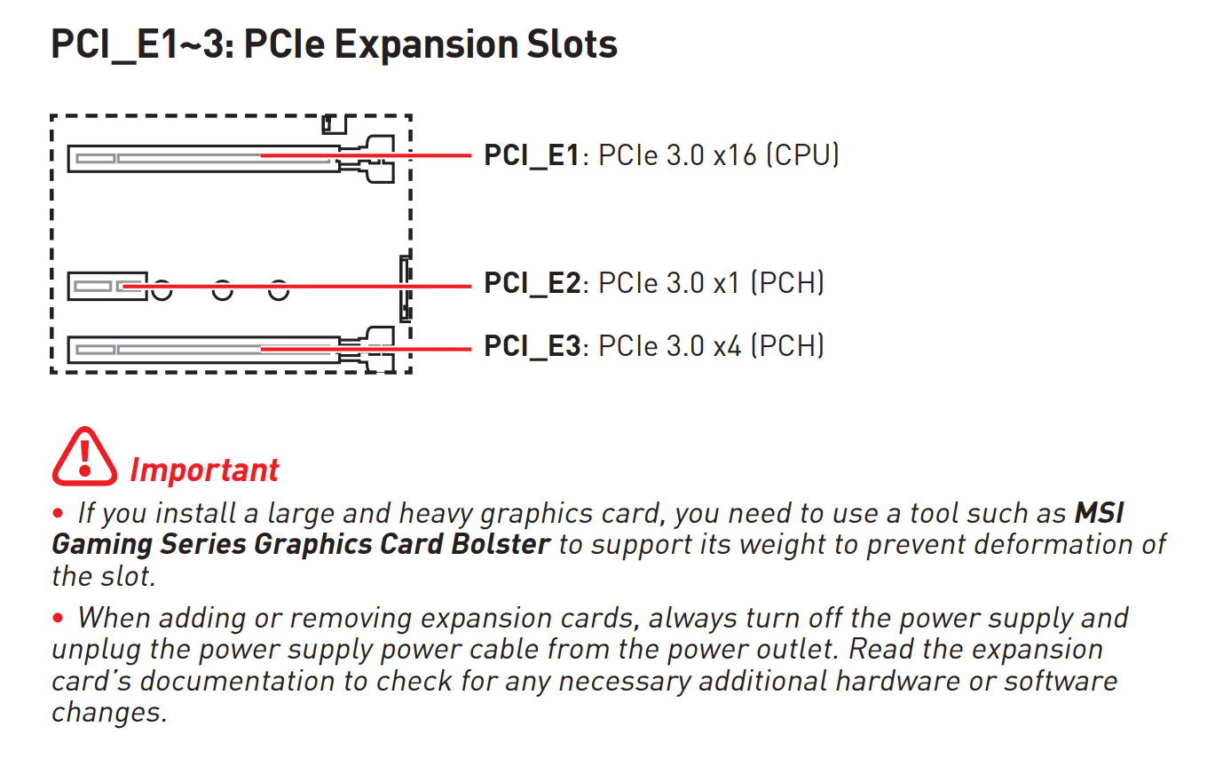

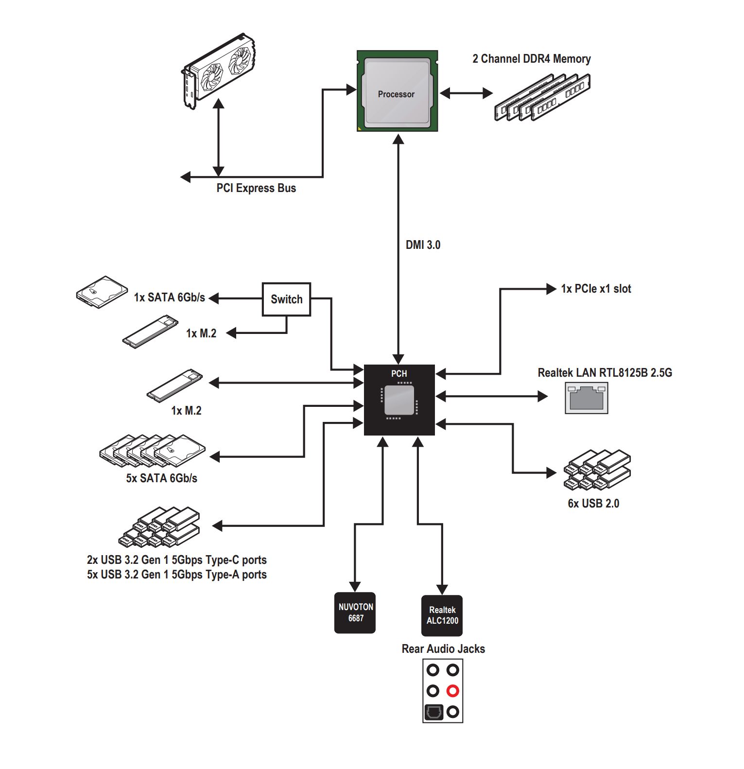

I think the issue you are going to have is that only one PCI slot is connected to CPU other two are via the PCH which also include the NIC and even with acs override is cannot break up the connections enough. Is the Mellanox is PCI_E3?
So likely to be a motherboard hardware constraint.
Edited by SimonF
Indeed, it was on PCI_E3. I switched it now to PCI_E1 and now im getting error when trying to start the VM with the card.
