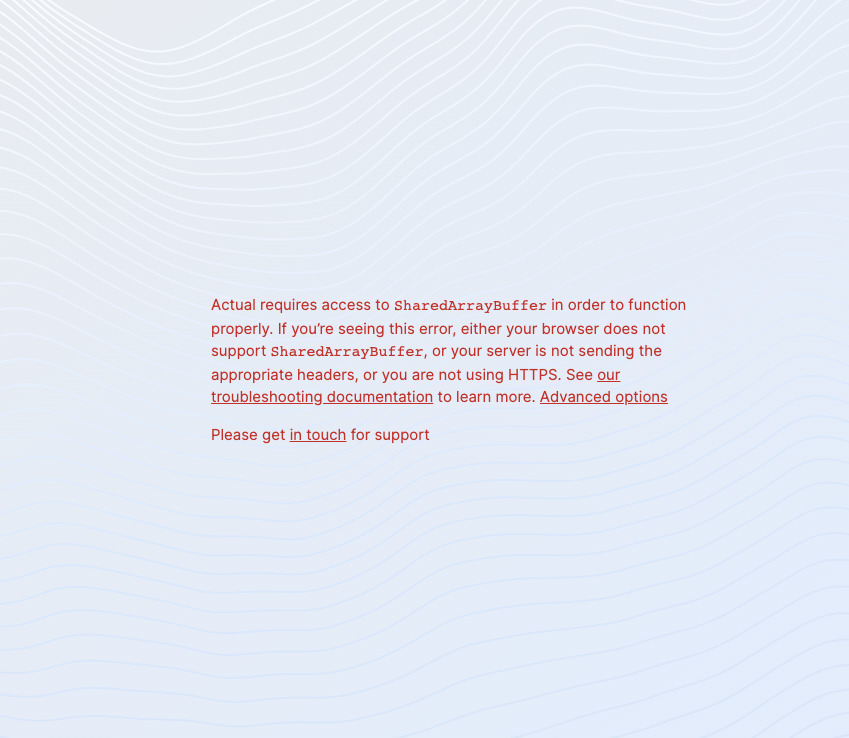

April 16, 20233 yr Author On 4/14/2023 at 11:53 AM, BoKKeR said: Is there a special way to run this? I try accessing 5006 and get If you click on the troubleshooting documentation link it'll explain it a bit. Basically you need HTTPS set up. However, you can click on the Advanced options link and you can get around but just make sure you don't have 2 tabs open at the same time.

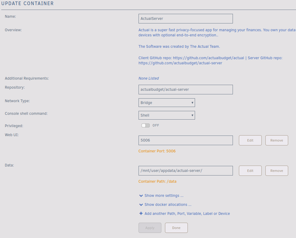

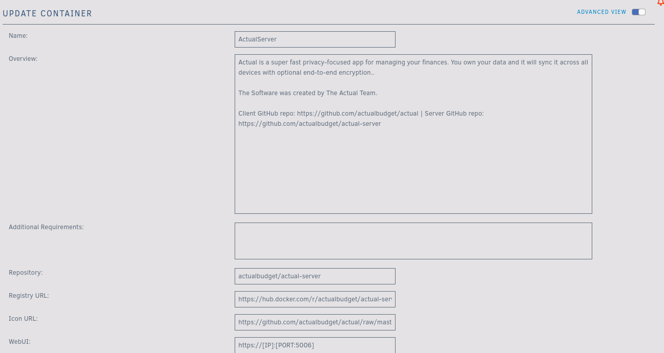

September 22, 20242 yr I don`t know why but the documentation on how to set up HTTPS was not working for me. If anyone else is runing into this problem, here is what I did: 1) I changed the mounted paths in the unraid docker configuration. I had to delete the two pathes for server und user and added just one data path < 2) Under advanced view I changed the WebUi URL to HTTPS 3) Following this documentation https://actualbudget.org/docs/config/https/ I created the selfhost.key and selfhost.crt with the given openssl command, I created the config.json with the listed lines and put all three files into the mounted /data path /mnt/user/appdata/actual-server/ After restarting actaul it is now working with ssl but I have to confirm the not trusted self created ssl key Edited September 22, 20242 yr by bubiman typo
February 18, 20251 yr Thanks @bubiman! Going into advanced setting and changing the WebUI to https was the part I was missing! Now, if someone could explain the process of getting rid of the not trusted bit like you did, that'd be great.

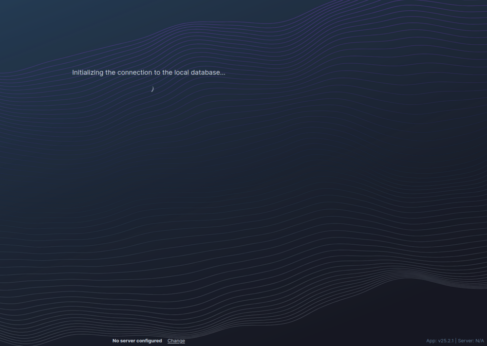

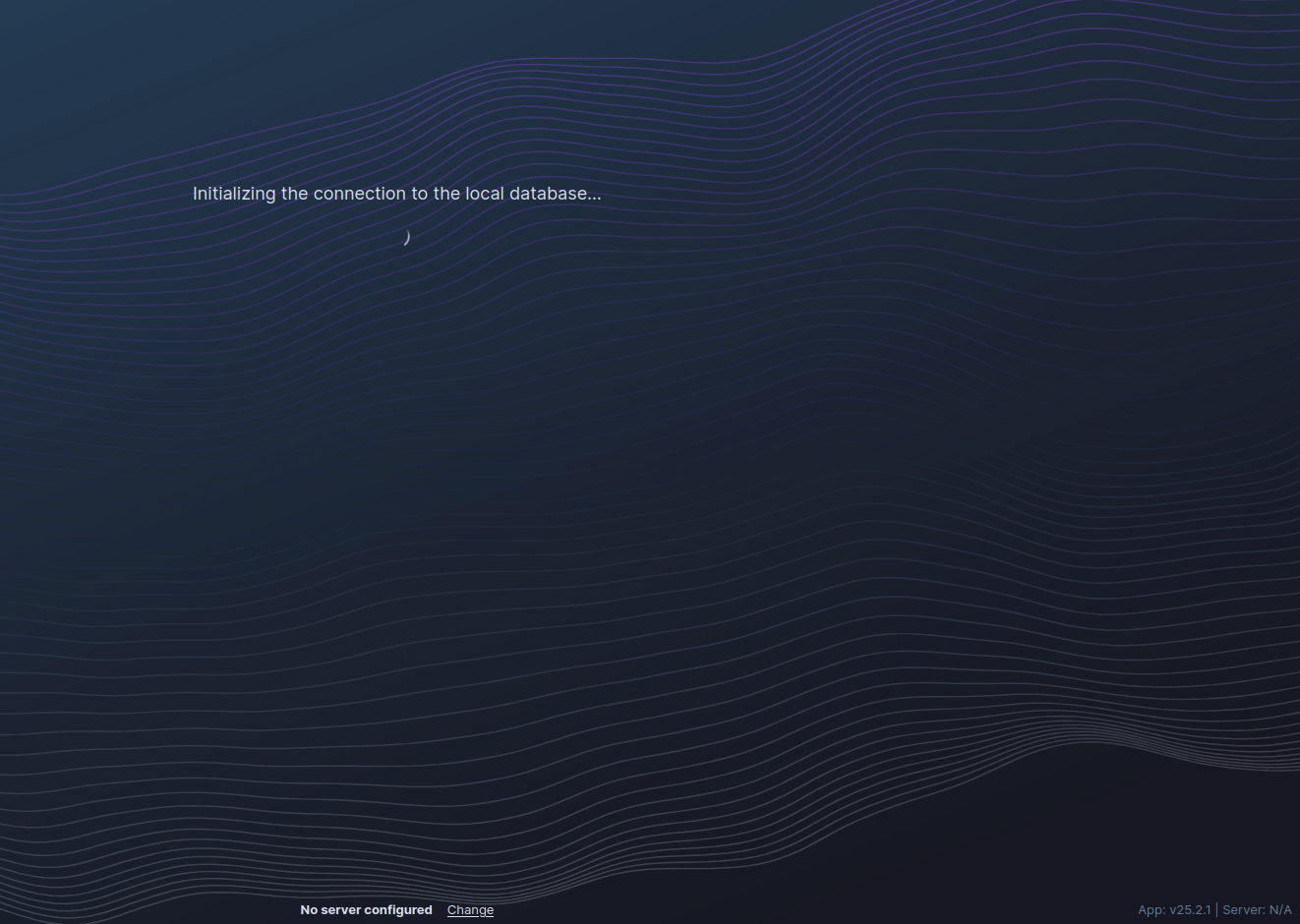

February 18, 20251 yr I'm on my second attempt to setup the server, the https tripped me up originally, but after trying to getting it working, then removing it a few months ago, it seems to be ok, I think. I am running into an odd situation where it's trying to connect to the DB, but based on the bottom right, it doesn't look like the server was setup. I can try and change/configure a server, but that link results in a similar page. I've added the var DEBUG = actual:config,actual-sensitive:config, but that hasn't helped determine anything, I don't see anything in the logs.
March 30, 20251 yr You can switch to the edge version of it, then it works. Actual should be accessed via HTTPS, but you can run it in the "unsafe" mode with HTTP. https://github.com/actualbudget/actual/issues/2893 https://actualbudget.org/docs/troubleshooting/shared-array-buffer/
