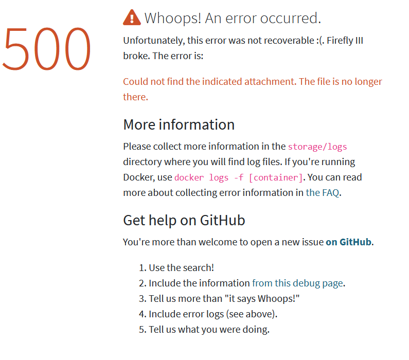

  6. Thank you for your reply! Sorry, but it has been a busy week over here. How can I change the container path? Do I have to use the console for the container and look for a specific file? I tried to look for more info, but I couldn't find anything related . ------ My bad. I had to click the edit button in the container, specifically in the Upload_Path. I was over complicating things. After doing that, I don't see any files so it means I lost everything I uploaded. In my case, it doesn't really matter as I keep a backup. Any suggestions for future update to avoid this issue?
  7. Thank you for your assistance @FunnyPocketBook. I did have a a previous version installed before, so I believe than can be the problem. I tried to look for the attachments in my host path (`/mnt/user/appdata/firefly-iii/upload/`) but I think I'm doing something wrong as there are no files in there, even new PDFs attached a couple of hours ago (see the image below). Btw, I don't mind loosing the attachments as I also use Paperless-ng (another nice app from here) for backing up PDF. However, I'd like to avoid this issue in the future. Thank you for your comments!
  8. Hi, first I want to thank you the people behind the docker version of Firefly III. I've been using it for three months so far and I loved the fact that I can also attach the receipts of most of my transactions. However, I can't recall from what version I'm having the following issue. When I try to open an attachment uploaded from a previous version I get error 500, but if I attach the a receipt in the current version I can access it with no problem at all. It seems to be that all the attachments from previous versions are under this error 500. As I'm not literate enough, I'll provide as much data as possible: 1. Screenshot of the error is attached. 2. Log of a successful receipt that I can access: 192.168.3.201 - - [20/Apr/2021:00:19:02 -0400] "GET /attachments/view/37 HTTP/1.1" 200 147085 "-" "Mozilla/5.0 (Windows NT 10.0; Win64; x64; rv:87.0) Gecko/20100101 Firefox/87.0" 3. Log of a receipt that gives me an error: [2021-04-20 00:16:28] local.ERROR: Exception is: {"class":"FireflyIII\\Exceptions\\FireflyException","errorMessage":"Could not find the indicated attachment. The file is no longer there.","time":"Tue, 20 Apr 2021 00:16:28 -0400","file":"\/var\/www\/html\/app\/Http\/Controllers\/AttachmentController.php","line":247,"code":0,"version":"5.5.8","url":"http:\/\/192.168.3.220:9090\/attachments\/view\/32","userAgent":"Mozilla\/5.0 (Windows NT 10.0; Win64; x64; rv:87.0) Gecko\/20100101 Firefox\/87.0","json":true} [2021-04-20 00:16:28] local.ERROR: Exception when mailing: Mailer [] is not defined. [2021-04-20 00:16:28] local.ERROR: Could not find the indicated attachment. The file is no longer there. {"userId":1,"exception":"[object] (FireflyIII\\Exceptions\\FireflyException(code: 0): Could not find the indicated attachment. The file is no longer there. at /var/www/html/app/Http/Controllers/AttachmentController.php:247) Any suggestion or comment is going to be appreciated Thank you!
