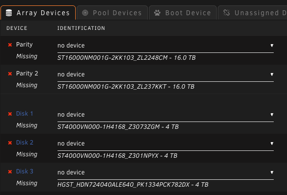

After stopping array and rebooting server, the devices are showing up as 'missing' and I can't unassign the slots, nor can I start the array.
Any suggestions please?
n3supernas-diagnostics-20230304-0801.zip
Edited by itlists
I would suspect something that is common to all these drives.
Things that occur to me is the power cabling and if they are attached to an HBA whether that is properly seated in the motherboard.
