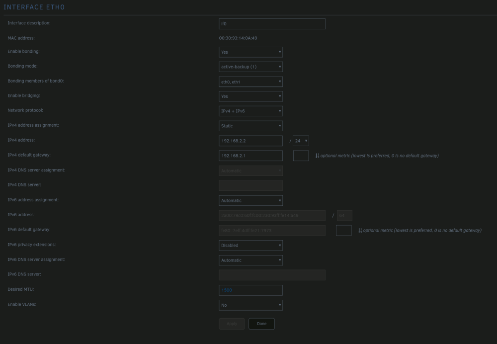

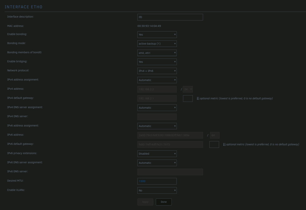

1. It does not retrieve a DNSv4 or DNSv6, only one network 192.168.2.0/24, all other devices work normally, and retrieve DNS servers.

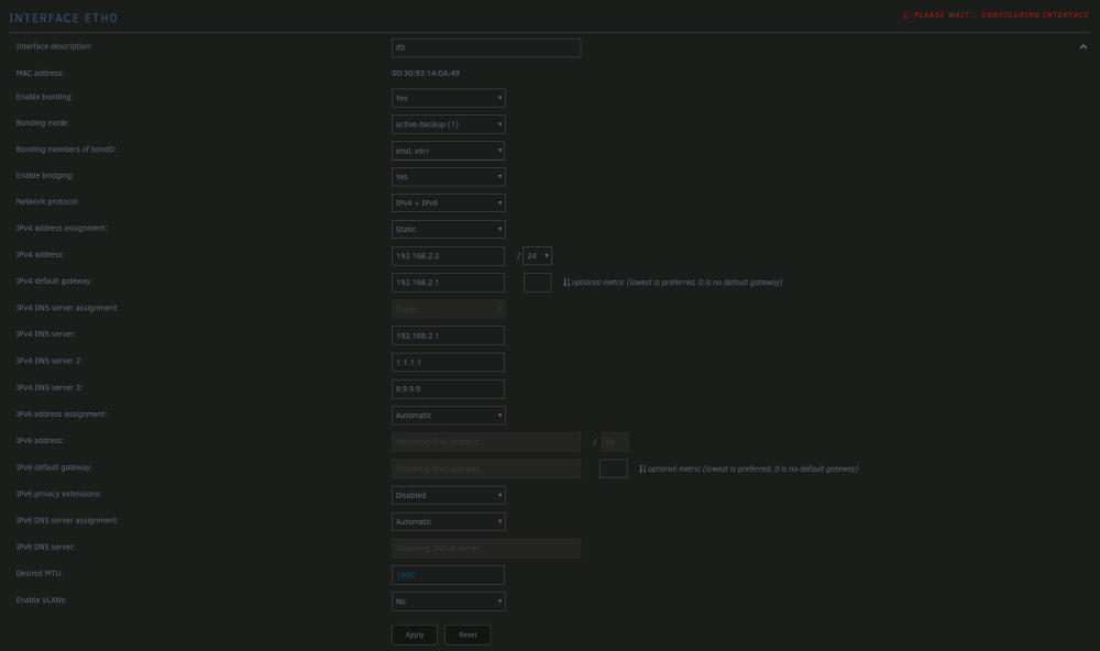

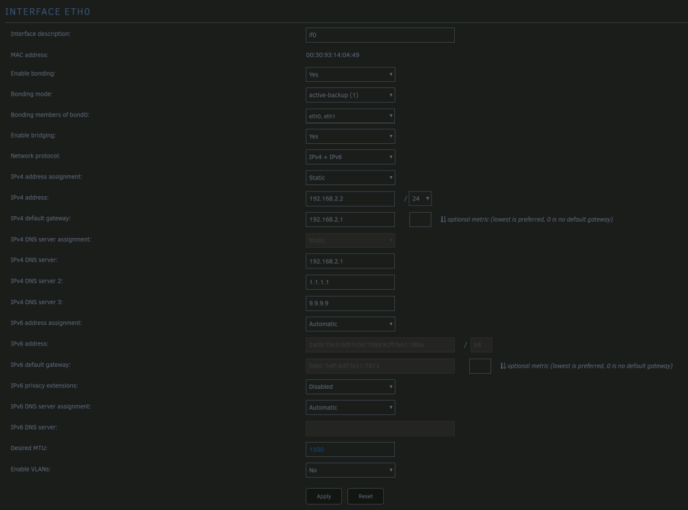

2. When I try adding a DNS manually, it reverts back to automatic, with the static entries not saved, below are screenshots.
I tried it with bonding on, or off, I tried ipv4 only, ETH1 is currently unplugged for troubleshooting. Already did a "docker safe new perms" as I thought maybe some files are not writable.
Notes: 1 harddrive missing (defect, RMA'd it)
Here is how it behaves for me:
Spoiler
1) No DNS Servers
2) Add servers manually
3) apply

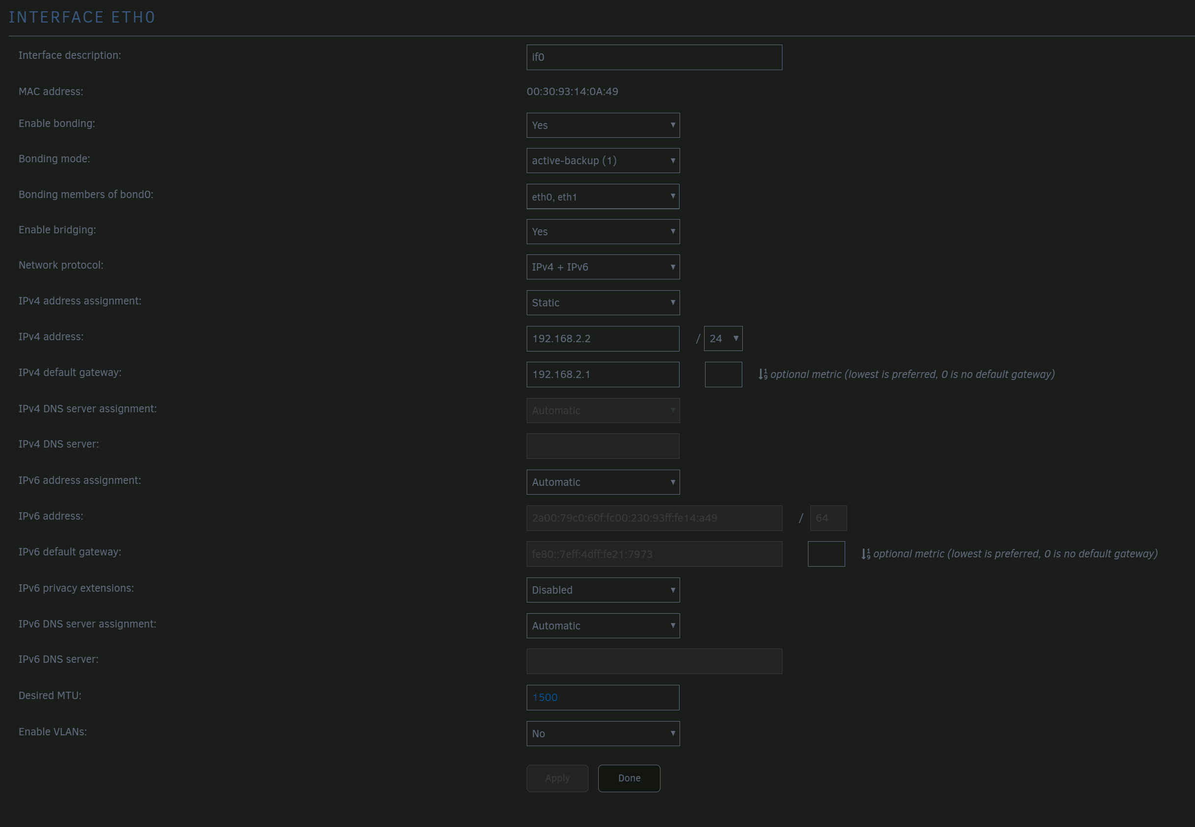

4) revert back to 1)
Ping test:
