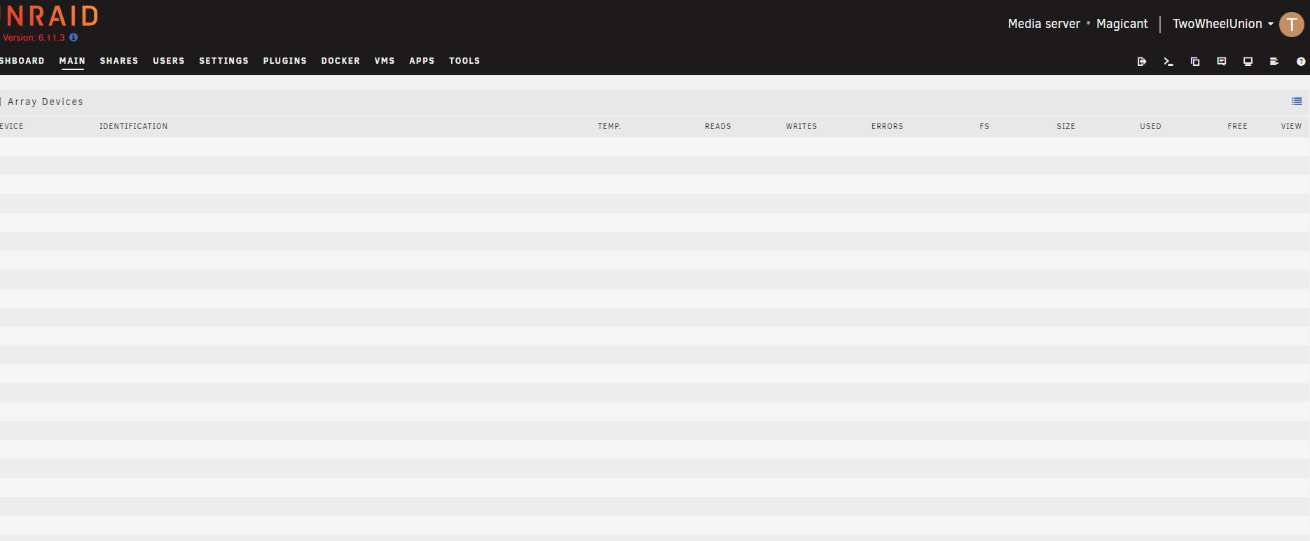

April 20, 20233 yr Hello all, I came home from work and found that when I logged into my dashboard my CPU load was at 0% and none of the bars that show CPU usage are working. I went over to the MAIN tab and none of the array devices are listed. Here's what's weird, I can still access the server thru windows, I moved files and scanned it with Plex and it added the show. It is still playing shows and movies just fine and I am able to move files but nothing is registering on the dashboard. Does anyone know how to fix this? The picture was taken when I was transcoding a video file on Plex.
April 21, 20233 yr Community Expert A reboot should fix it, see if you can get the diagnostics before, or at least the syslog.
