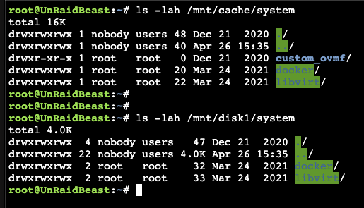

What do you get from the command line with this?
ls -lah /mnt/cache/system
and this?
ls -lah /mnt/disk1/system

The Proxmox server backs up my proxmox nodes nightly at 24:00hrs
Is it started only then, or is it always started?
Take a look at those docker and libvirt folders on cache and disk1. See which you want to keep and which you can get rid of. In the end you want them all on cache and none on the array.
The VM is always on. Only actively read/write at 24:00hrs
Since it won't fit on cache it will have to be on the array but don't  be surprised if it keeps the disk spunup.
Simpler if you make a separate cache:no share for it
