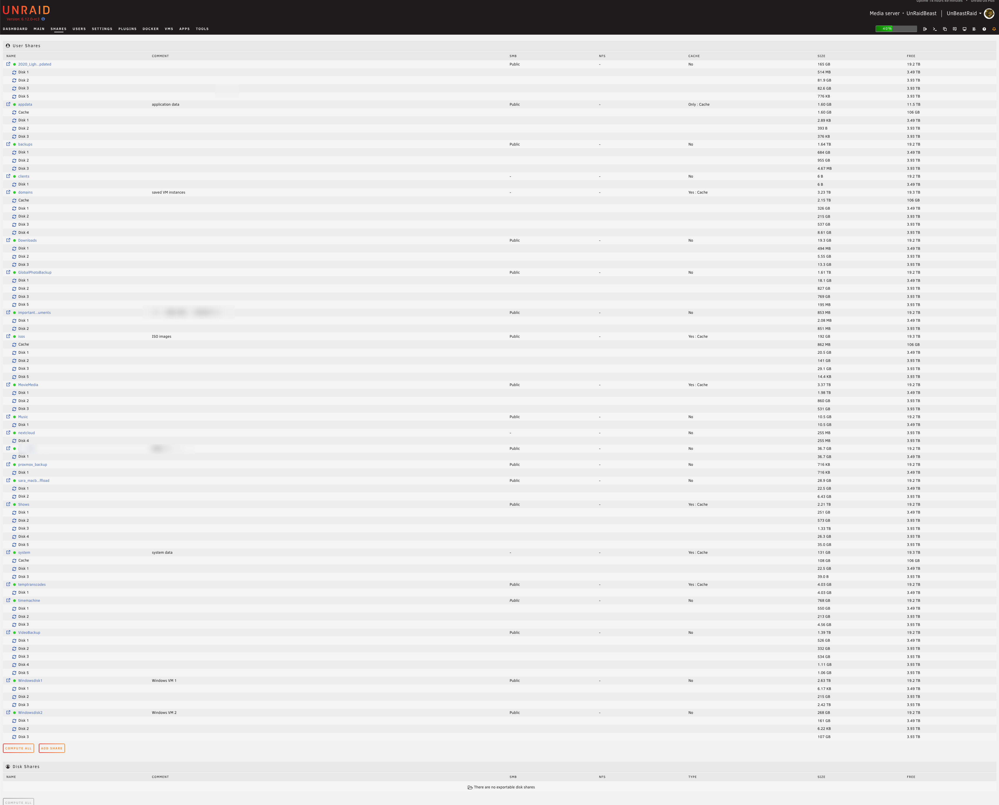

Go to User Shares page, click Compute All at bottom, wait for the complete results, post a screenshot.
Here is the screenshot

Is this correct?
2.15TB on the cache drive for domains...
6 minutes ago, Frank1940 said:
Is this correct?
Embarrassingly so. I had not realized this. Stupid question...does this share store VM images? If not, what does it do? What is the recommended size for this share? Honestly, this share hasn't been touched since I built this server a few years ago.

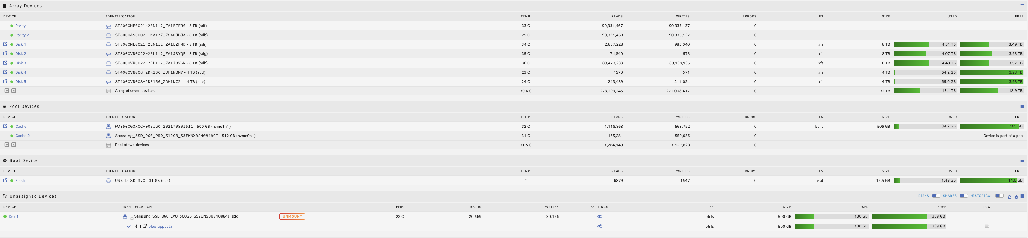

@UnBeastRaid, get a screenshot of the  Pool Devices section of the MAIN tab...
3 hours ago, Frank1940 said:
four ~500GB drives assigned as cache drives
Only 2 cache drives, nvme0 and nvme1. For some reason smart folder in diagnostics often show duplicates for these devices.
These are btrfs raid1 so only 500G capacity. Don't know why or how more than 2TB shows up in domains share on that pool. Maybe something to do with sparse files?
Only 500GB. 2 nvme in raid 1
