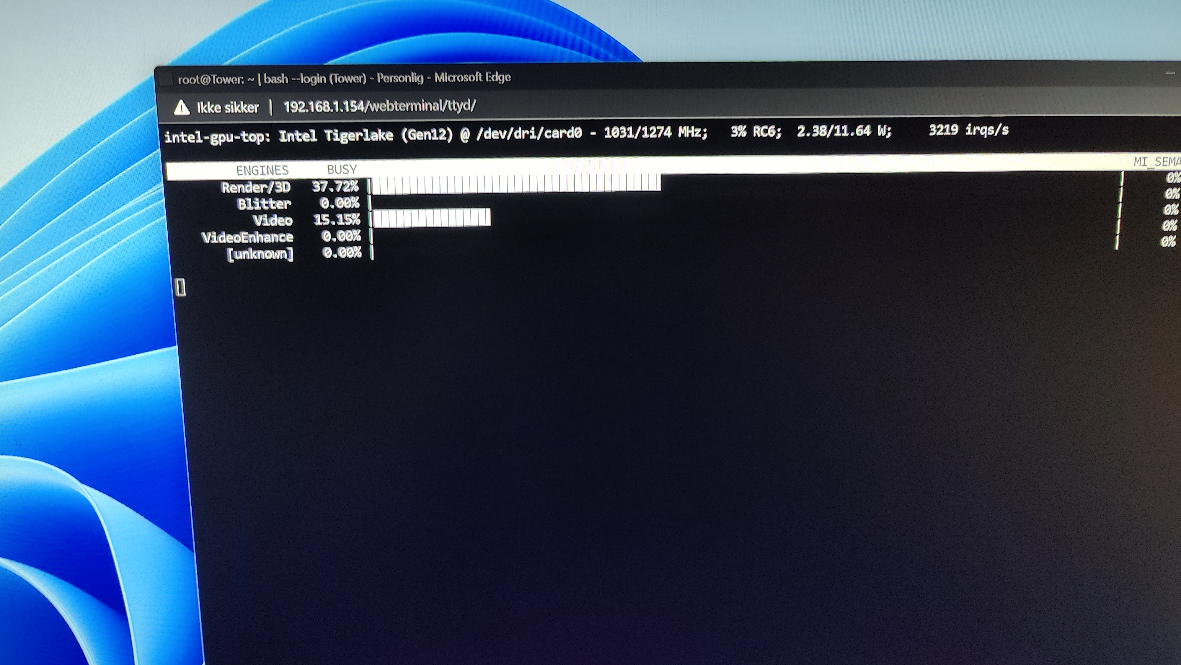

hi gang.
Nevermind. made a complete reinstall :)
Im on a intel nuc generation 11 i7
the first time i installed intel gpu top everything worked fine. Then i rebooted and i get ithis error.
as you can see i have /dev/dri and everything is thee. but i can't seem to getting it work
root@Tower:~# intel_gpu_top
Failed to detect engines! (No such file or directory)
(Kernel 4.16 or newer is required for i915 PMU support.)
Segmentation fault
root@Tower:~# cd /dev/dri
root@Tower:/dev/dri# ls
by-path/  card0  card1  card2  renderD128  renderD129  renderD130
the picture is from fresh install without the first boot

On 4/26/2023 at 9:46 PM, bubbadk said:
hi gang.
Segmentation fault
reinstalled unRAID or intel_gpu_top?
I reinstalled unraid because I thought it was a one time incident. But yesterday I rebooted unraid, and the error was there again. Segment fault.
Hw transcode still works though.. But not Intel_gpu_top

17 minutes ago, ich777 said:
Are you using the SRIOV plugin?
Someone reported this over on GitHub: Click
The Diagnostics from your systems would be really helpful and what is not working exactly.
well these worked fine : intel_gpu_top drm:/dev/dri/card0 intel_gpu_top drm:/dev/dri/renderD128
just not single output : intel_gpu_top
attached diagnostics :)
Please uninstall the SRIOV plugin, reboot and it will work.
SRIOV is in a experimental state and not officially supported by the Kernel:
Source: https://github.com/strongtz/i915-sriov-dkms/blob/master/README.md
uninstalled and it worked.
