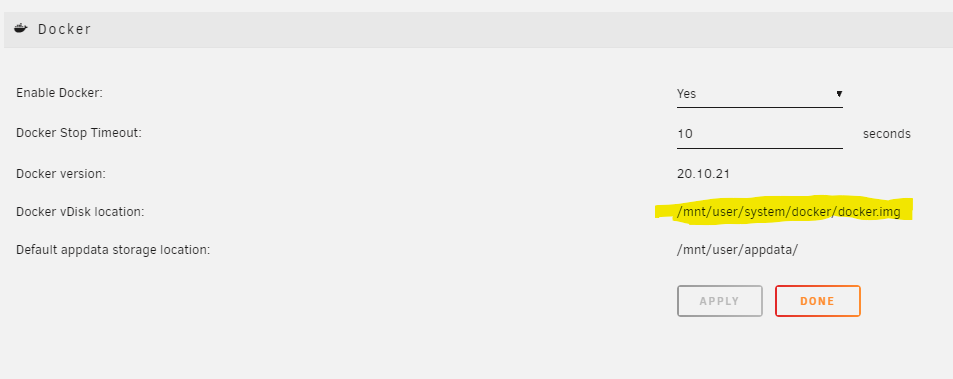

I tried to delete the docker.img file in order to start over but can't find anyway and not even in the location specified in the docker settings
please see my attached diagnostic attached

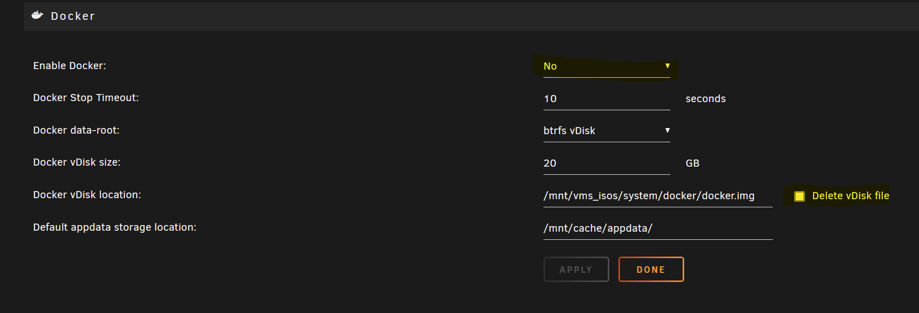

You need to stop the docker service before you can delete docker.img.  You likely have a corrupt docker.img and deleting it is what you need to do.  A new one will be created when you restart the docker service.
@Hoopster thank you for responding. Thank you for pointing out the checkbox, I tried to do it manually via the command line. However, despite stopping the service as I did previously, I still cannot find the docker.img file and everything else is the same in terms of the issues I am facing.
