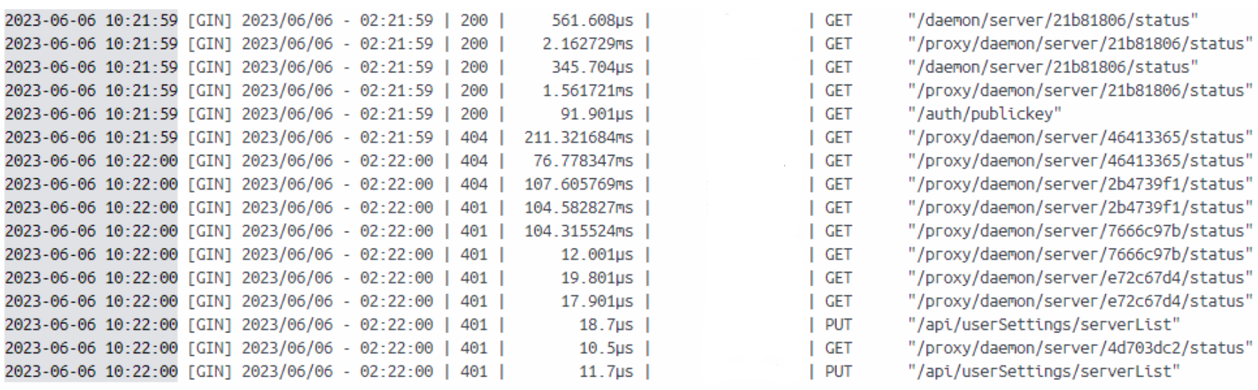

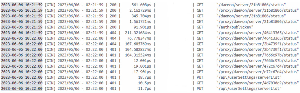

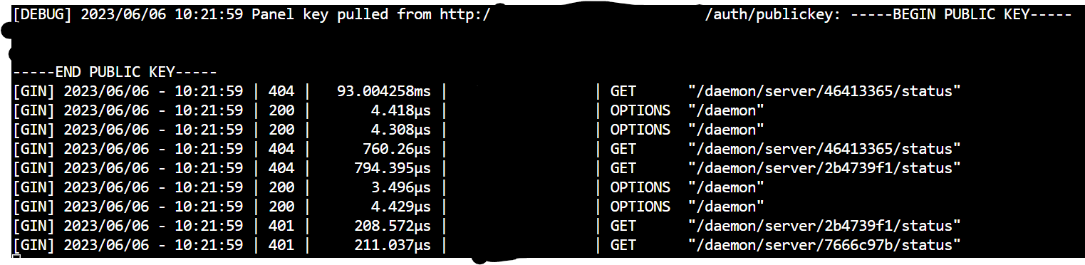

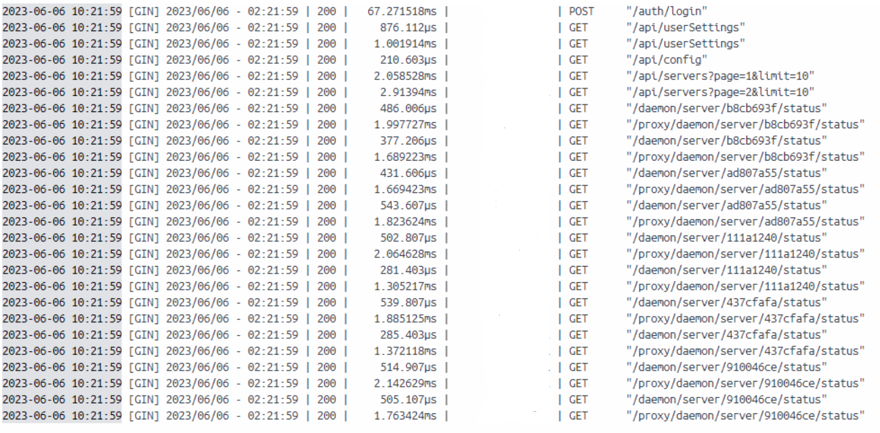

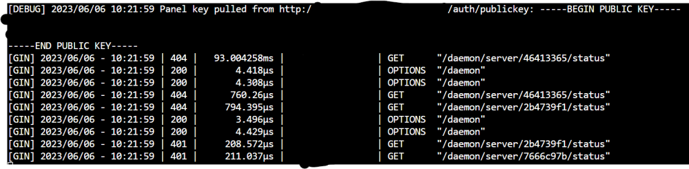

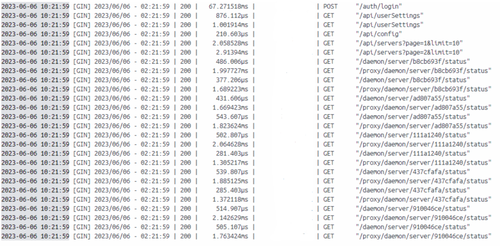

Hey!
I have a master pufferpanel node that is connected to another pufferpanel node on a remote pc. I cannot delete the servers created on the remote node from the master node. So I went into the files and deleted the servers manually. However, when I try to remove the remote node from my master node it comes back with an error that there are still servers connected to the node. Does anyone know how to remove these ghost servers? And also why when I try to delete a server on the remote node it comes back with an error?
Thanks!
I cannot replicate this.
Do you have the logs handy for the container?
Yes, I have attached the logs. I apologise for sending them as a screenshot. I needed to remove private information (ip addresses and web addresses).
Overnight the master pufferpanel instance was taken offline because the computer lost power. I am now getting 401 errors and cannot log into the pufferpanel while the remote node is connected. Before when I sent the previous message in this thread I was only getting 200 and 404 (errors) and I was able to log into pufferpanel when connected to the node.
There are servers currently running on the master panel which cannot be removed. There are no servers in the /servers directory on the remote node. However, the master node still thinks that there are still servers (hence the 404 errors).
Master:
Client:
Edited by corfoto4
