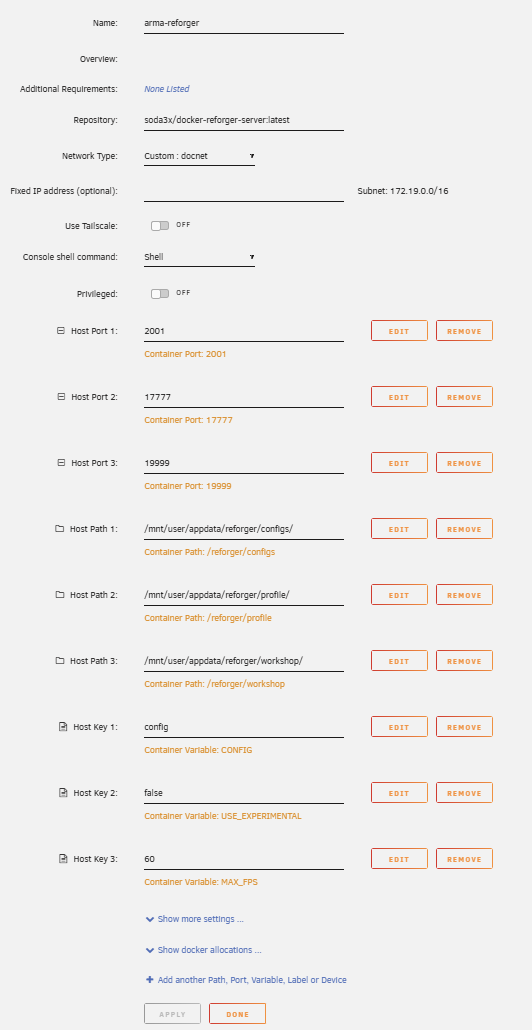

  1. Hoping for some advice on setting up an Arma Reforger dedicated server through docker. I haven't been able to get it working using their wiki and git instructions, and can't figure out why from the container logs - it just stops on boot. containerLog.txt config.json
  2. Scratch this, sorry. Just apparently took a really long time before it'll show in the lists...
