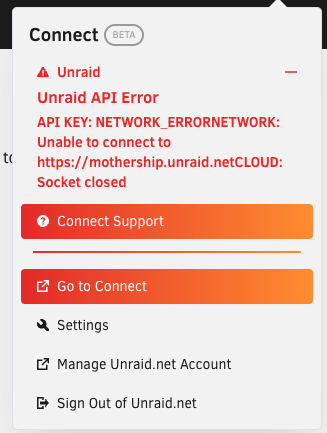

i got these two error suddenly. THe App store is not working. I did try to chnage the DNS. Is used before the one from my Unifi not i changed to 8.8.8.8 same thing.
i also cant connect my server to Unraid connect.
I can ping devices from my terminal.
