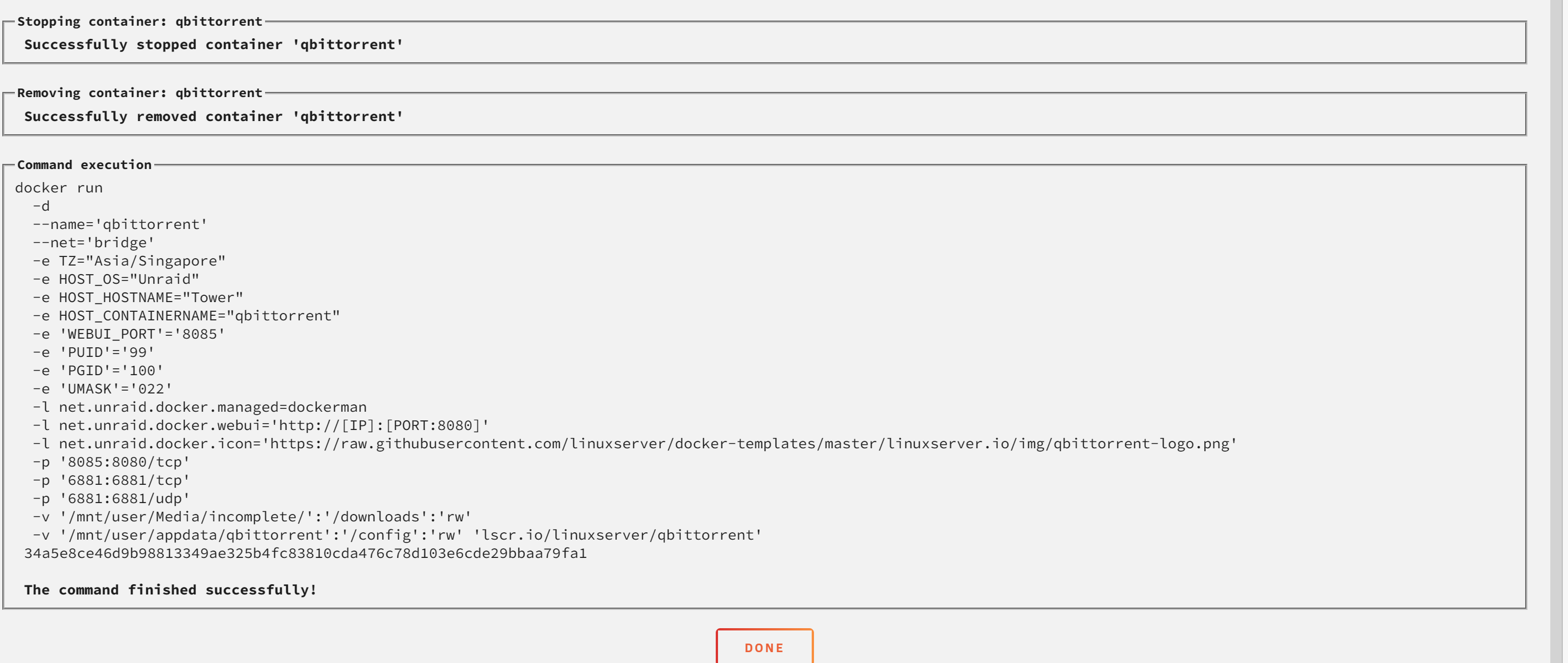

Thanks! here are the two run commands

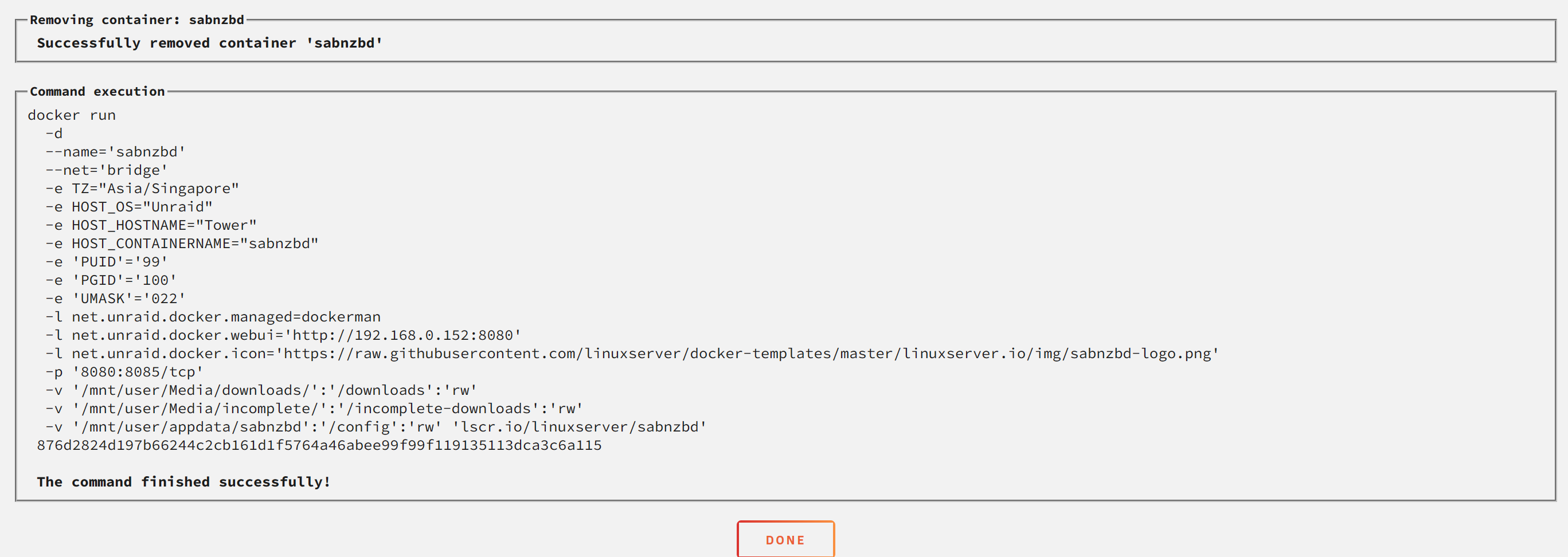

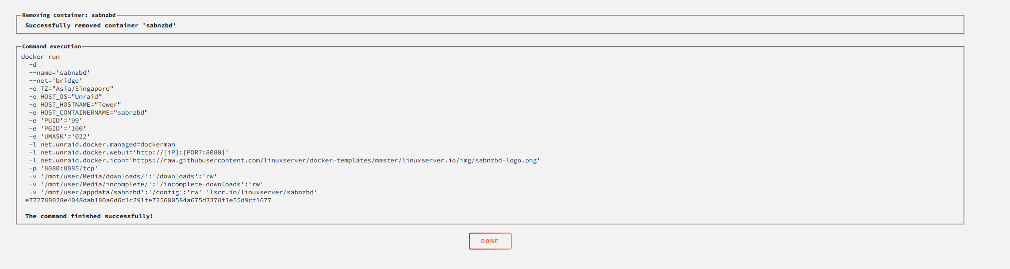

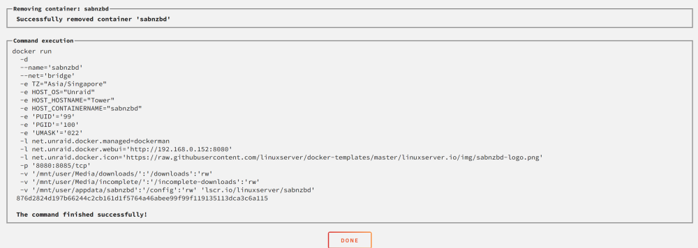

image.thumb.png.b6d19ce28b5190b48413c90163e39818.pngimage.thumb.png.c02c7c7968df90811eca3e634b995c9d.png
Don't know about qbittorent, but the WebUI entry on sab is wrong.  The entry in the template (advanced view when editing) should be http://[IP]:[PORT:8085] and not directly reference the IP address or port being used.
Don't know about qbittorent, but the WebUI entry on sab is wrong.  The entry in the template (advanced view when editing) should be http://[iP]:[PORT:8085] and not directly reference the IP address or port being used.
Actually the web UI entry was originally as you say and it didn't work with that setting, editing it was one of my attempts to get it working and I forgot to change it back.
