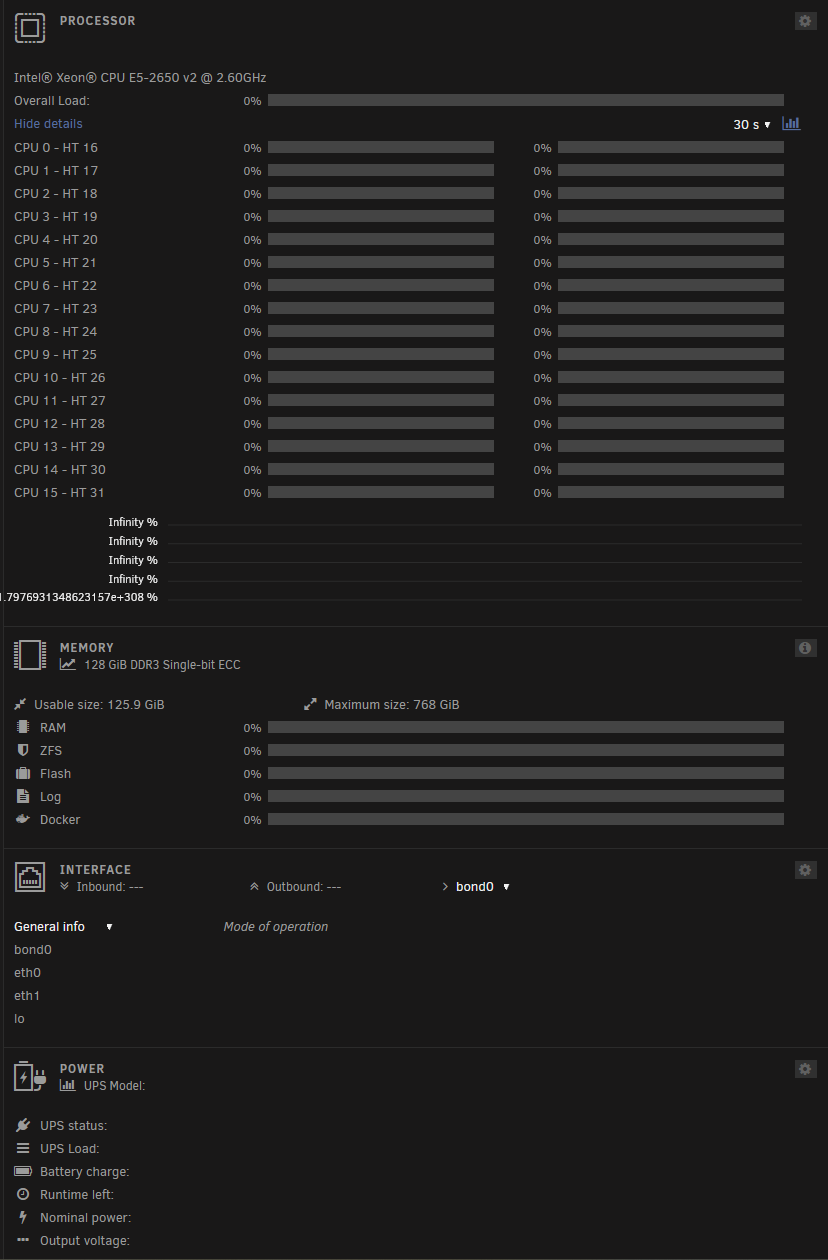

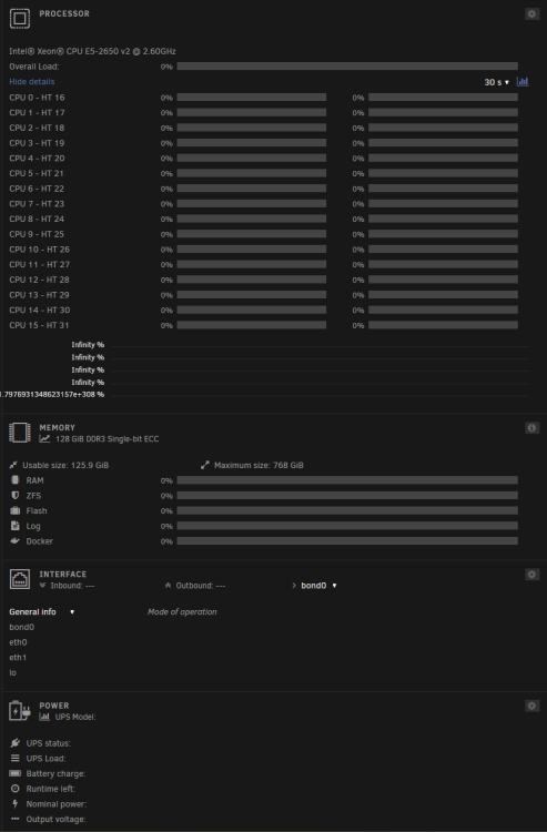

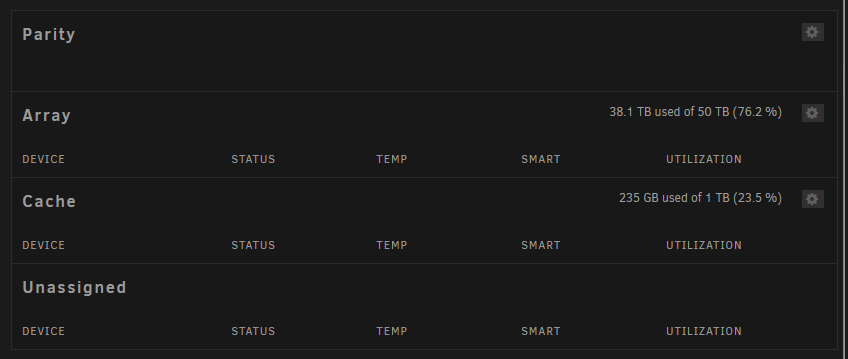

Since two days (before was running just fine) the dashboard doesn't fetch the data for:
CPU
RAM
NETWORK
UPS
PARITY
ARRAY
CACHE
UNASSIGNED
Does somebody know what / where the problem could be?

I upgraded to 6.12.4, had some more issues which look to be network related.
anyway I enabled VM manager just now and the CPU Graph isnt working, see screenshot.
I then re-enabled, confirmed the CPU graph was working then generated a diag as requested.
