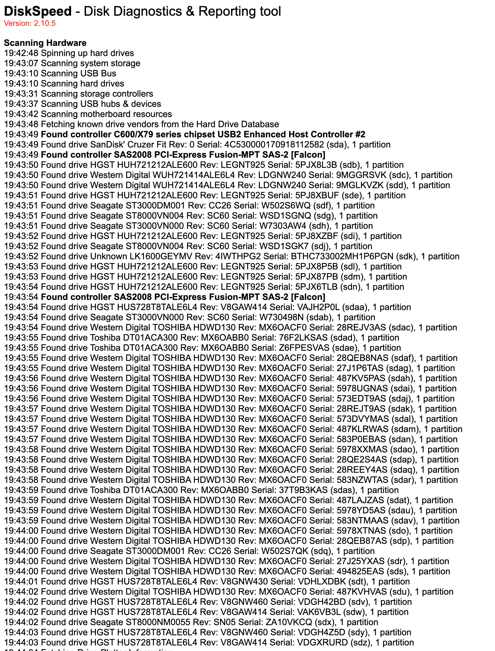

But I have done the Disk Speed test in docker ,the result shows the slowest one is 90mb/s ,and its not the disk in the array but the unassigned device which even did not mounted...
So is there any other reason I can make some improvements.

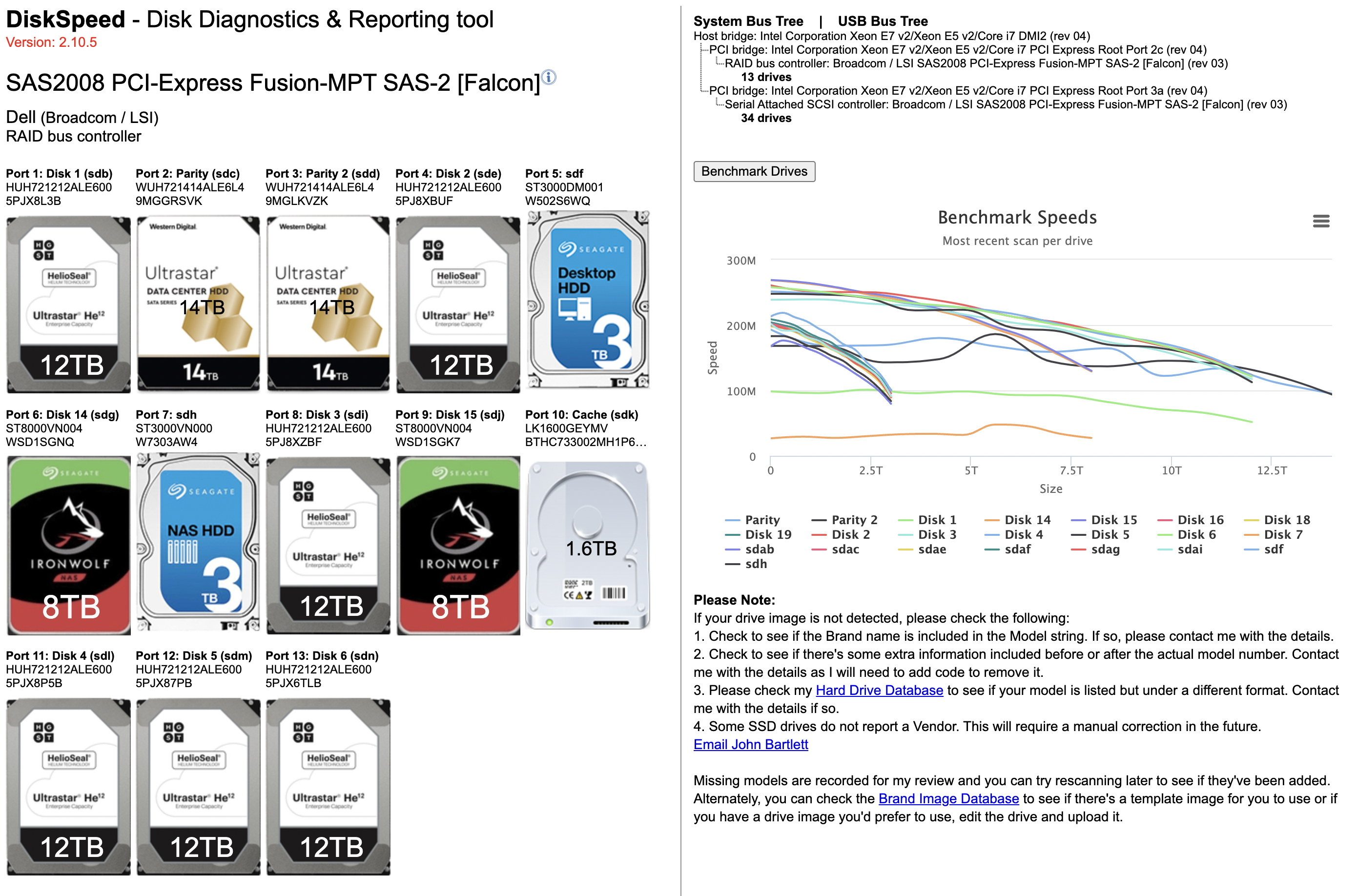

here is the disk connection map
Host bridge: Intel Corporation Xeon E7 v2/Xeon E5 v2/Core i7 DMI2 (rev 04)
PCI bridge: Intel Corporation Xeon E7 v2/Xeon E5 v2/Core i7 PCI Express Root Port 2c (rev 04)
RAID bus controller: Broadcom / LSI SAS2008 PCI-Express Fusion-MPT SAS-2 [Falcon] (rev 03)
     13 drives(left 13 in the picture ,main disks in parity sync situation)
PCI bridge: Intel Corporation Xeon E7 v2/Xeon E5 v2/Core i7 PCI Express Root Port 3a (rev 04)
Serial Attached SCSI controller: Broadcom / LSI SAS2008 PCI-Express Fusion-MPT SAS-2 [Falcon] (rev 03)
     34 drives

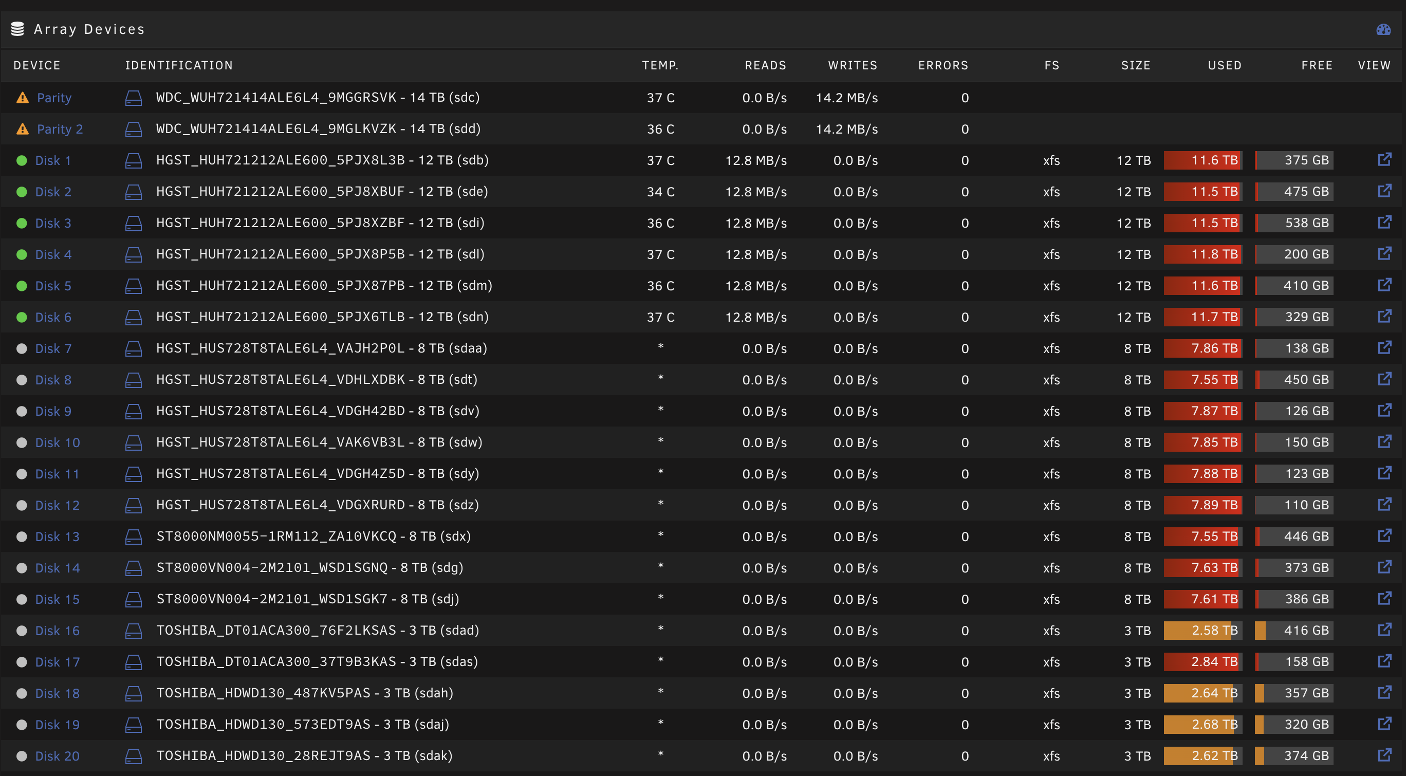

and it is going down to 14m/s ……
I cant figure out why this is happening ,all the 8 disk(2parity and 6 data disks) are in the first bus, and no background app is running .
This doesn't say how they're connected. So you have 13 drives connected to an 8-port card, and 32 drives connected to another 8-port card? That means you have expanders, and it's precisely what's between the controllers and drives in terms of hardware and cabling that's needed. Obviously there'll be some bandwidth sharing at play here.
the 13 drive is in a Dell R720XD server rack ,and the another 34 is in a supermicro disk chaise ,connect with SFF-8088 cable and hba card .

Run a controller test with the diskspeed docker to confirm no controller bottlenecks.
