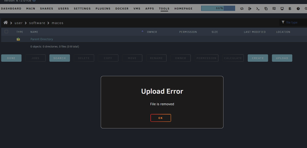

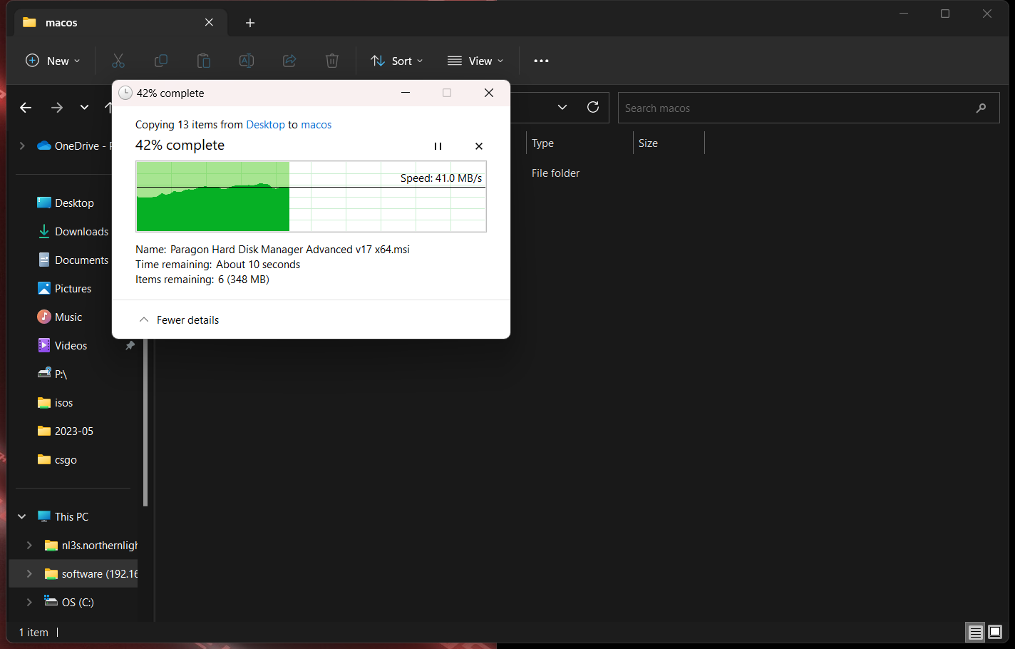

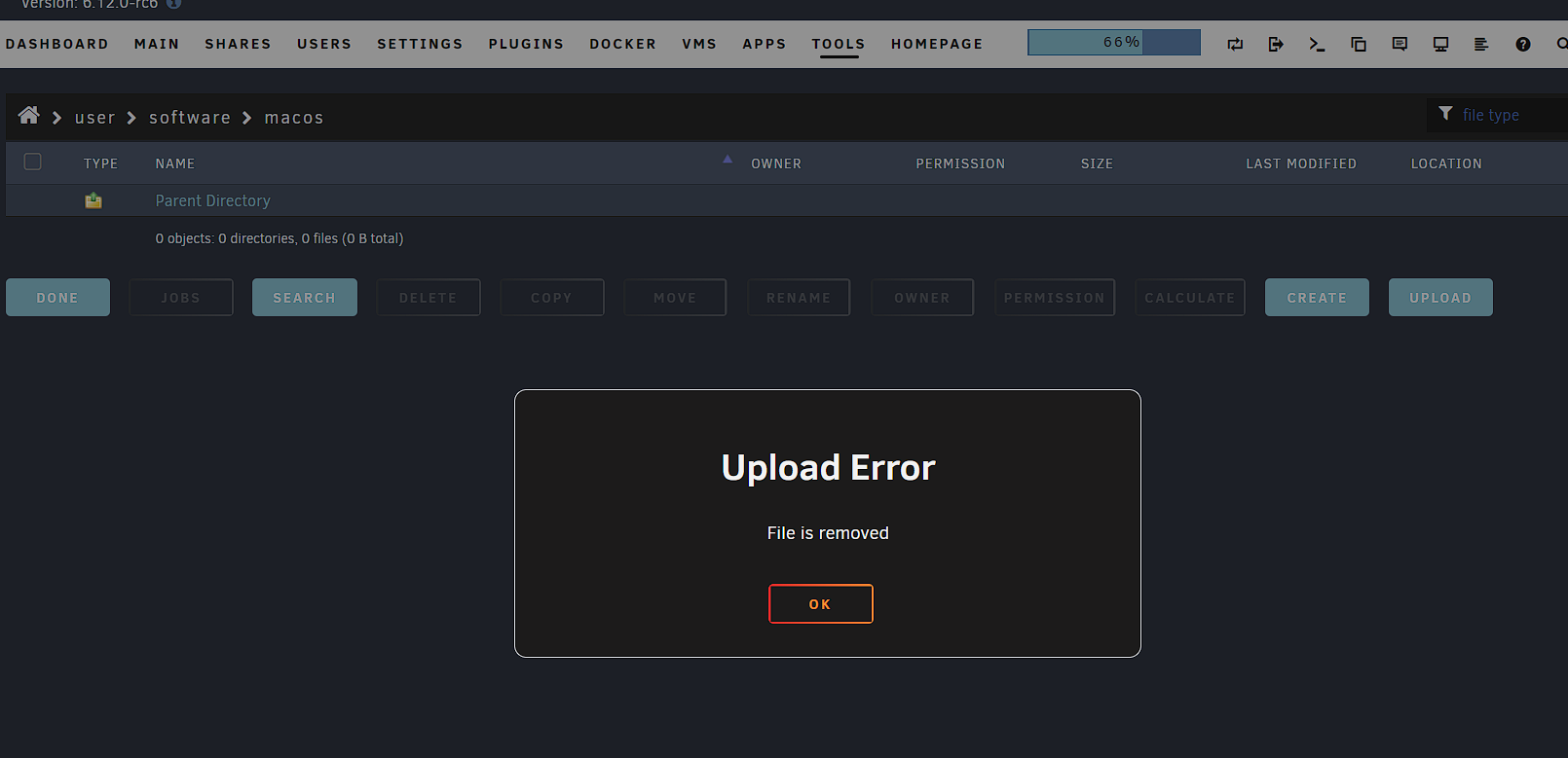

Hello everyone, mine UNRAID was working fine but today I got a serious problem where none of my files can be uploaded to the server anymore. I've been trying to use docker "File Browser", plug-in "Dynamix File Manager", as well as the WEBDAV & SMB sharing from windows, but none of them works.
When I was trying see the syslog, it appears that the system was reporting:
May 29 19:24:56 NorthernLight3s shfs: command failed: 1
Anyone has any idea?

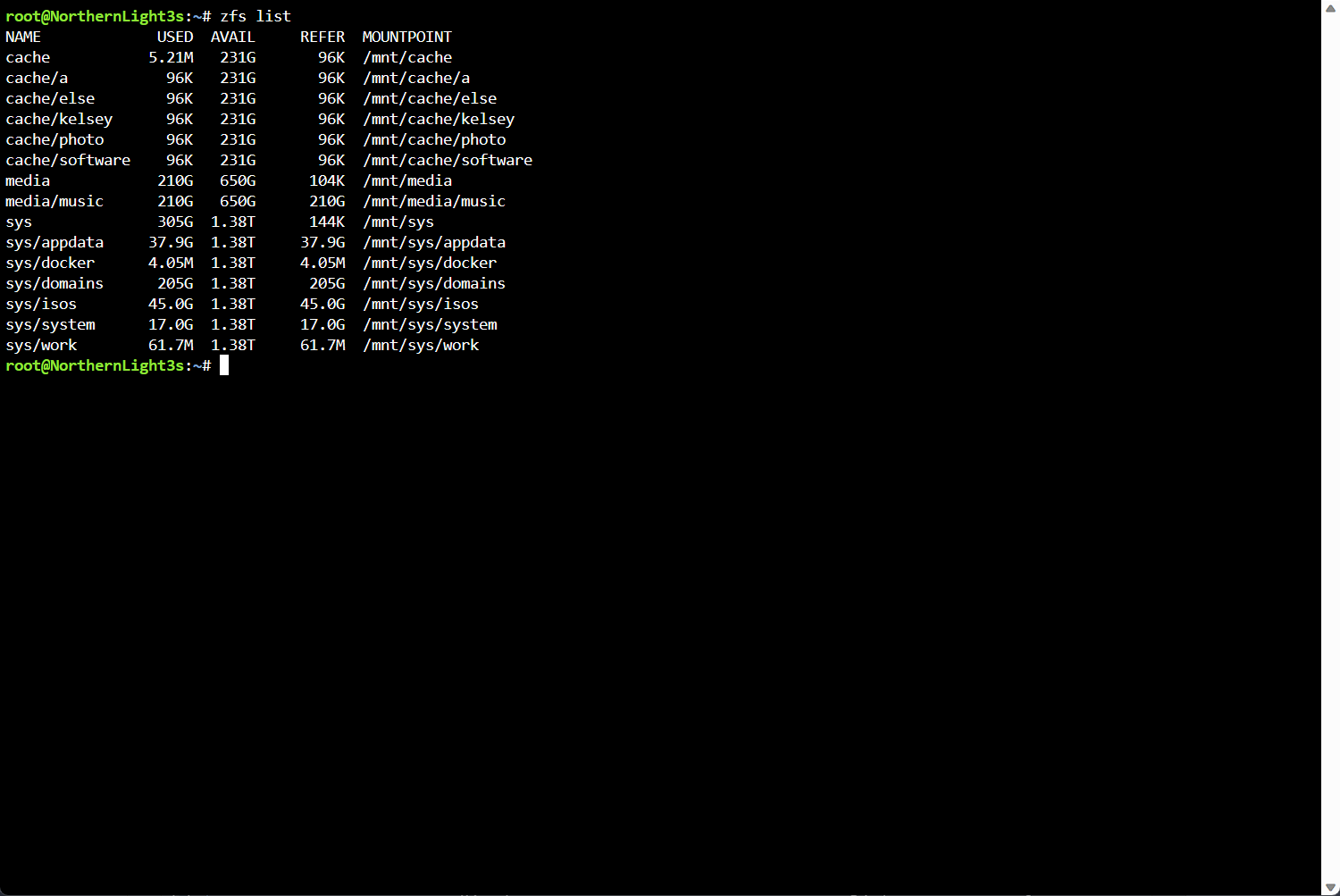

Please post output of
zfs list

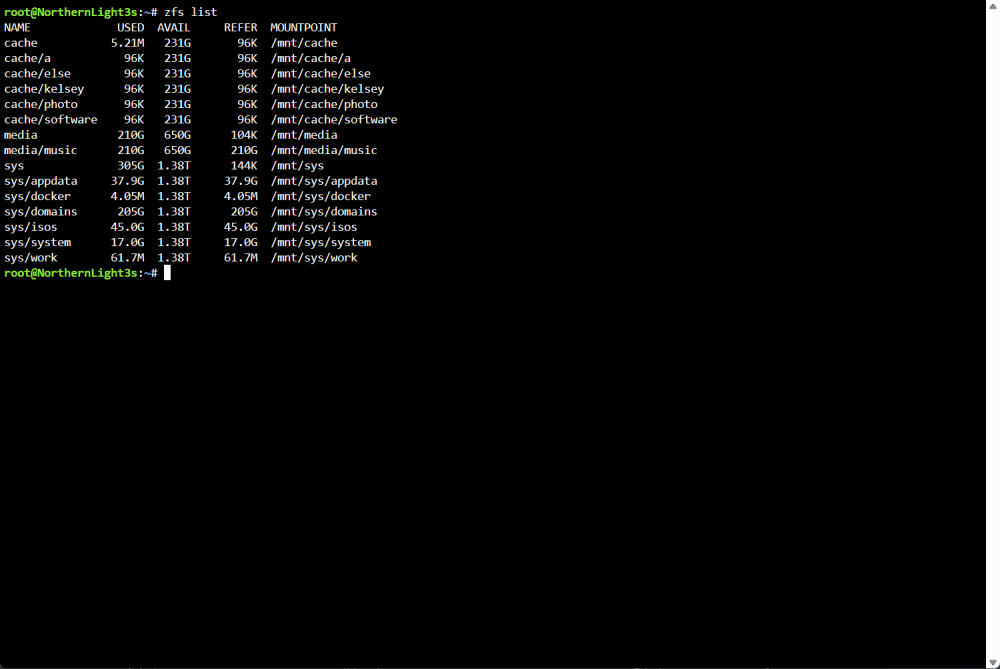

Here is the out put:
NAME             USED  AVAIL     REFER  MOUNTPOINT
cache           5.21M   231G       96K  /mnt/cache
cache/a           96K   231G       96K  /mnt/cache/a
cache/else        96K   231G       96K  /mnt/cache/else
cache/kelsey      96K   231G       96K  /mnt/cache/kelsey
cache/photo       96K   231G       96K  /mnt/cache/photo
cache/software    96K   231G       96K  /mnt/cache/software
media            210G   650G      104K  /mnt/media
media/music      210G   650G      210G  /mnt/media/music
sys              305G  1.38T      144K  /mnt/sys
sys/appdata     37.9G  1.38T     37.9G  /mnt/sys/appdata
sys/docker      4.05M  1.38T     4.05M  /mnt/sys/docker
sys/domains      205G  1.38T      205G  /mnt/sys/domains
sys/isos        45.0G  1.38T     45.0G  /mnt/sys/isos
sys/system      17.0G  1.38T     17.0G  /mnt/sys/system
sys/work        61.7M  1.38T     61.7M  /mnt/sys/work
I tried to set "Array" as primary, and "none" as secondary, and then upload works fine! Do you think this may be a BUG or something because I am using 6.12.0-rc6?
